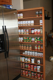

Do you mean like this? I found it on Pinterest. It has a back but could have dowels on both sides as you described.
I envision doing one of these. I will use one drawer slide on a matching wood L bracket at the top attached to the wall to keep it travelling straight, stable, and a decent pair of fixed casters at the bottom, and another drawer slide on a cleat near the casters, on the bottom.
See http://learning-to-b-me.blogspot.com/20 ... orial.html

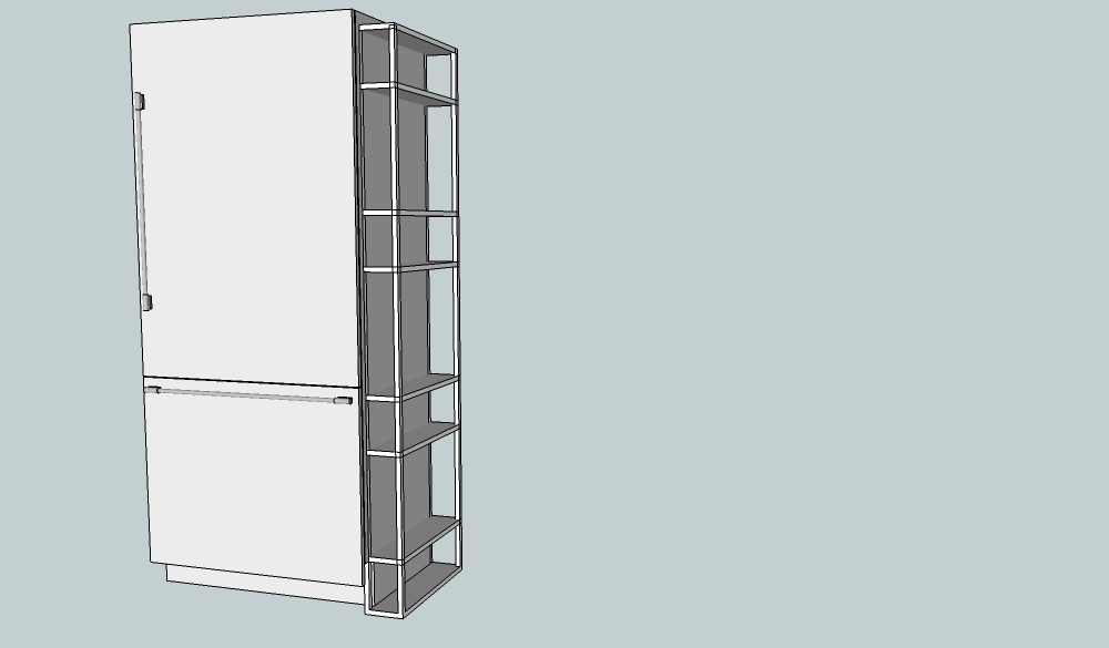

benush26
Posts: 1104
Location: Montana
Re: Getting ready for 1st project
Post by benush26 »
Something like this could be made with 3/4 stock ripped to make the uprights and plywood shelves attached a variety of ways and as said before, dowels at the appropriate spots (though omitted in this sketch). You could drill the holes for the dowels by stacking the uprights together so they would all be at the same position.
Be well,
Ben

benush26 wrote:Something like this could be made with 3/4 stock ripped to make the uprights and plywood shelves attached a variety of ways and as said before, dowels at the appropriate spots (though omitted in this sketch). You could drill the holes for the dowels by stacking the uprights together so they would all be at the same position.
Be well,
Ben
Yes Ben that is what I'm talking about. Thank you for looking that up for me and also doing a sketch ,,, that's really cool !!
