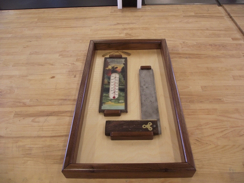

Well, if they are for a keep sake display then they should not be changed from the way the original person made them. They are small bowls right? Then make a shadow box to mount them in with a brass plate to remember the maker. Born date, died date, etc.
This is what I did for my uncle when he died in 2003 at the age of 92. My grandfather and my uncle bought the H. F Ball planing mill in Berlin, PA around 1950. I used to spend the summers there. My grandfather took me to work every day when I was there as a kid. I used to play in the pile of chips from the 36" planer when we planed rough lumber from the farmers that brought them in. No dust collection in 1955. He made me a wood tool box and filled it with tools. One of those tools was a square with a brass and rosewood arm. It is stamped H F Ball on the brass and on the Rosewood.
I found an original advertising thermometer for the H F Ball planing Mill. The phone number on the thermometer is 4-J. It must be turn of the 20th century.
I made a shadow box with the square and the thermometer and it now hangs in the Berlin Lumber Co.
I think it is just another way to go.
- Jack Brant.jpg (282.52 KiB) Viewed 8841 times
