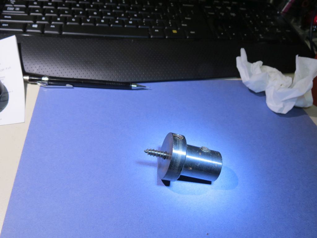

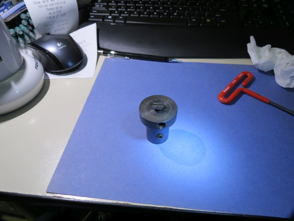

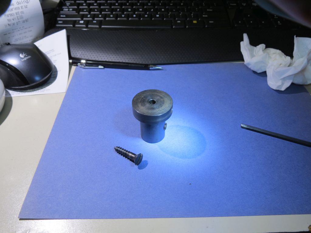

This is the shopsmith screw center I got way back when(1976ish). It came with the wood screw pictured. I think it is either a #12 or #14 but I did not check to make sure.
I store mine with the screw inserted and the set screw tighten lightly to hold it in place.
Yes you will need a pilot hole and remember this is basically a face plate so it is used primarily for smaller face plate work. The screw can be turned in with a screw driver of the correct size until it is tight then the setscrew can be used to lock it. You might want to give it a little extra turn once it is mount and before you turn on the lathe to make sure it is snug.
You might be able to lock the screw in place and then thread it in but I personally don't trust that as much as using a screw driver. I find it easier to make sure the screw is going in straight that way but so long as you have the pilot hole is should work either way.
As always use the dead/live center if you can to stabilize things when starting out and then if you have to take it away when things are balanced so you do the face. It should also be obvious but this should not be used in reverse.
