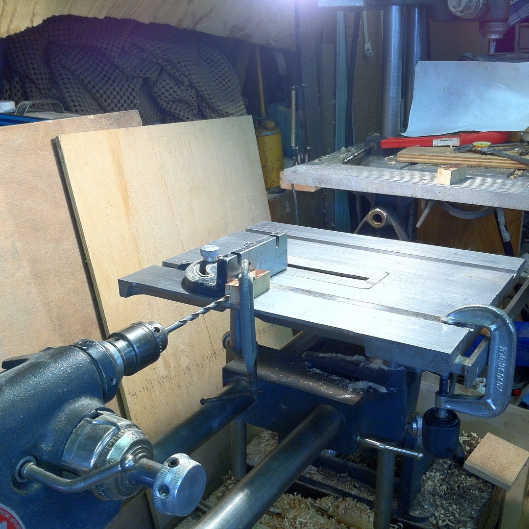

This is the way I drill my pen blanks, eventually I will make a jig but this works for now. :)
- Confirm that table and miter gauge are parallel to the drill bit,
- Adjust table and miter gauge so that the drill bit is centered in the end of the blank.
- Lock carriage, table height, and headstock.
drill setup.JPG (330.3 KiB) Viewed 21142 times
- Mark the top of the blanks and keep the same side up through all steps.
-Clamp miter gauge and blank to the table (blank against the miter gauge)
Drill the blanks

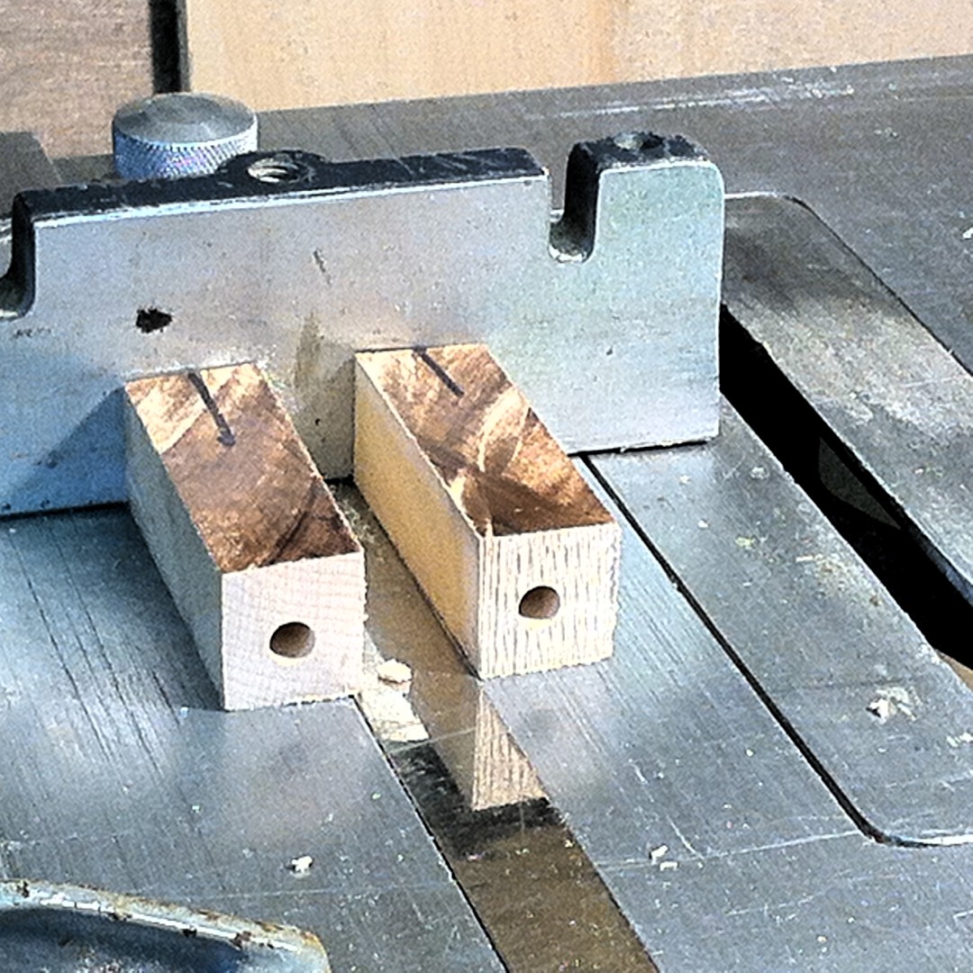

blanks entrance.JPG (320.58 KiB) Viewed 21142 times

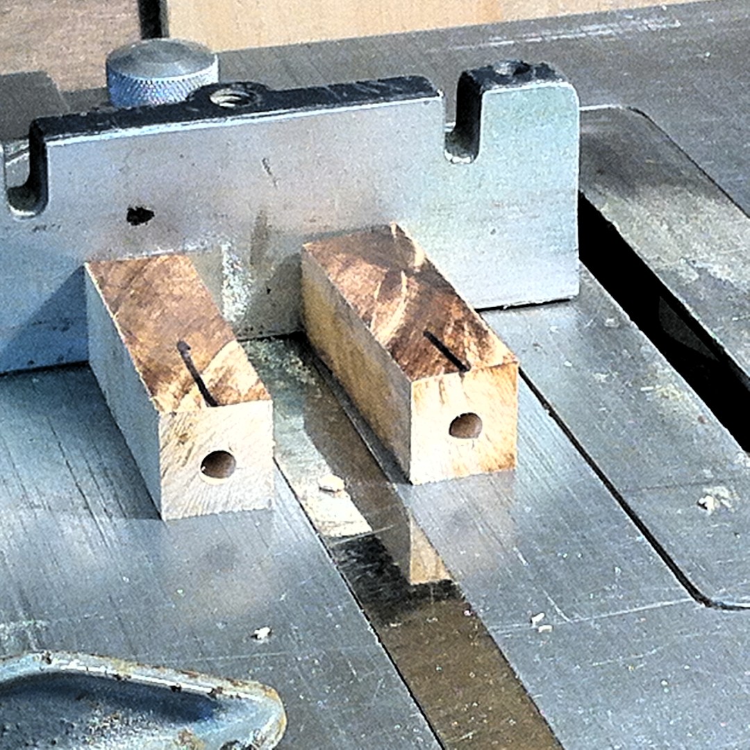

blanks exit.JPG (313.19 KiB) Viewed 21142 times

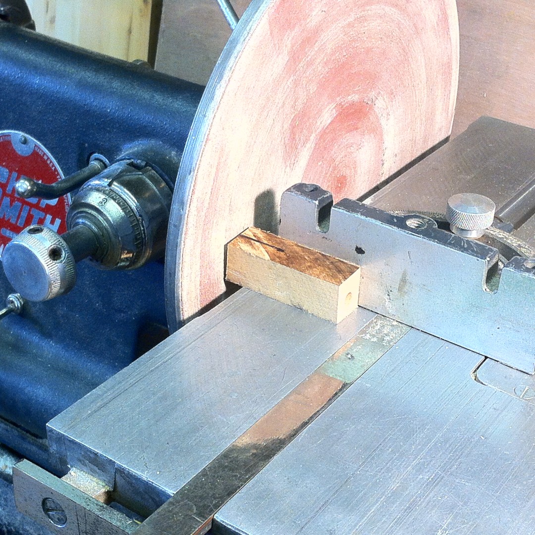

- Glue in the tubes.
- Remove the drill chuck and mount disk sander.
- Sand (trim) the blanks to length.
square ends.JPG (377.11 KiB) Viewed 21142 times

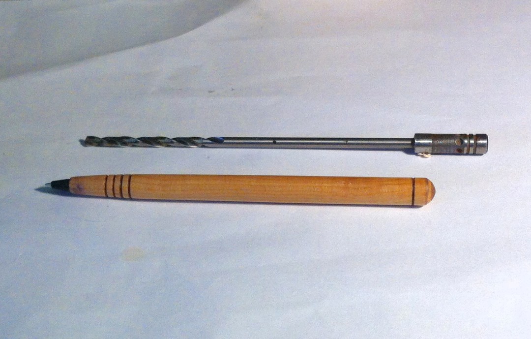

When I did mine I used a #20 (.160) aviation bit that I picked up used somewhere.
bit and pen.JPG (146.11 KiB) Viewed 21013 times
It is just the right length but slightly too large in diameter.
When I finished the pen I added a bit of CA glue at the tip. It filled the gap and holds the refill securely but it did not stick to the nib so I can still remove the refill when it needs replacing.
Even if the bit drifts off center, when you turn it, using the bit as a mandrel, the hole should be centered in the pen.
