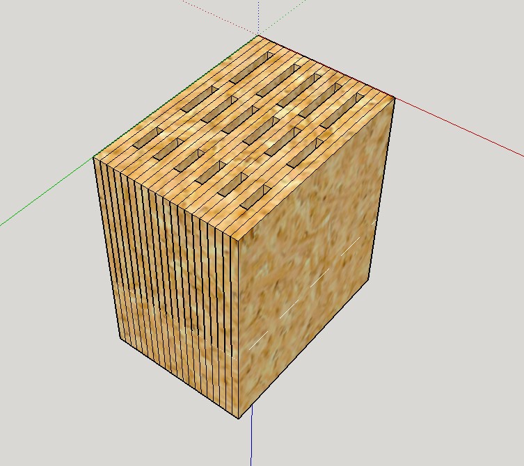

A whole knife block would not take much wood so I think you would be better off picking what wood you want and make it out of a solid block of that wood. If you wanted to make life easier cutting the wood into thin strips and gluing up to get the knife spaces would be pretty easy and then if you want special wood on the outer most sides it would not be a problem. Sort of like this:
ScreenHunter_140 Mar. 24 14.24.jpg (100.14 KiB) Viewed 8891 times
Anyway just a thought I had after reading your post.
Re: Veneer Solid Wood
Posted: Thu Mar 24, 2016 3:50 pm
by jsburger
I made one a few years using exactly that technique. There are four rows of knives so I took five pieces. The knife slots were cut in one side of each piece on the router table. The piece on the back was added later when I bought a matching bread knife. It is made from solid hard maple.
