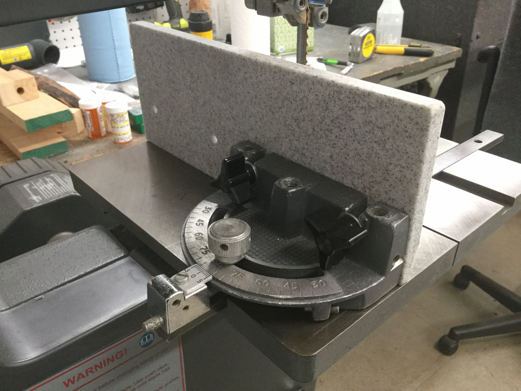

I made one from a scrap piece of Corian. It works great as a fence for the cast-iron bandsaw table. Only dropped once! :rolleyes:
