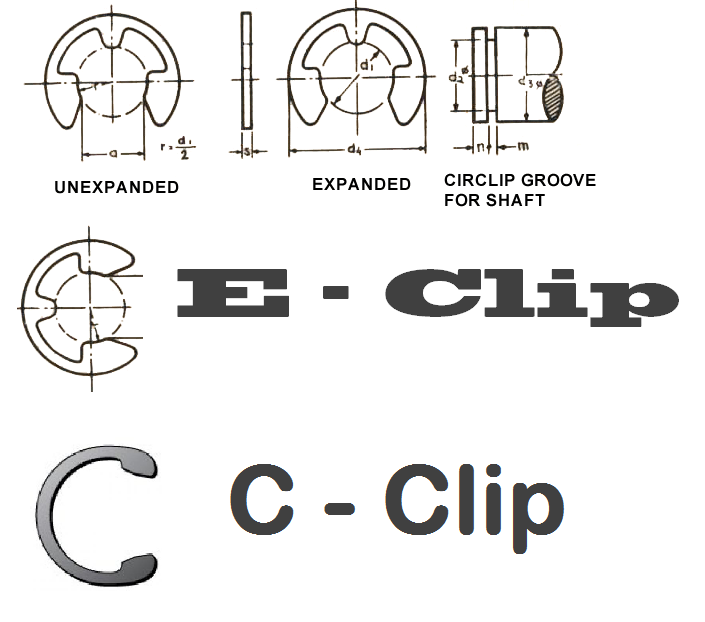

My uncle taught me to call them Jesus Clips, because he often said "Jesus! Where did that go?" when they popped off, and likely only God could find them afterwards he said. He taught me to place a shop rag partially around them when removing them to catch them when they let go.
There are two types of clips of this design; an E and a C
Everett

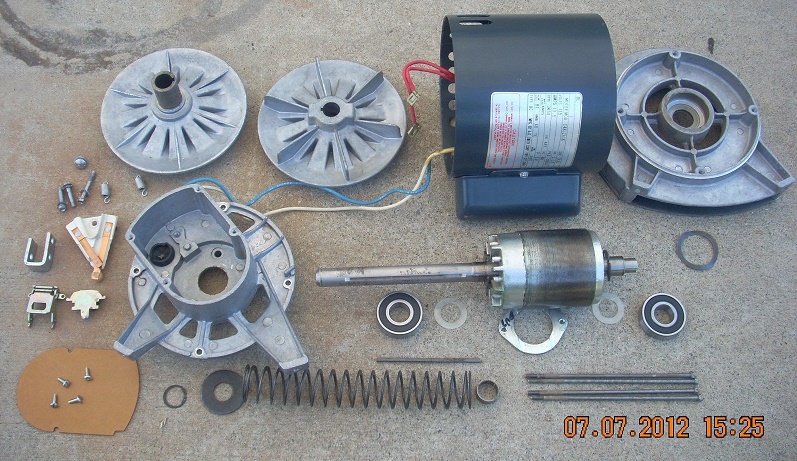

I attached a picture of an A.O. Smith motor I snagged from -simone- an eBay'er who rebuilds Shopsmith Motors.
I also recall a recent post from a fellow who had broken the centrifugal switch and found that part from a pool repair guy was perfect replacement that is still made today. Makes sense. A.O. Smith made motors for pools back in the day too.
Identify the part in the photo if you can. If it was an E-clip from what I see in the photo; is it the one still on the shaft? I would bet simone would have sources for all the parts of this nature and could point you in the right direction, but E-Clips are a local hardware store item frequently.

Sorry I had the wrong style of retainer in mind. If you are talking about the clip just to the right of the brown cover plate and screws it should be available at any well stocked hardware store but that one is the spring retainer. I would still like to see a pic of the broken one

In Everetts picture, the clip I bent is the ones that are on the shaft at each end of the armature?? Not sure that's what it's called.
My Son is going to get a clip for one of his suppliers. I'm assuming an 'E' clip will work as has been suggested.
