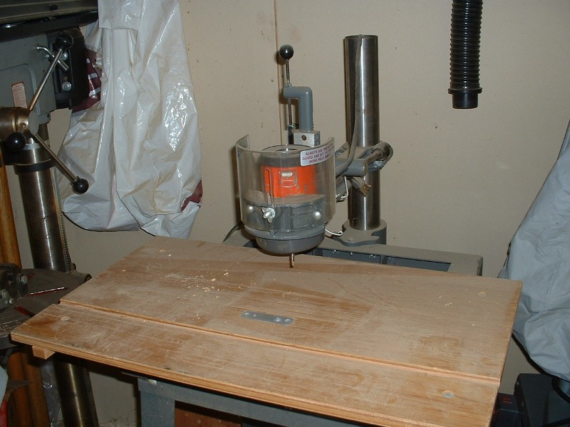

Attached is the only picture I have of my unit. I don't pick it up until next Thursday. Let me know what you think.

Take a look at Barb's picture. You'll see that you do have the bracket to attach the column to the base. What you don't have is the rectangular base that the table and column attach to.

Barb,
There were two table types on the old OPR. What you are getting is the original design. Looks like it is missing the fence or maybe just not installed when the picture was taken. The newer table is laminate covered MDF and much more versatile. The plywood table is mounted such that it will slide front to back to provide adjustable set up. Regardless, looks like you got a good one. Check your PM. I sent you a message.

I have just viewed the photos referenced in sswoodworker48's post. Looking at these, it appears that this system is designed to function as either a pin router or as an under table router. I also came to the conclusion looking at the pictures posted by mtobey.
Is this a correct conclusion.

Rick,
That is not a picture of my unit. I used it to explain what I have and do not have. I only have the arm and post and do NOT have the bracket at the bottom of the post. Sorry if the picture was mis-leading. My call for help is still there. Thanks.

You're correct. The newer design table included a table insert to which a router can be mounted so that under table routing can be done also. There are inserts, as Ed shows in picture DSCF1537, that are used for pin routing. The insert for under table routing can be seen in DSCF1530. I haven't had a chance to use mine much yet but did do one quick overarm job. Great system. The SS mounted one does have the advantage of being able to do horizontal routing, though.
Joe,
Sorry, you're right.... You did say that was not your's in the picture. Good luck finding the bracket. Anything you might fabricate would need to be somewhat beefy and solid to hold the column steady and true.
