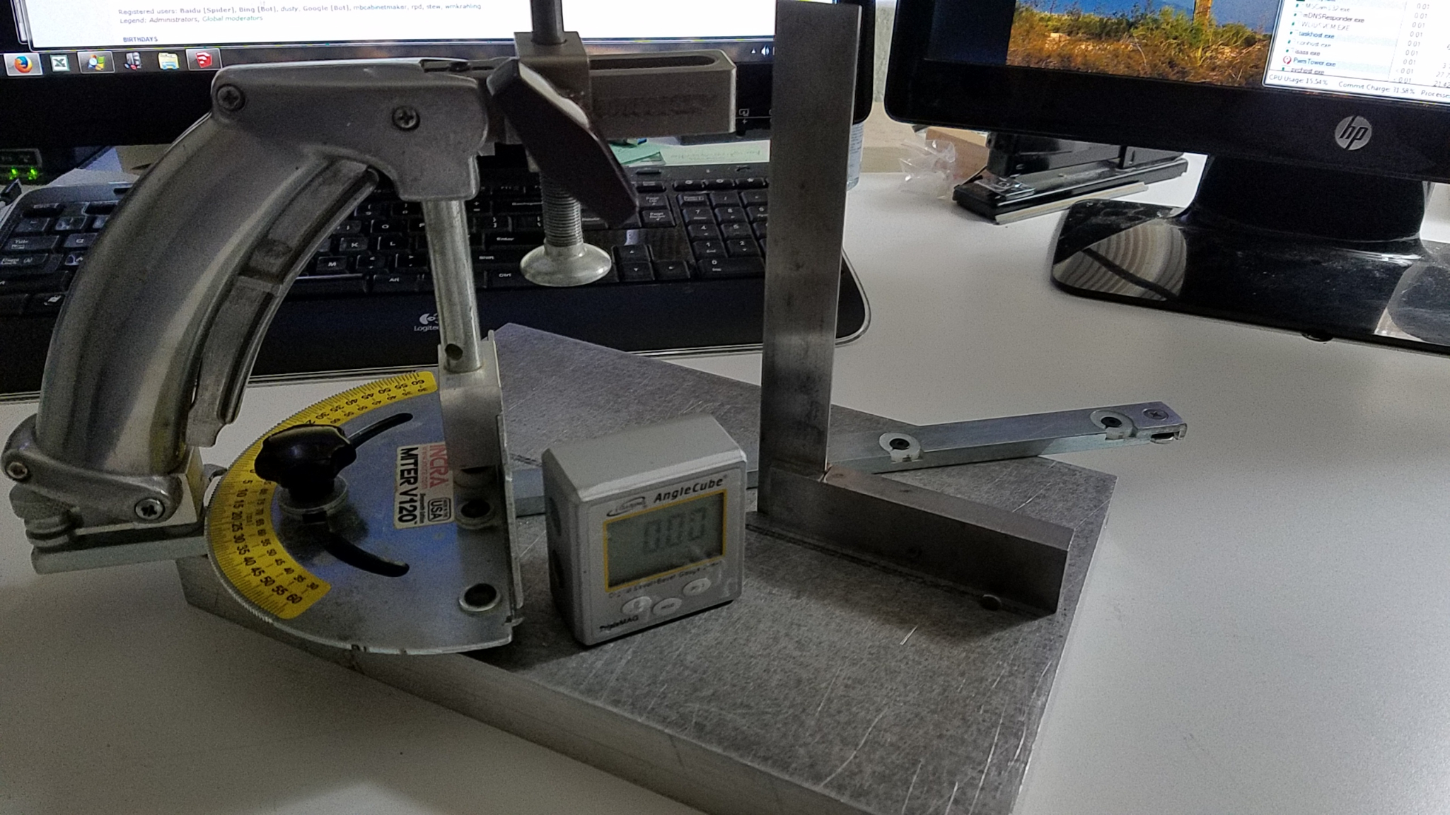

OKAY, Mark. I'm going to attempt to not let you off of the hook quite that easily. As a professional wood worker, what do you consider to be your "most accurate" means of determining a "perfect 90°" cut?

dusty wrote:OKAY, Mark. I'm going to attempt to not let you off of the hook quite that easily. As a professional wood worker, what do you consider to be your "most accurate" means of determining a "perfect 90°" cut?
I have the old shopsmith square that works pretty well and I also use the 2 cuts with a straight edge that Gene mentions. My best method however is how accurately the pieces go together. For example if my doors aren't coming out square it is most often that the miter gauge used for rail cuts is out a bit but it can be that the wood is just not straight or the cutter is dull. No matter how perfect your equipment IS the wood never is. I'm pretty anal with equipment setting and recently spent 2 hours re calibrating my sliding saw table after moving it about 3 feet. You may notice marked lines on the floor in some of my post. That's so I can return a tool to its exact location if I need to move it. One thing is for sure though the more accurate your equipment the better the outcome and the safer it is to operate.

I am highly dependent upon that Engineer's Square from Shopsmith (730343A).
