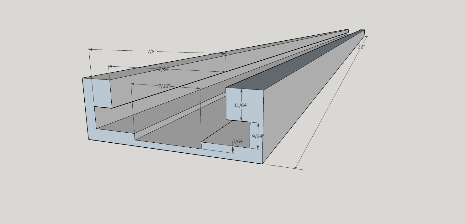

by dusty
Yes, 47/64".
Miter Track, The Anatomy of a.png (31.04 KiB) Viewed 19880 times
Now this is NOT the dimensions of the aluminum insert that Shopsmith offers. It is very close but slightly different. This is just the profile of the track in a Main Table.
