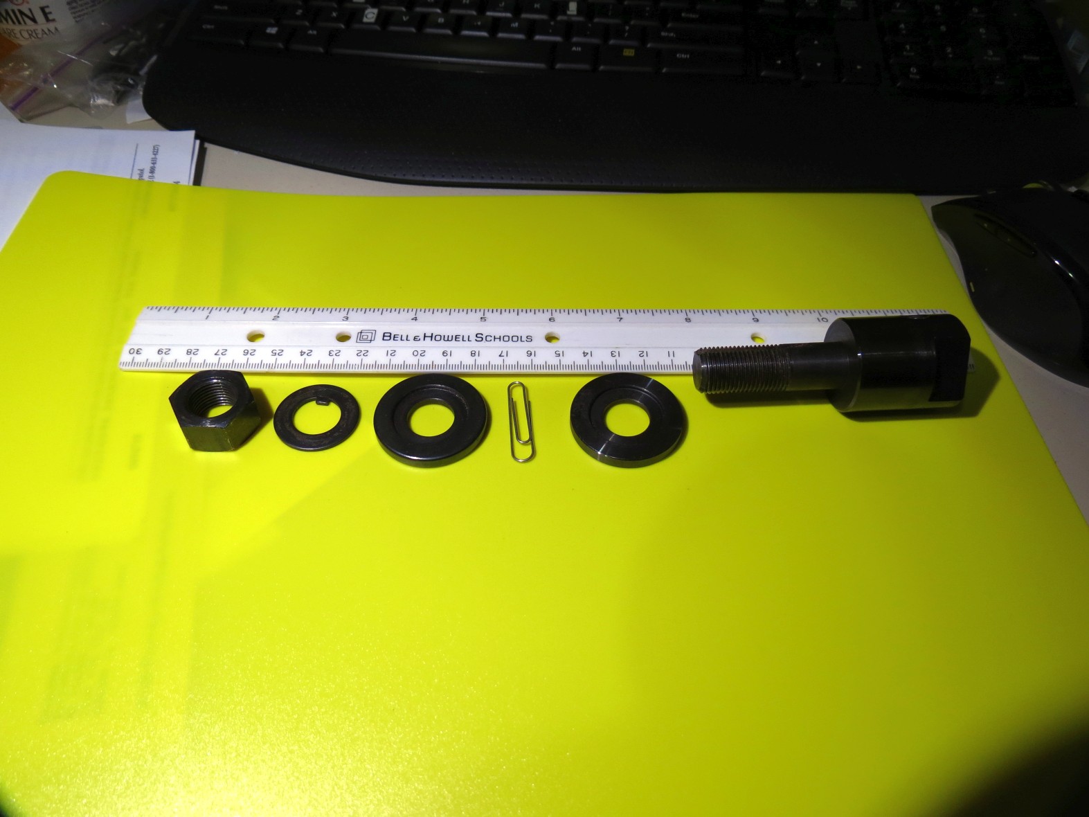

The arbor will allow more then 3/4" when set up like this:
Note the large spacer is not needed or used in this case.
The arrangement from left to right is the nut, the keyed washer(you MUST have this in place), one of the thinner washers with the indented part facing the blade, the blade is where the paper clip is. The other thin washer also has to have the indent facing the blade. The arbor should fit just about any stacked set up to 15/16" if I remember right.

reible wrote:The arbor will allow more then 3/4" when set up like this:
^^ Very helpful! Thank you!
