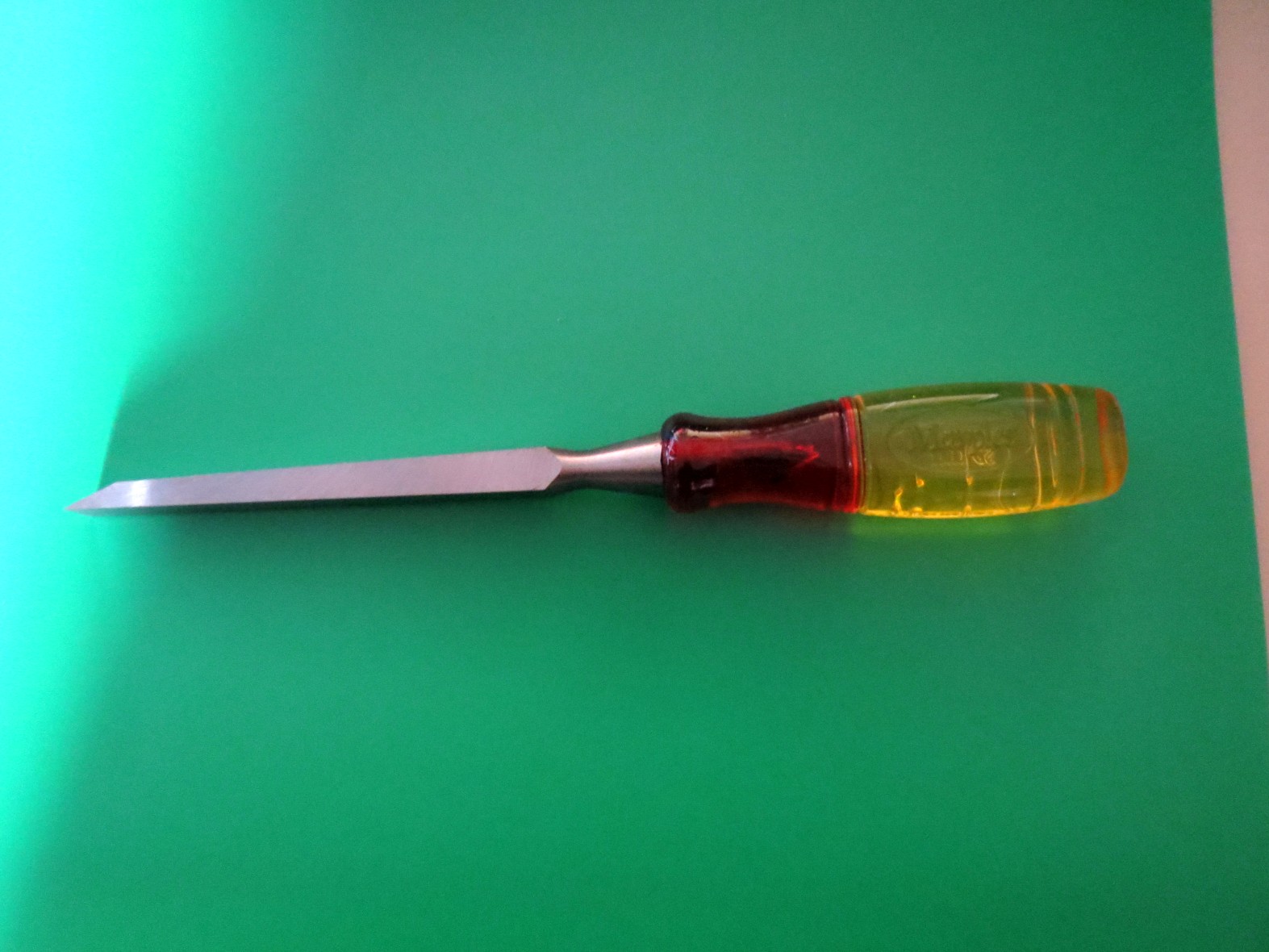

This tool came with my Shopsmith.
It doesn't look to me like a lathe chisel.
Is it a mortising chisel?
If so, how are they sharpened?
The handle is a bit loose. How can it be tightened?

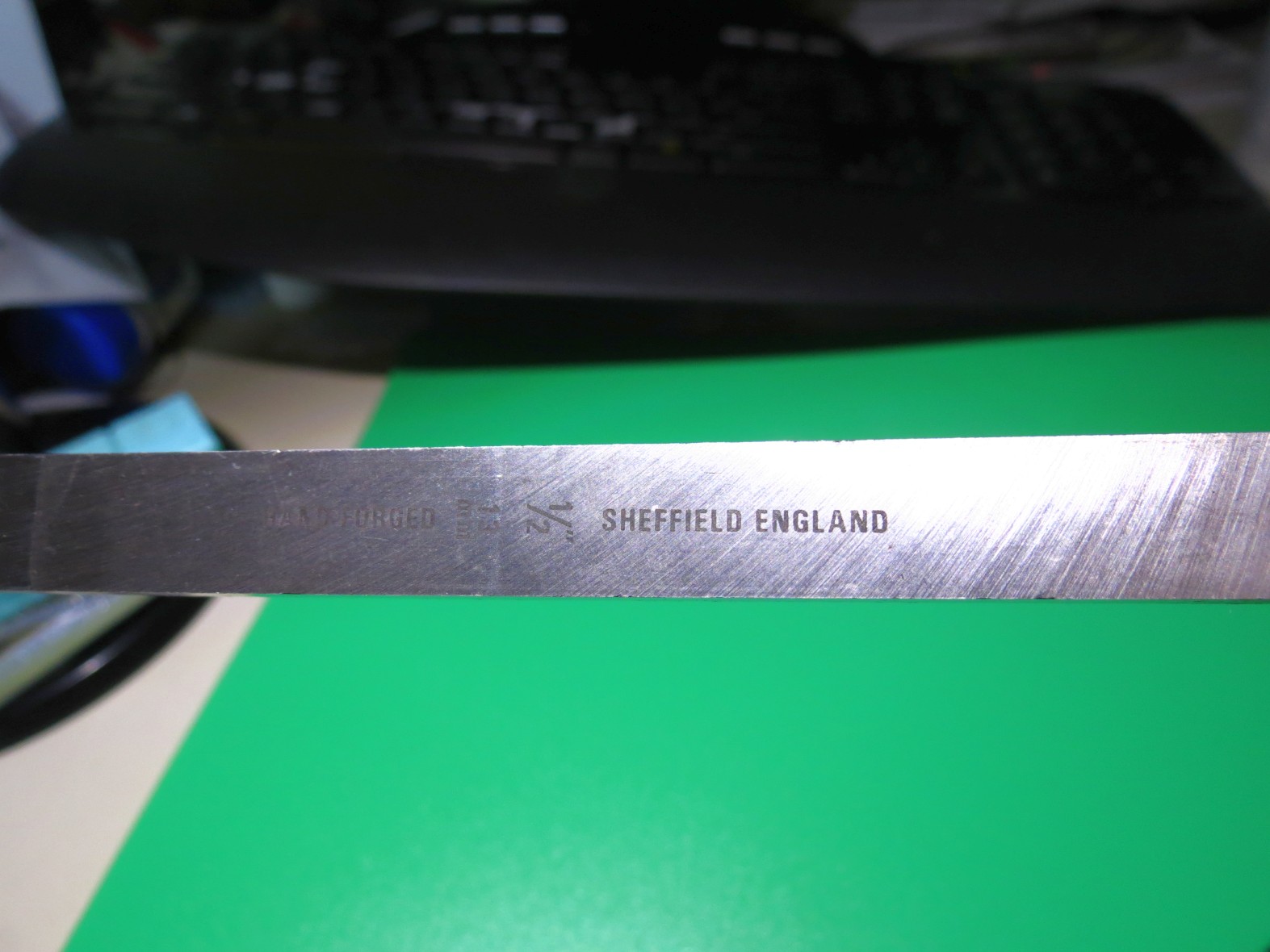

Yes that is a Marples mortising chisel. I have a more modern version with plastic handles. The width of the chisel is its size, ie 1/2" or 3/8" etc. They are often a set so check for at least 2 or 3 more of them.
The angle should be maintained and because of its thickness you will either have to hone by hand or purchase a special part for a honing tool. For the most part it is just honing needed with rare grinding needed.
Here are a couple of pictures of mine:

Thanks so much! I had wanted one for a while, so it's a nice surprise. I love old tools, too!
Thanks for the pics of yours! Sexy!

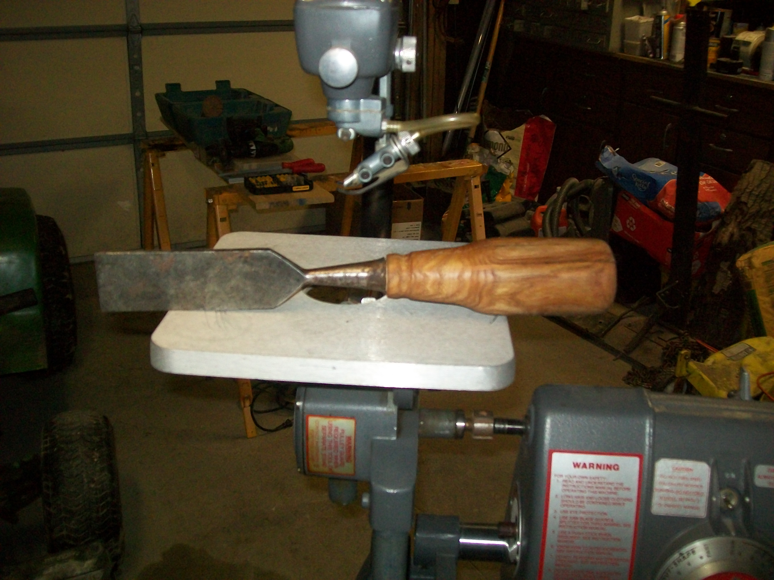

Does it come apart at the top of the handle ?
If so you might get away for a while by taking it apart and using 2 part epoxy .
Or you can make a new one
This one was passed down ,,, didn't have a handle. .
Pretty sure ,,like yours ,,,it would have been used in timber framing.

Interesting jig saw/headstock power coupling!
Re: Is this a Mortising Chisel?
Posted: Sat Feb 25, 2017 6:07 pm
by Hobbyman2
they are just bumped together , not connected .
Hobbyman2

JPG wrote:Interesting jig saw/headstock power coupling!
I don't think they are coupled. The splined hub is not installed on the head stock quill shaft and it is just close to the jig saw shaft.
You get a A for today!!

How come the hub is so far out on the shaft?
