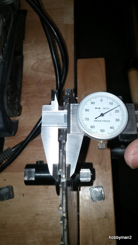

Also if you stay with the dado set you can use a set of out side calipers to set the blades and shims ,,,,,it will save you a lot of test cuts.

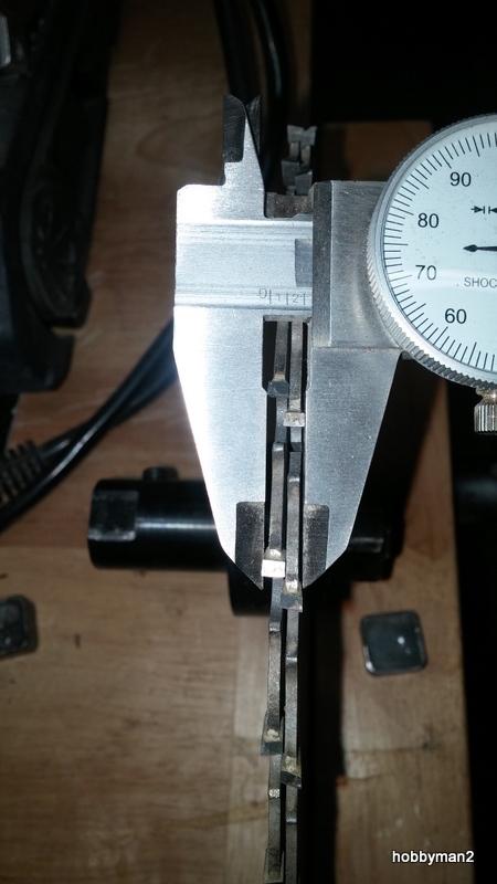

My calipers are large enough to use on the out side of the cutting tips using multiple {2 } kerfs!
I all ways check the reading going in both directions so that gives me a accurate reading.
Will also tell you if the blade tips are touching or the blade plates are warped some where because you will get 2 different readings.
I dont know any where else you would want to take the measurement to get the width of cut , If the carbide tips are 1/8 ea inch and you bury some of that inside each blade gullet ,,,, I dont see how you could have a 1/4 inch cut with out using shims?

Another thing to realize is if you look at the pictures above,, with out a shim ,,,one tooth is resting on the other saw plate ,I never liked that .
A saw tooth should never touch any thing but wood.
JMO
