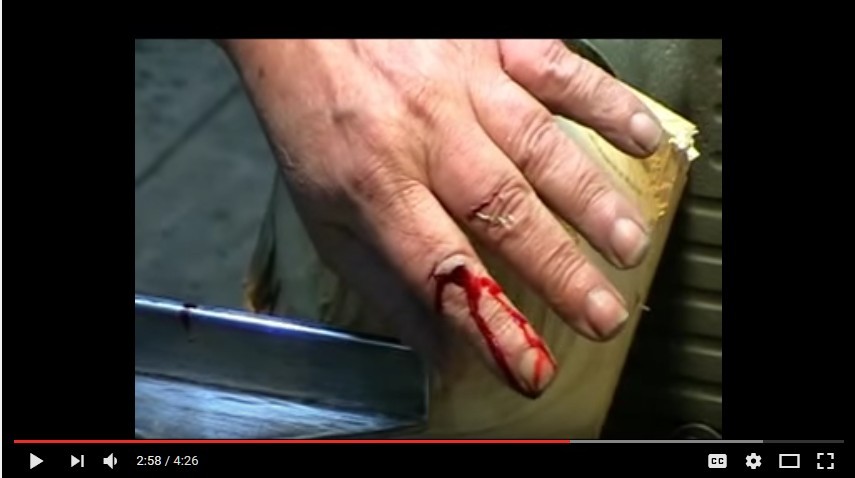

Watch this video and then decide:
https://www.youtube.com/watch?v=IOhHeyoZLaY
If you don't feel like watching the whole thing then this will give you the idea of what can happen when using a spindle gouge for bowl work.
I'll post a capture from the video but down lower with the warning that there is blood involved so don't go there if you don't want to see it.
spindle gouge for bowls not.jpg (47.8 KiB) Viewed 20153 times

Like Ed said use the right tool for the job .
Since I seem to enjoy rambling here is a true story,,
So one of the first jobs I had after high school was turning a train wheel patterns on a face plate lathe for these little trains that were being set up all over in theme parks ,,,,,,,the lathe could handle up to a 6ft dia disc, you actually had a tool rest that was attached to the bottom of the lathe and you stood ,,on,,, the lathe,,,back then there wasn't much in PPE around ,,,,common sense was a given ,,, it was up to you to wear what you thought was needed,,,, the first thing I was told was,,,, here is a face shield wear it !!
Even today when I turn any thing I cringe if I don't have one .
Safety glasses are a must but a face shield can save you from a very painful trip to the hospital.
I have seen bowels come apart and fly past your head at a speed that would take your eye out or a chunk out of your head .

Never, Never, Never use a spindle gouge for bowl turning. And do not use a roughing gouge or a spindle gouge for hollowing any bowl. Go to any website that sells lathe tools and look at the differences between the tools. A bowl gouge has thicker body material and the flutes of a bowl gouge have steeper walls to absorb the torque of hollowing. In addition a spindle gouge has a tang whereas a bowl gouge has the body of the tool going straight into the handle. This is much stronger than the tang of the spindle gouge. The design of the bowl gouge also enables you to reach further over the tool rest when hollowing. BE SAFE!!!!!!

YES... I see now my death in the future using a spindle.

It is correct that you should never use a spindle roughing gouge, also known as a roughing-out gouge, on bowls. Roughing gouges are made from a piece of flat stock rolled into a U shape and have a flat, weak tang. They are ground straight across and that shape is just asking for a catch in a bowl blank.
However, I think that some clarifications are needed re spindle gouges vs bowl gouges. Both are made from round bar stock and bowl gouges usually have a deeper flute, letting them clear chips better. Spindle gouges will be stronger than bowl gouges of the same diameter since there is more steel left. Spindle gouges can be used on bowls and bowl gouges on spindle work, however, the shape of the tool will determine its usefulness and application.
