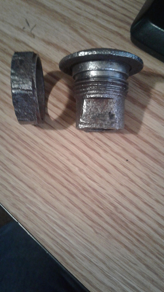

Hello I have an arbor that I think goes with my shopsmith that I got from my dad,but I dont know what to use on it, a sawblade wont go on it, can anyone help me?

We need to see a picture to be of any help.

Ok I attatch pics

Re: MarkV
That arbor has seen better days! Yes that is an arbor for a model 500 shopsmith and takes the 1-1/4" blades that shopsmith sells. I'm not sure if I would attempt to use that one......
They do sell new ones and they do sell arbors that use the more standard 5/8" hole saw blades.

Re: MarkV
Post by Hobbyman2 »
I am with Ed toss it!!
If you have a SS arbor wrench it will save you from destroying a new on.
If not it might be some thing to consider .
Good luck

justtim561
Posts: 23
Joined: Sat Sep 06, 2014 1:35 pm
Location: Bloomfield Indiana
Re: MarkV
Post by justtim561 »
Thank you very much for the input, so yeah I will try and get one of the newer arbors. thanks again.

Re: MarkV
Should have seen this thing before I cleaned it up! it was covered in rust and the nut was frozen to it, I had to take a benzal and heat it up to break it loose!!

Re: MarkV
Post by Hobbyman2 »
I found out recently that there are 2 different blade arbors ,I have had my SS fro 6 or 7 years ,,, one for the MKV 500 and one for the newer tables with dust groves , be sure to order the right one if you get it from EBAY .
