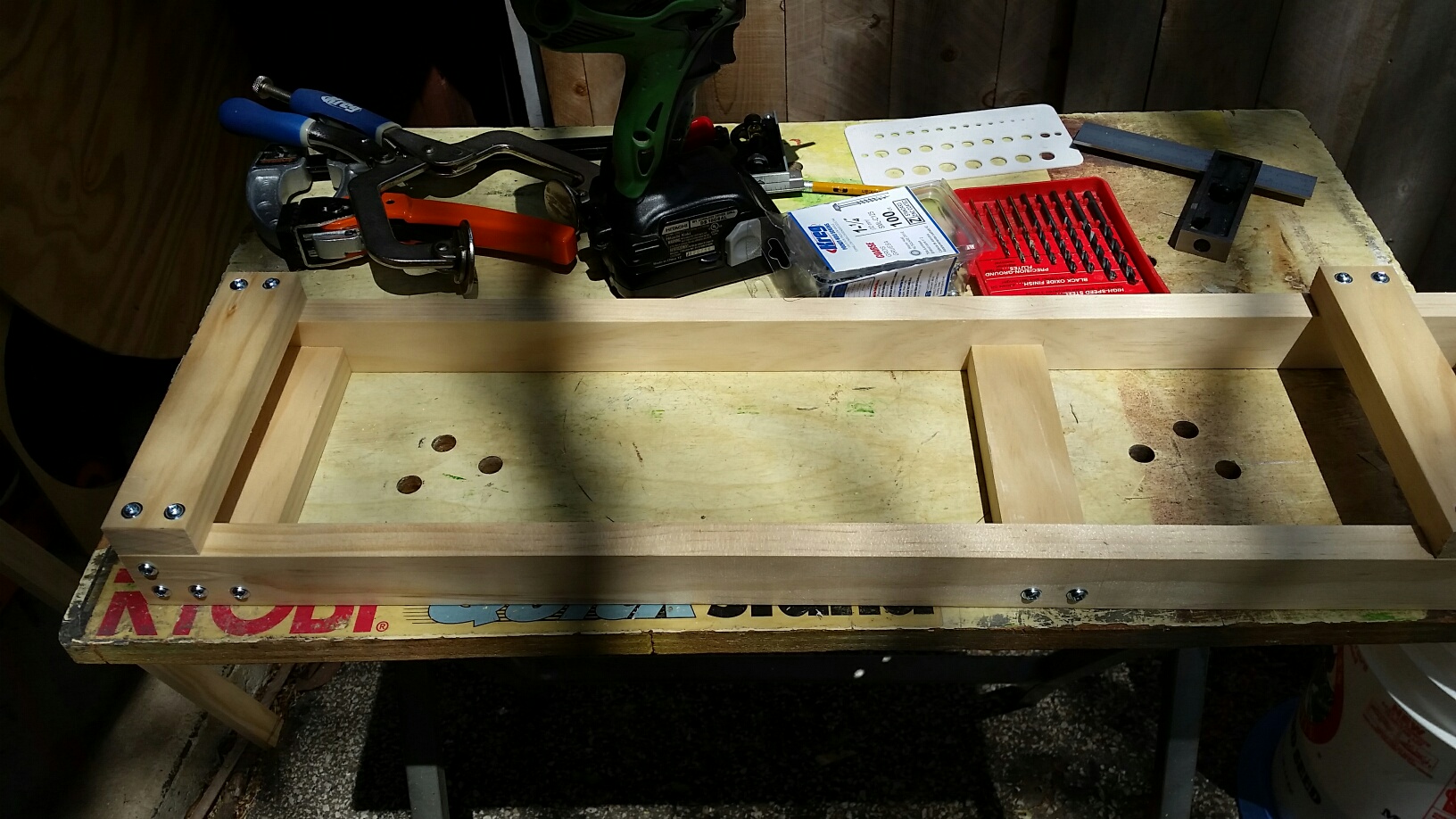

So thus the need for a simple rack. I used sketch-up to do a drawing not that I needed to but with an ailing back it was as close to wood working as I could get at the time.
Today day is good weather wise and my back is up for some limited action so this seem to be a good project. It is made out of pine and I did the cuts on the miter saw. It is put together with screws since I had not had the opportunity to see how it works in real life glue would/could be a mistake not worth making.
As it turns out it does work but a little tight when sliding the rails in and out. I think a simple plane will fix that as it is just slightly tight.

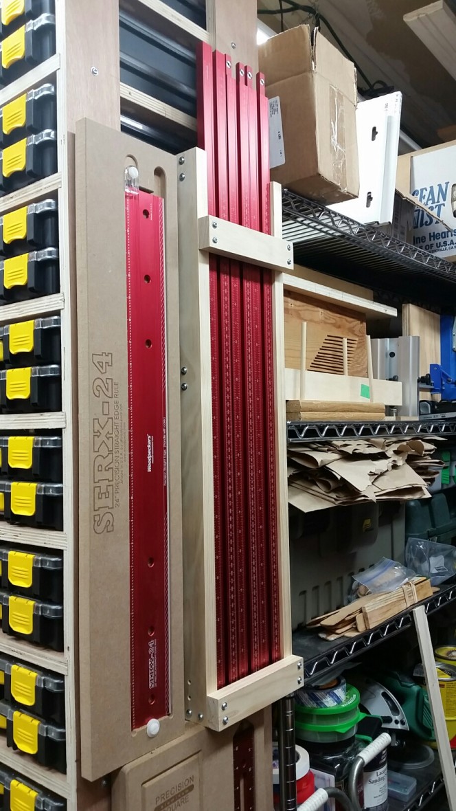

Here is a photo of it assembled outside:

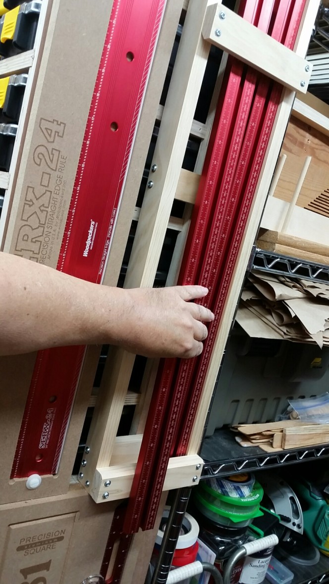

Here it is hanging:
For bonus point see if you can spot the omission in this last picture.
So out to take it back down and fix the omission and a little planing and I'll be back for a photo of how it works......

reible wrote: For bonus point see if you can spot the omission in this last picture.
Where are the plastic fingers or whatever they're called that go on the sticks? Looks like you're missing the back piece at the bottom.

The "tabs" and "arms" are in a box for safe keeping but I have though about adding a piece of t-track to the rack to hold them. Will have to see if that is worth the effort.
So I'm back and the track is remounted. The two missing screws are now in place and all is well.

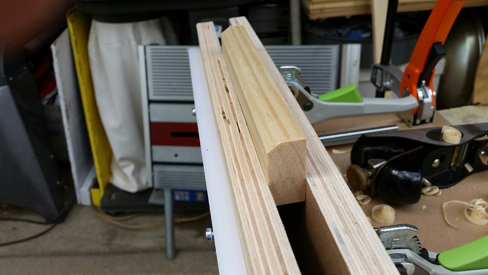

I got to use my parf vice today. Found out one of the screws was too short on the front plastic piece, I was worried about that and sure enough in usage it pulled out. New longer screws are now in place. I also found the plywood I used is a bit to flexible for my liking. Will add a piece of hardwood to the top at some point to see if that is better.
The parf vice is real use:
This is the basic operation, just taking the corner off on two parts. That was all it needed and now works as I hoped. The idea is to slide the track up from the bottom and then let it set in the little tray in the bottom. You could just pull it out the top but it is mounted pretty high so it will be better to use the sliding up trick.

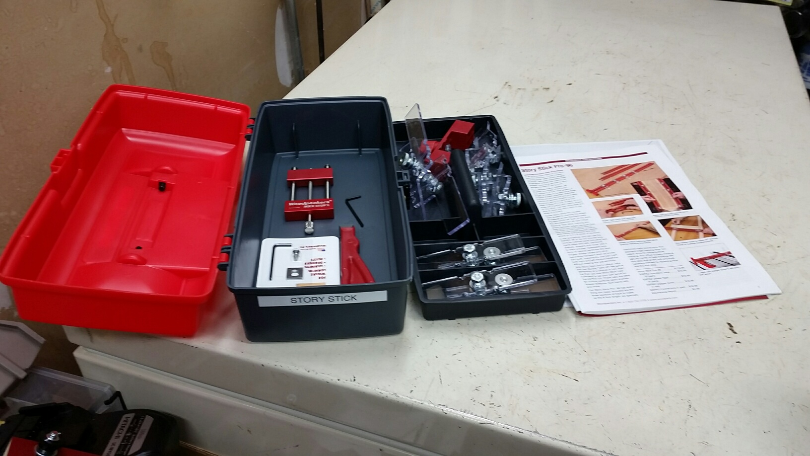

Box with the rest of the parts:
