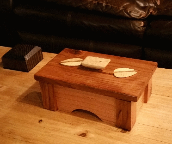

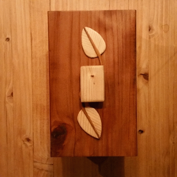

Make your "first" set from Fir for the white and Redwood for the dark. For me, they are truly beautiful woods and inexpensive.
Here is an example of the two together:
Box top view.jpg (268.43 KiB) Viewed 20205 times
Just a humble suggestion. I know a lot of the "hot shots" here will cringe LOL, but I like the contrast and they are relatively easy to work.
