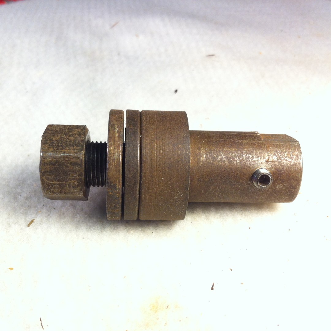

The picture shows 3 10ER arbors and one current Molder/Dado arbor. The two on the left are 10ER but are missing one thin washer I think. I don't know if they were ever sold with just one thin washer. The accessory catalog I have shows two thin washers but it is from 1953 which was the end of the 10ER production. The one on the bottom right is a 10ER with the two washers. The one on the top right is a current SS Molder/Dado arbor.

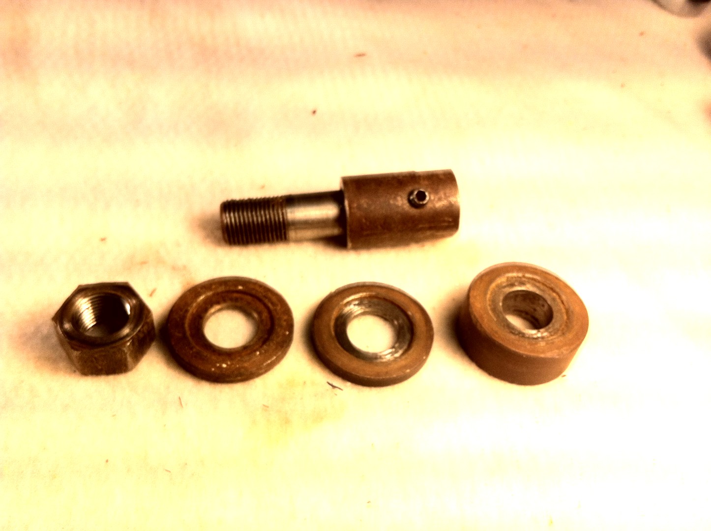

The 10er's came with a universal 5/8" arbor like this.

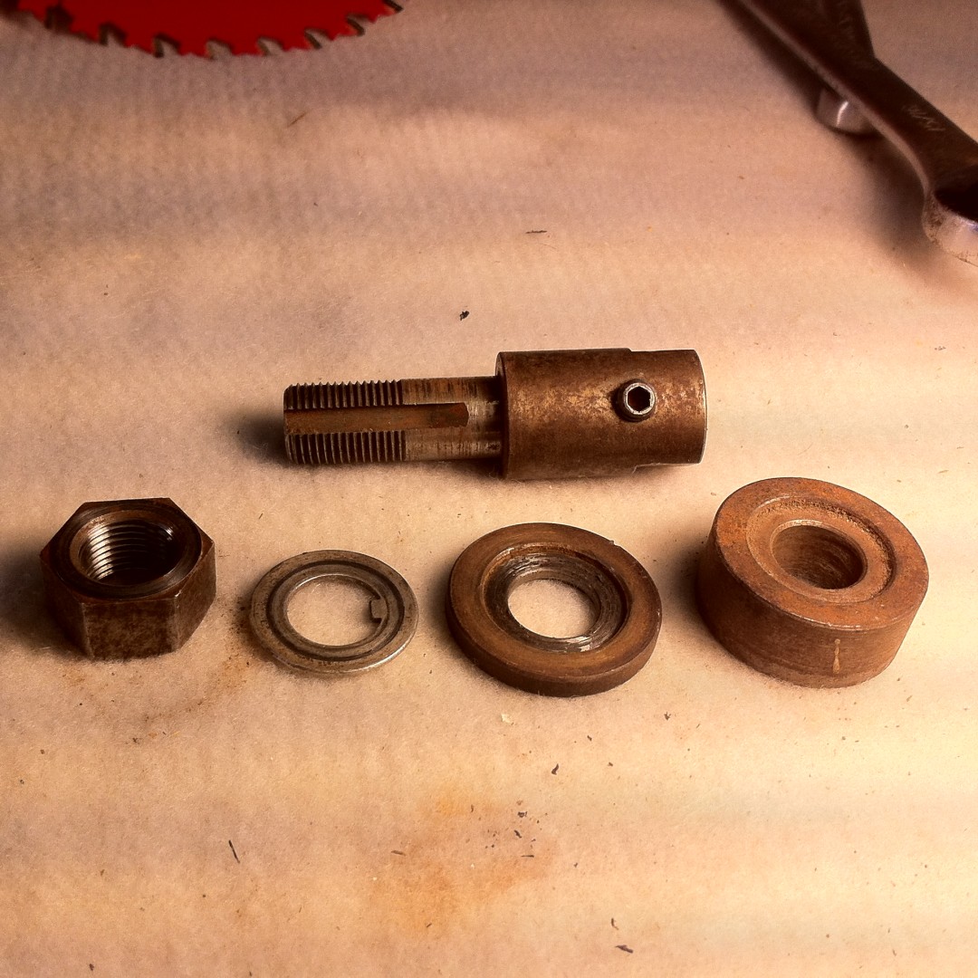

and disassembled

They came with one thick and two thin washers, for saw blades one thick and one thin would be used, for thicker things like a dado stack the two thin washers would be used. As only two of the washers were used a time by the time you get it there will probably only be two, one thick and one thin.
Note the washers have a recess on one side, that side goes against the blade.

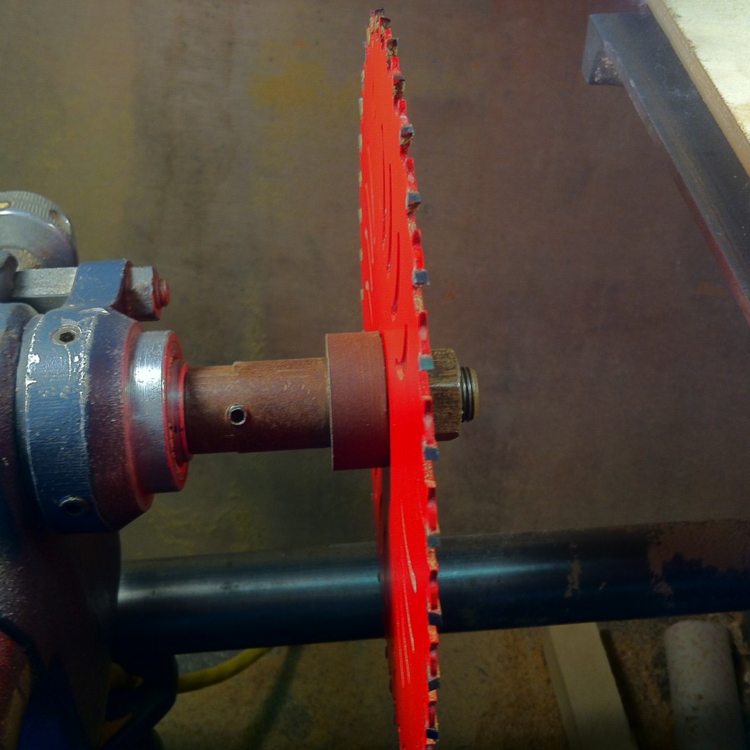

With blade mounted and on the spindle.
When Mark 5 was introduced the arbor was changed slightly, a key slot was added to the shaft and a thin washer with a key was added, also a larger set screw was used (all Mark 5/V set screws use the same size Alan key, 10er's have four different sizes.)

After getting the arbor, make sure you use an 8" blade to avoid any surprises. An 8 1/4" blade is a touch too big. You can use it, but won't be able to fully lower the table without the blade hitting the table insert.

ChrisNeilan wrote:After getting the arbor, make sure you use an 8" blade to avoid any surprises. An 8 1/4" blade is a touch too big. You can use it, but won't be able to fully lower the table without the blade hitting the table insert.
I haven't had that problem, but then I have a Mark 5 lower blade guard installed when using the saw function. I guess it prevents the table from going down all the way.
