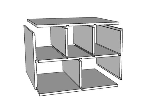

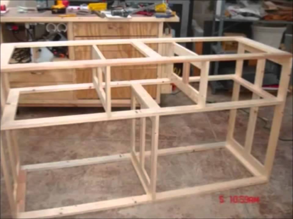

OK, another newbie question. Why the construction technique difference between a chest of drawers and a kitchen cabinet. The chest of drawers seems always to be made with an internal structural frame whereas a cabinet seemingly is made from panels and panel joinery.
Cabinet carcass:

Chest of drawers carcass:
chest of drawer frame.jpg (50.79 KiB) Viewed 21890 times
It seems to me that either could be made either way, why the difference?
Thanks in advance guys!

While I am not a pro by far, I would guess that plywood carcass construction would work well for either application. However, I can not imagine a quality piece of fine heirloom quality furniture being made of plywood.
Typically plywood is a cost saving measure or a necessary evil for stability in encased designs. However in an heirloom quality piece I would use solid hardwood without fasteners (joinery and glue) to have a near immortal piece, since the first thing to go on antiques are the fasteners if the piece is well taken care of. When I sold furniture, the comparison between plywood panels in construction greatly devalued the piece.
Outside of that, I imagine a frame structure proved more support for the drawers to prevent bowing of the panel based carcass. The hardwood frame also would wear better in the long run.
However this is all my guess and I suspect both will work, the above are my guesses.

My take: carcass construction is ancient, but it was flawed. As woodworkers saw how much wide pieces of wood moved, thus ruining their furniture, over the centuries they developed frame-and-panel construction.
As modern materials were developed (e.g. plywood, mdf, etc.), which didn't move as much a natural wood, they could go back to carcass construction, which was particularly advantageous in high-volume factory situations.

OK, so I am taking it to mean the internal frame is stronger compared to a ply panel cabinet (which I kind of figured it would be the reason) and more suited to multiple moves like furniture would be subjected to. I remember my father in law making a portable pantry for a woman in his church in the 70's. It was lap frame construction and then beautiful solid wood raised panel ends, top, back, and doors. Weighed a ton but was a striking piece. For the life of me, I don't remember how he joined the panels to the frame, but I will figure something out.
I am wanting to make a "pantry" for my wife's kitchen that will be placed next to the refrigerator in a wasted space part of the room. Won't be huge, but I just thought a framed piece with raised panels would look good and I don't like using ply unless I have to.
Thanks guys, you confirmed my suspicions! :D

The reason for the difference in construction is that the kitchen cabinets are built to maximize storage space and they will be secured to the wall for added structural support. The chest of drawers has to be self supporting so it can be moved around. If you look at cheap furniture that is built like kitchen cabinets they don't survive too many moves before they7 collapse.

The easy answer is COST. Mostly based on labor cost. This cost also includes the use of MDF. There are numerous examples of antique furniture and cabinets that are staying square and solid.
The proper techniques of dealing with natural wood, joinery and structure require a degree of skill not held by many of today's furniture/cabinet makers.
BTW - wood movement is not a problem if understood and and that knowledge applied during construction.
