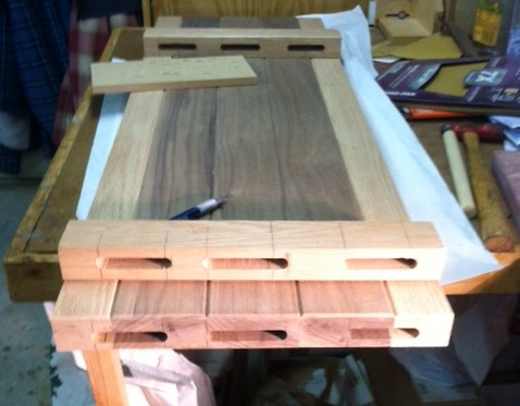

Yes! By all means you can and should use the horizontal boring set up to make these mortises.
I have done this often. In fact it is my favorite method to make end mortises. You don't need any new tools, other than a Shopsmith router bit chuck (either 1/4" or 1/2") and a router bit. Here's their router chuck: http://www.shopsmith.com/ownersite/cata ... shield.htm
If you want, you can use the drill chuck and the appropriate size drill bit. Using this method, drill overlapping holes to form the mortise and clean out with a sharp chisel.
If you don't already have a router chuck the second method will probably serve you best. No additional money needed, and the mortises don't have to be real pretty because they will be hidden after the hook is inserted.
Caution!! Don't try to rout using your drill chuck. It is not designed for sideways pressure.
Bench mortises.JPG (58.58 KiB) Viewed 22228 times

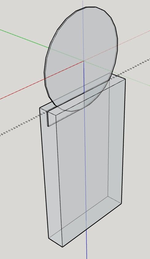

Due to the width of the slot (mortise)(kerf) being just 3/32" I think it might be better to use a circular saw to make the cut. You could do it on the shopsmith if you feel you can control the length of the bed rail being up in the air and the end being on the saw table but I know I would not feel safe doing that..... so a circular saw seems to be a possible answer.
To get the 1-1/8" depth you would set the saw depth to that. Then clamp some wide boards, maybe 2x6's to each side of the rail flush with the end where you want to cut. This would provide better support for the saw base to ride on. An edge guide to locate the cut in the board would be needed unless you feel brave and what to try and cut to a line......
Then you have to make the cut from the bottom to the top. Depending on the width of the rail the saw blade may need to come through or not. If you wish you could just make it a through cut then cut a filler to repair that.
The width of a saw blade might be 3/32" or you may have to make a second cut if need to make it wide enough. Depends on the blade.
Since the blade is circle you end up with the radius left after you get the full depth for the length you need. The sketch is an approximation of what this would look like.
