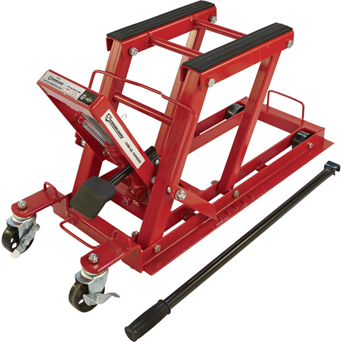

You may be able to outfit a motorcycle jack ($95) with added 8 inch pneumatic tires ($35 + some fabricaton) and lift from the bench tubes if you have a wide enough space.
Works wonders moving shopsmith's over grass and rough ground. Just center the headstock, and bungee cord it to the lift.
We fabricated some 2 x 4's with cut outs for the bench tubes we cut with a 2" hole saw.
Sit it down where you want to use it and the casters are not a issue.
Everett

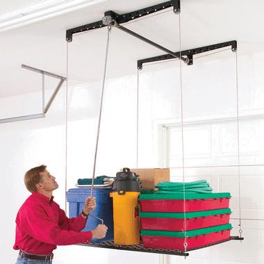

How much room do you have overhead? I installed one of the lifts below in my garage, and it's pretty slick. I use mine to store a couple of stand-up paddleboards, but the load rating is sufficient for a Shopsmith. You can crank it up or down in less than a minute with a drill -- I keep an old cordless drill hanging on a nearby wall just for that.
For a Shopsmith, I'd probably lose the wire platform in favor of a couple 2x4's clamped across the way tubes. If the budget is tight, a manual rope & pulley setup would accomplish the same thing at a fraction of the cost.
You can buy the Racor lift at Amazon, Home Depot, etc.

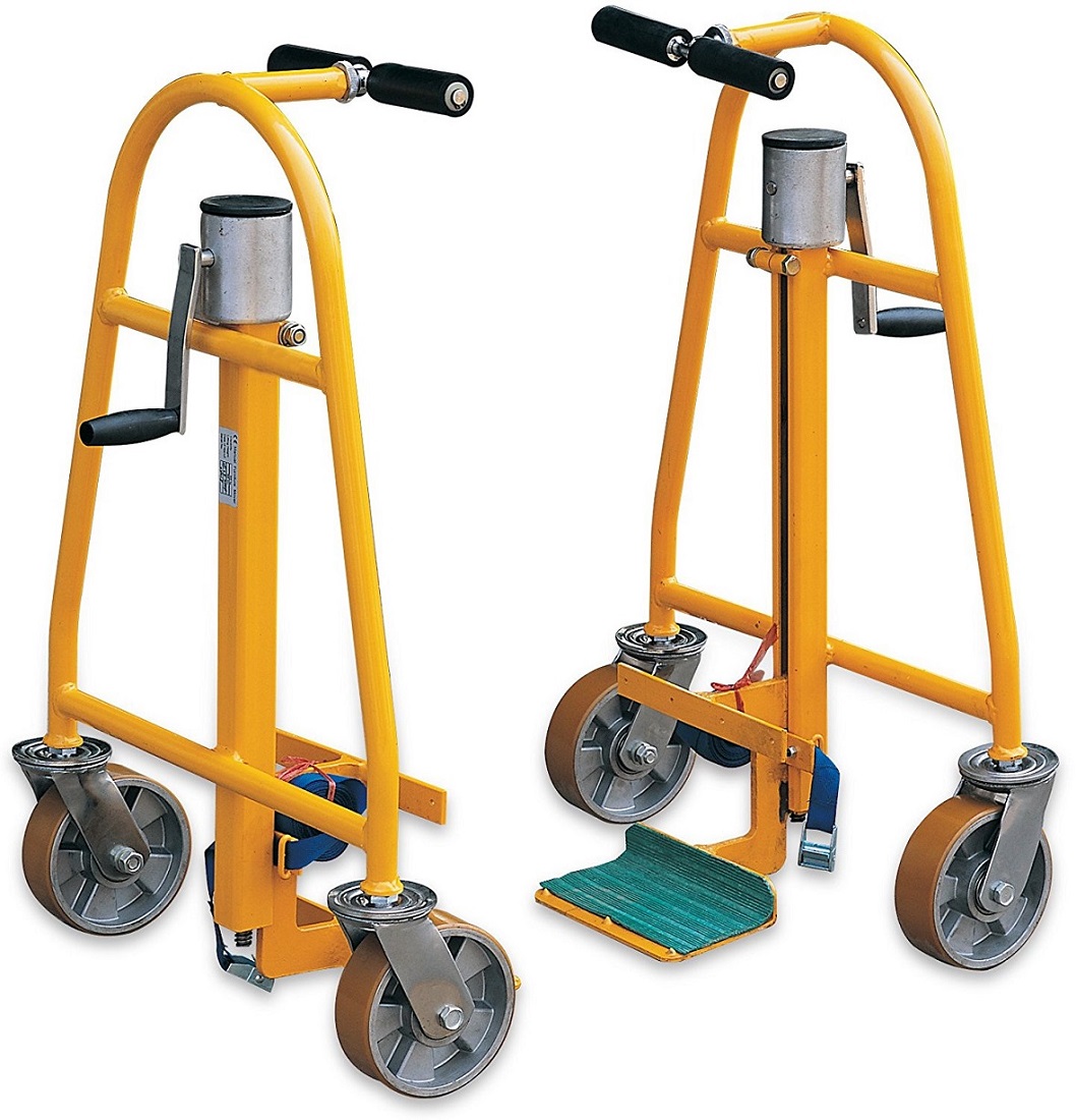

Not cheap but a FM60 Manual Furniture Mover may give you an idea.
Everett
