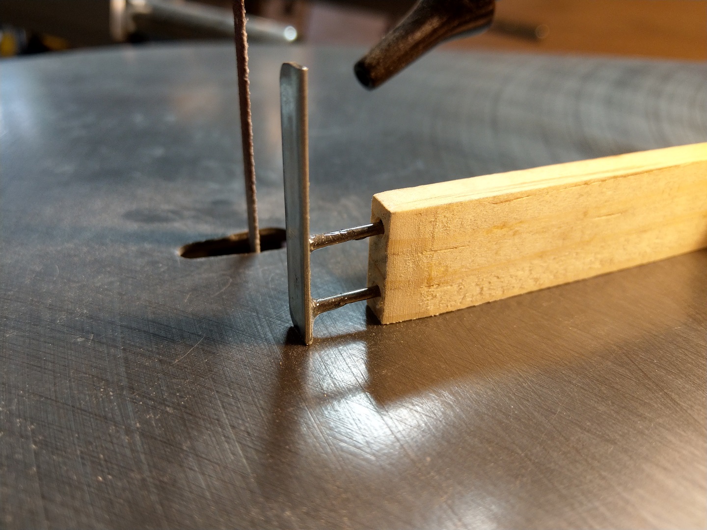

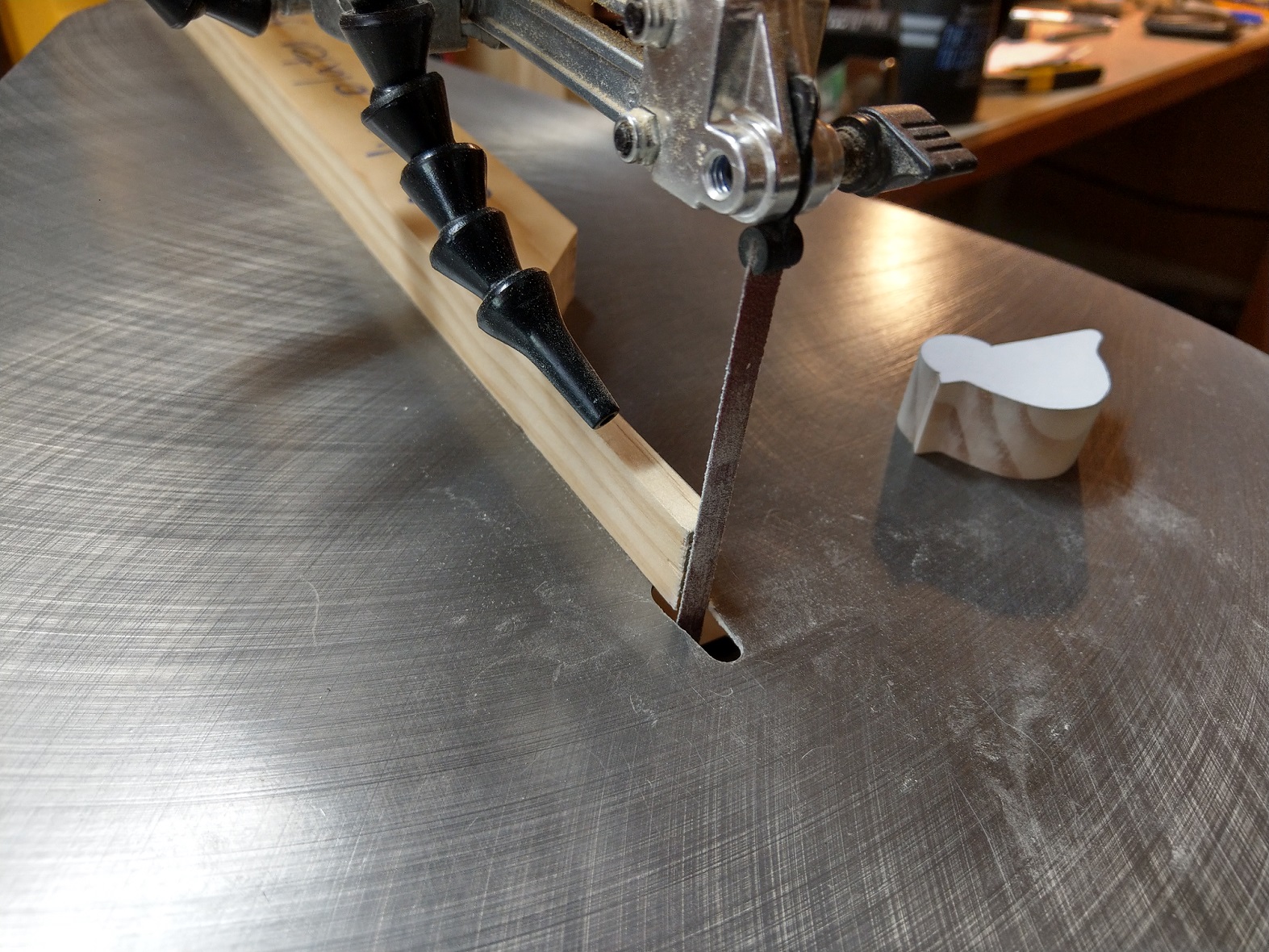

Not having a strip sander I find these come in handy for small parts. Sanding materials of a generally small thickness(<1/4") works great. When sanding pieces that are 3/4" thick I wasn't getting as good results. The belt was rounding over my edges. Increasing the tension on the belt didn't work, still too much flex in the belt.
I had to create a platen.
It worked well but I wanted more room around the platen/belt to get into tight places.
This worked wonderfully. It isn't perfect but it is a lot better than what I started with, nothing.

I make these sanding strips by putting double stick tape on the back of a piece of sanding belt. I cut these into narrow strips and stick them on both sides of a saw blade. You only need a piece of sanding belt that is as long as the thickness you are sanding plus the stroke length of the saw. I use mostly carpet tape for this and large saw blades. Foam double sided tape tape works better for inside curves. I usually make mine about 1/4 inch wide.
You can also just use strips of sanding belt but they don't last as long and tend to round the edges more.
