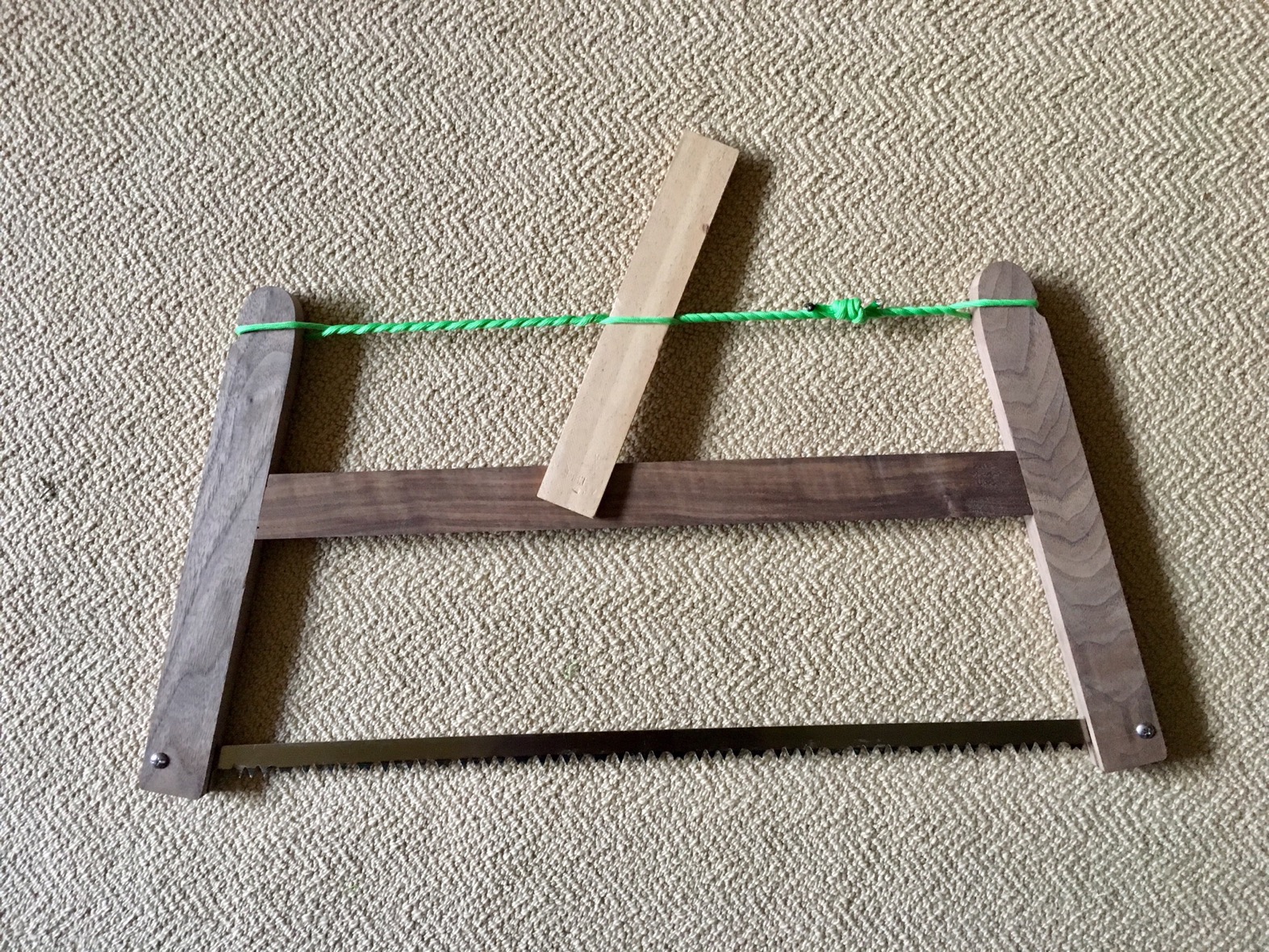

To make an understatement, I do not feel like I know what I am doing with a router. I want to round over the handles and cross brace of this buck saw but I don’t want to round over the areas where the horizontal brace is mortised into the upright handles. Further complicating matters is that the handles are slotted on the palm side of the grip because, with the Spanish windlass removed, the saw handles pivot around to store the blade. The stock is 3/4 thick.
There is also a notch where the windlass rope fits which is a semi circle, 1/2 inch in diameter.
I have a piloted 1/2 round over bit and have access to the overarm router , which I bought on a whim over a year ago when one popped up on eBay.
Oh, and the key for the windlass is being replaced by a piece of walnut; this was just a proof of concept.
Thanks for any advice or guidance.

I know I could sand or rasp it; I was hoping to get a very precise machined round over. Maybe that's just not possible with this shape.
Re: Round-over Question
Router table with a starting pin is what I would use. Just stop/start before/after the areas you want to leave square.

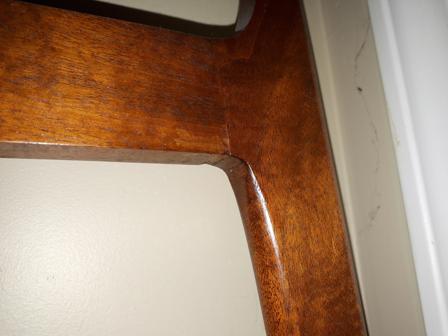

Stop the round over before you get to the cross member. This is a mortice and tenon joint on a three legged side table that I made back in high school.
roundover transition.jpg (322.31 KiB) Viewed 20100 times
reible wrote:Router table with a starting pin is what I would use. Just stop/start before/after the areas you want to leave square.
That is exactly how I have done it. You need a bearing on the bit. You might want to mark some stop and start points on the stock for consistency (over shoot / under shoot).
