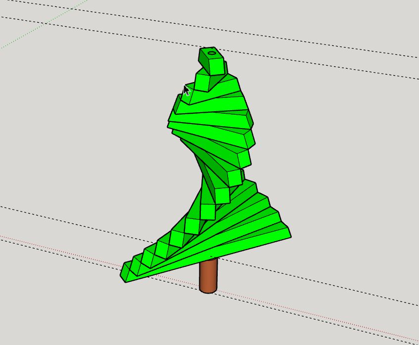

In the past I have made kites with a flag look to them but today I'm working on one that looks like a tree. This is the sketchup model and the real version is close to but not quite the same...... changes on the go as they say.

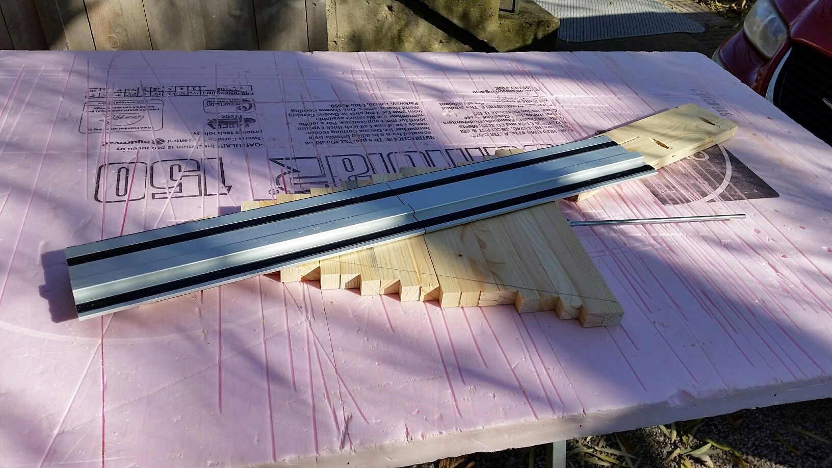

I've made some changes to how I do things. For one I now do a set of length cuts so they is less waste. Here you cans see the results of that type of cutting plan.

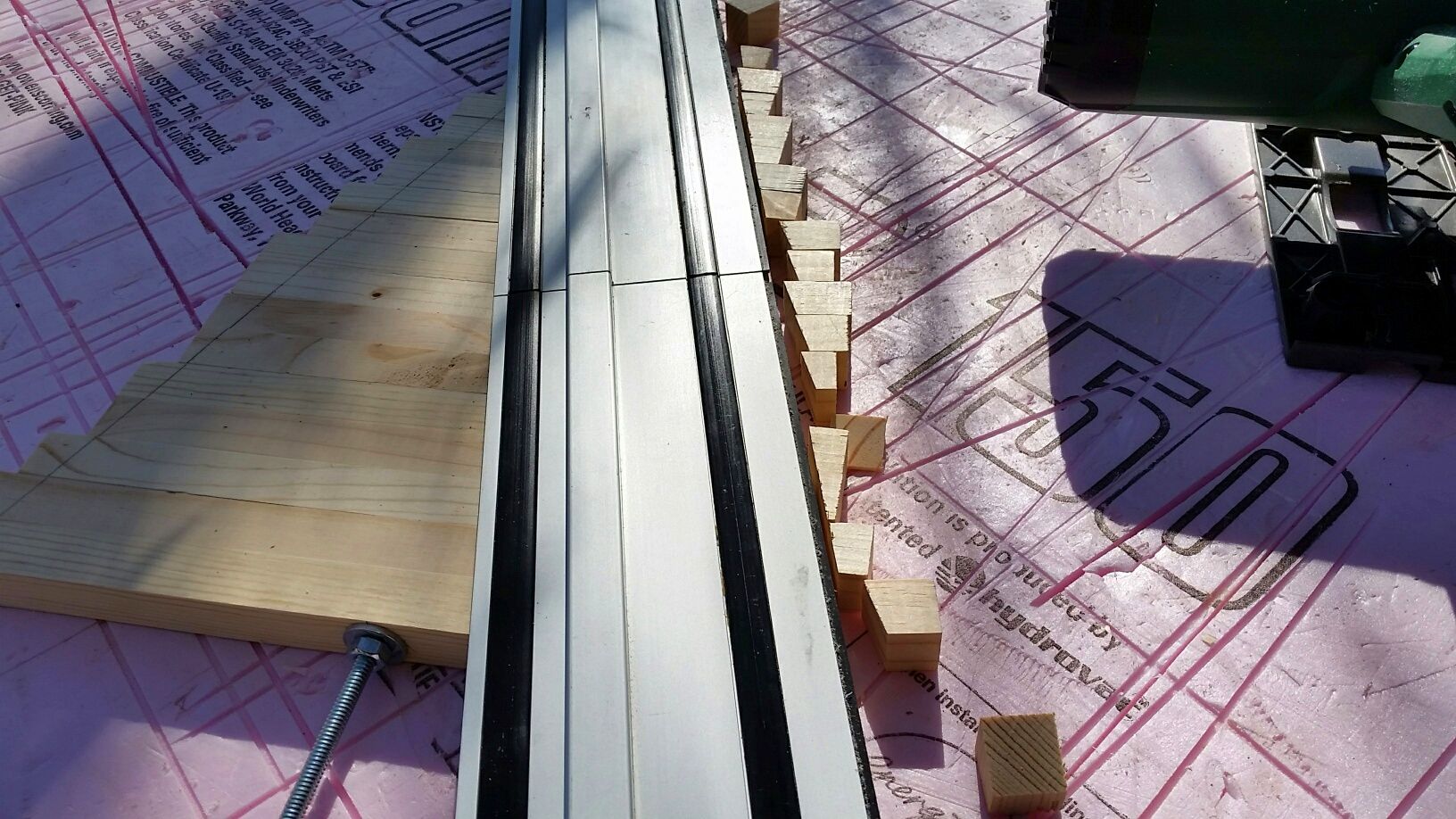

The other change was how I cut the parts to length/shape. I used my small track saw and it work really slick. Much faster then I could have done it on the shopsmith. It is simple and fast to align the edge of the track with the line.

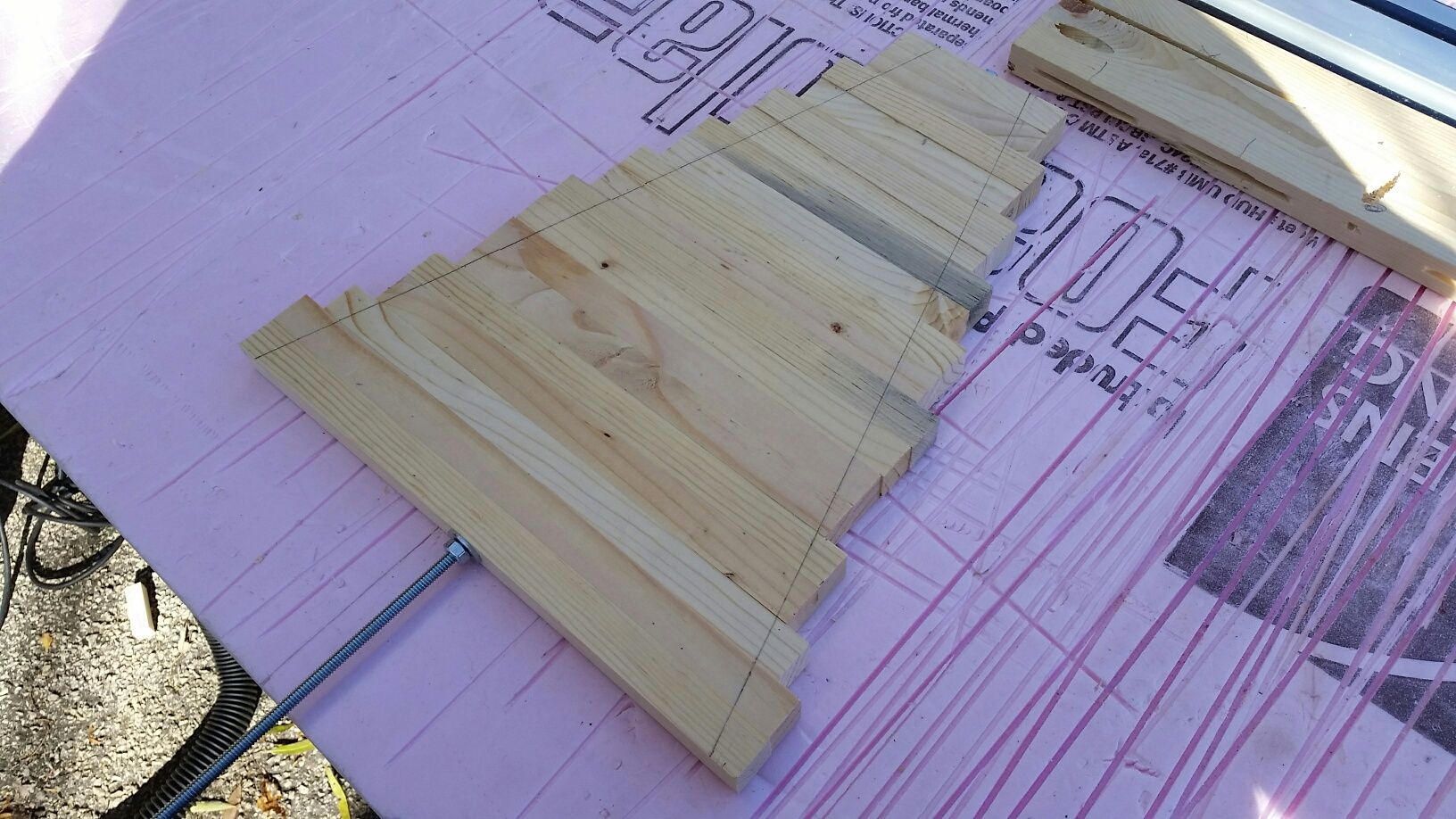

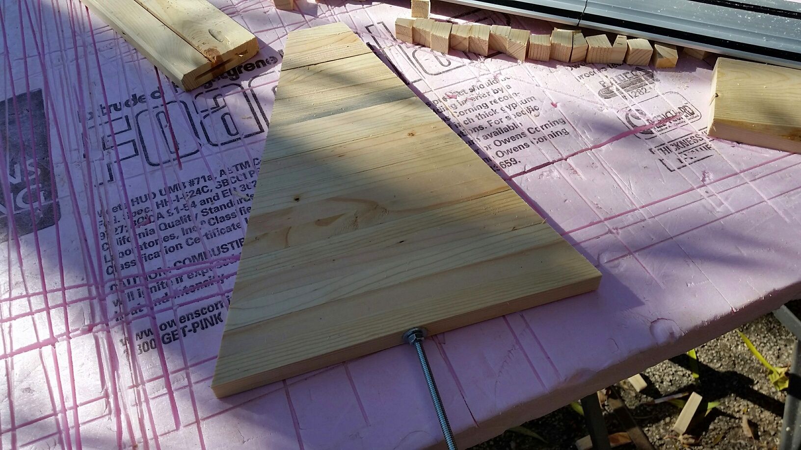

Here is what the cut off section looked like:
Just the two cuts and there is the base tree.

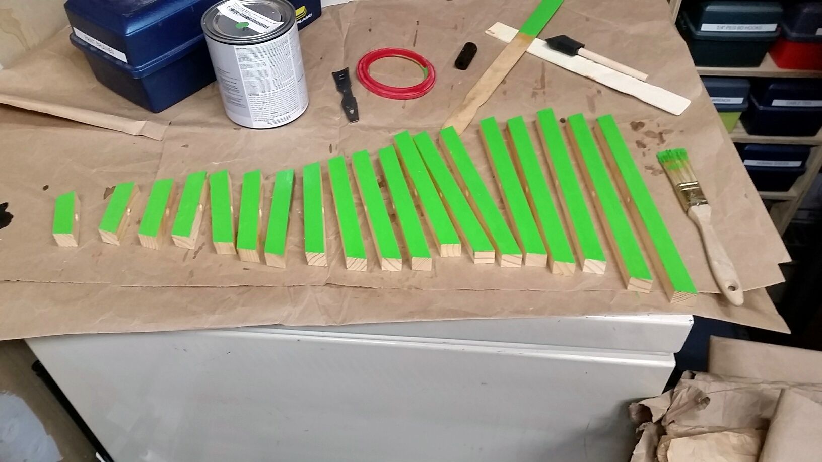

The wood has been sealed and the painting has started:
A couple more days and it will be spinning!

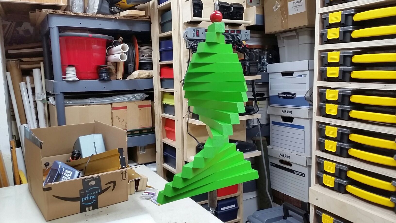

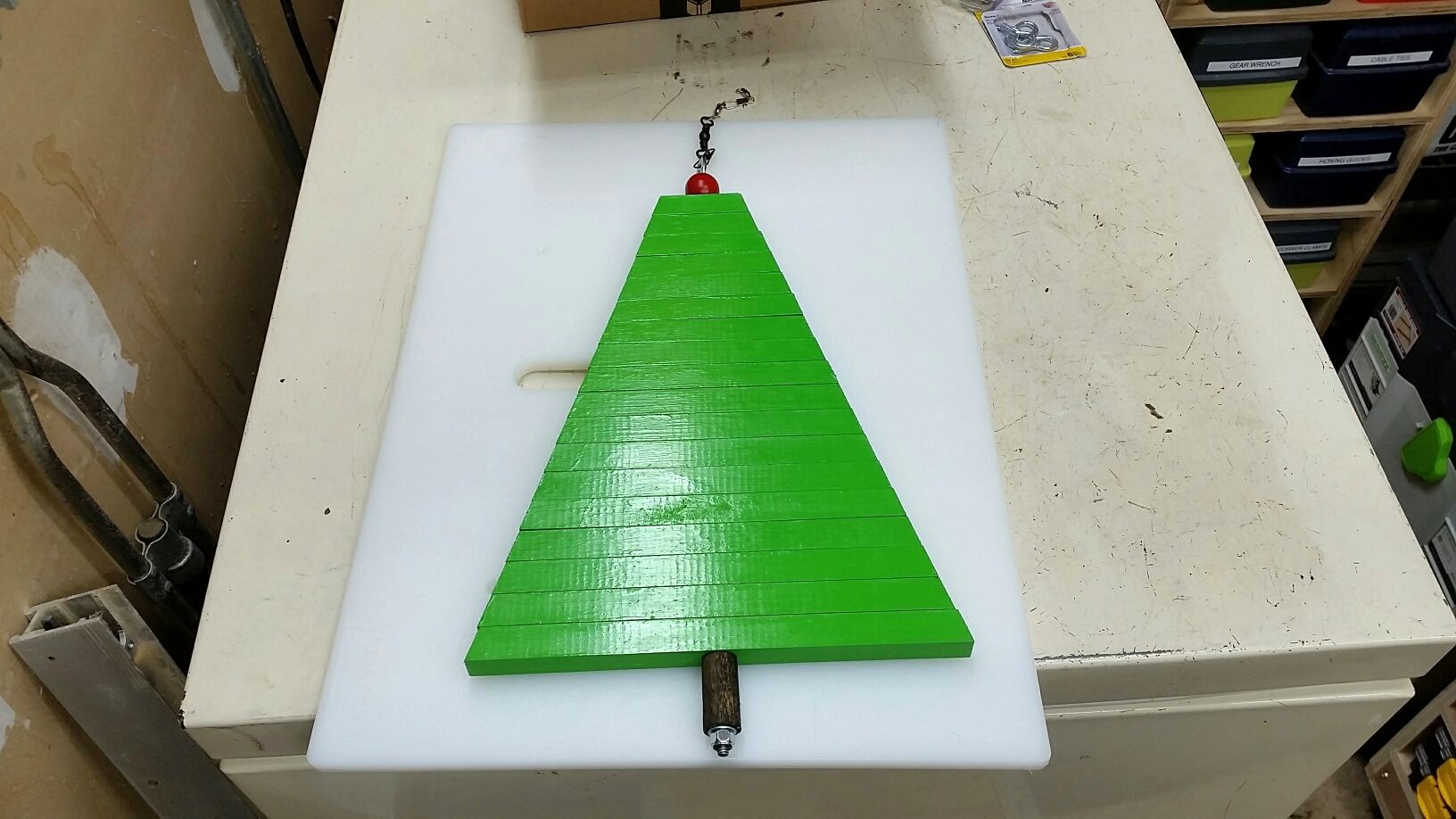

The paint is dry and it was time to put it all together. Here it is in flat mode:
And here it is with it "wings" spread ready for a spin test:
To see it in action take a look here:
https://youtu.be/V7ejP9O0Q1w
This is the inside test using a fan. Tomorrow weather permitting I'll get it outside spinning in the wind.

I’d be very interested to see it spinning in the wind. I’m a bit puzzled ... the wind-loading force seems like it would be more-or-less balanced. Unless it was blowing straight up or down, that is. :confused:

BuckeyeDennis wrote:I’d be very interested to see it spinning in the wind. I’m a bit puzzled ... the wind-loading force seems like it would be more-or-less balanced. Unless it was blowing straight up or down, that is. :confused:
Consider the wind as a vector force against the 'equal but different angle faces'. Deduce the resultant force vectors. Sum the individual pieces.
No calculations needed. Just roughly consider that.
I thought I had done that, but I was considering only the long faces. Looking at the end faces, the resultant torque about the vertical axis would indeed be unbalanced. Assuming that the fan is next to the camera in Ed’s indoor video, and blowing air toward the spinner, the direction of spin now seems to make sense.
