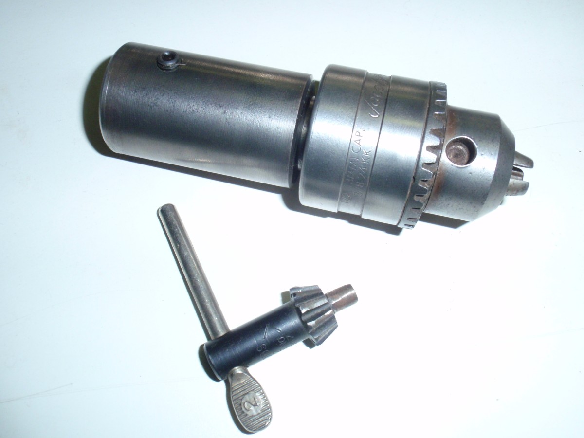

BuckeyeDennis wrote:Drill chucks aren’t designed for side loads. That said, I don’t know how much is ‘too much’.
Most drill chucks are attached to their spindles by a tapered fit, side loading can cause them to work loose :eek: . Shopsmith drill chucks, (with the exception of the very early 10e drill chucks*), mount directly on the spindle and are retained by the set screw so side loading should not be an issue. :)
* The early 10E drill chucks had an adapter to use a normal drill chuck with the taper.
photo copied from the Yahoo Shopsmith 10ER Users group

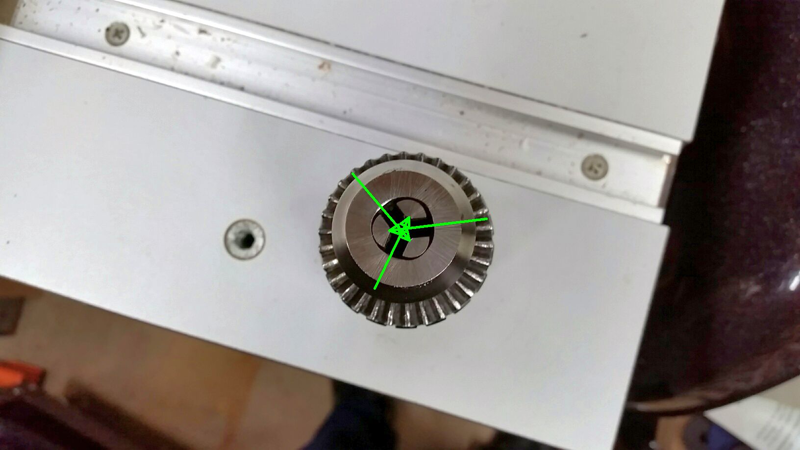

by reible
Drill chucks are not good for side loading because there are only three very small contact areas as seen with the green arrows in the image below. The rest of the area has no support. If you ever sat on a three legged stool you know how well that works........
Re: Shop-built spindle sander
Posted: Sat Dec 09, 2017 4:37 pm
by JPG
Add very narrow 'foot' area to those three stool legs and make them 'vertical' rather than 'splayed' for a clearer more equivalent example. :D
