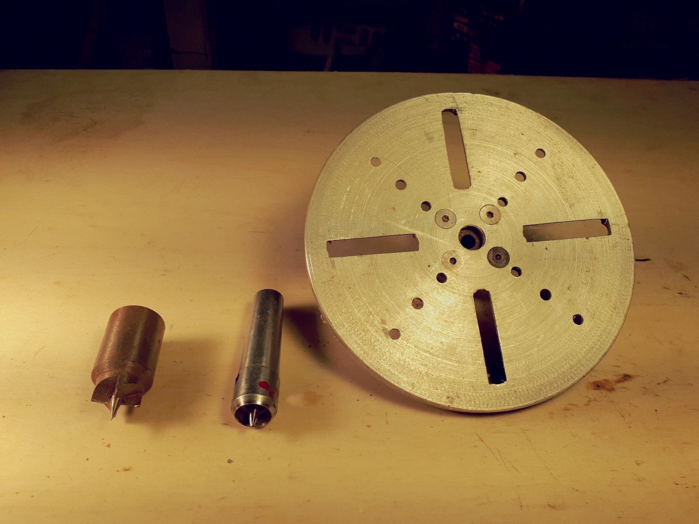

I just got a Mark 5 and the lathe does not seem to turn right. I am thinking the Tailstock Cup does not fit right. It is very tight and does not turn. Am I correct that it needs to turn as well. If so what type of oil/grease do I use? I don't see to see anything about that in the manual.

It sound like you have a dead center, (middle in picture below) they are not designed to turn with the wood, don't over tighten the quill advance, and lubricate the cup with some wax.

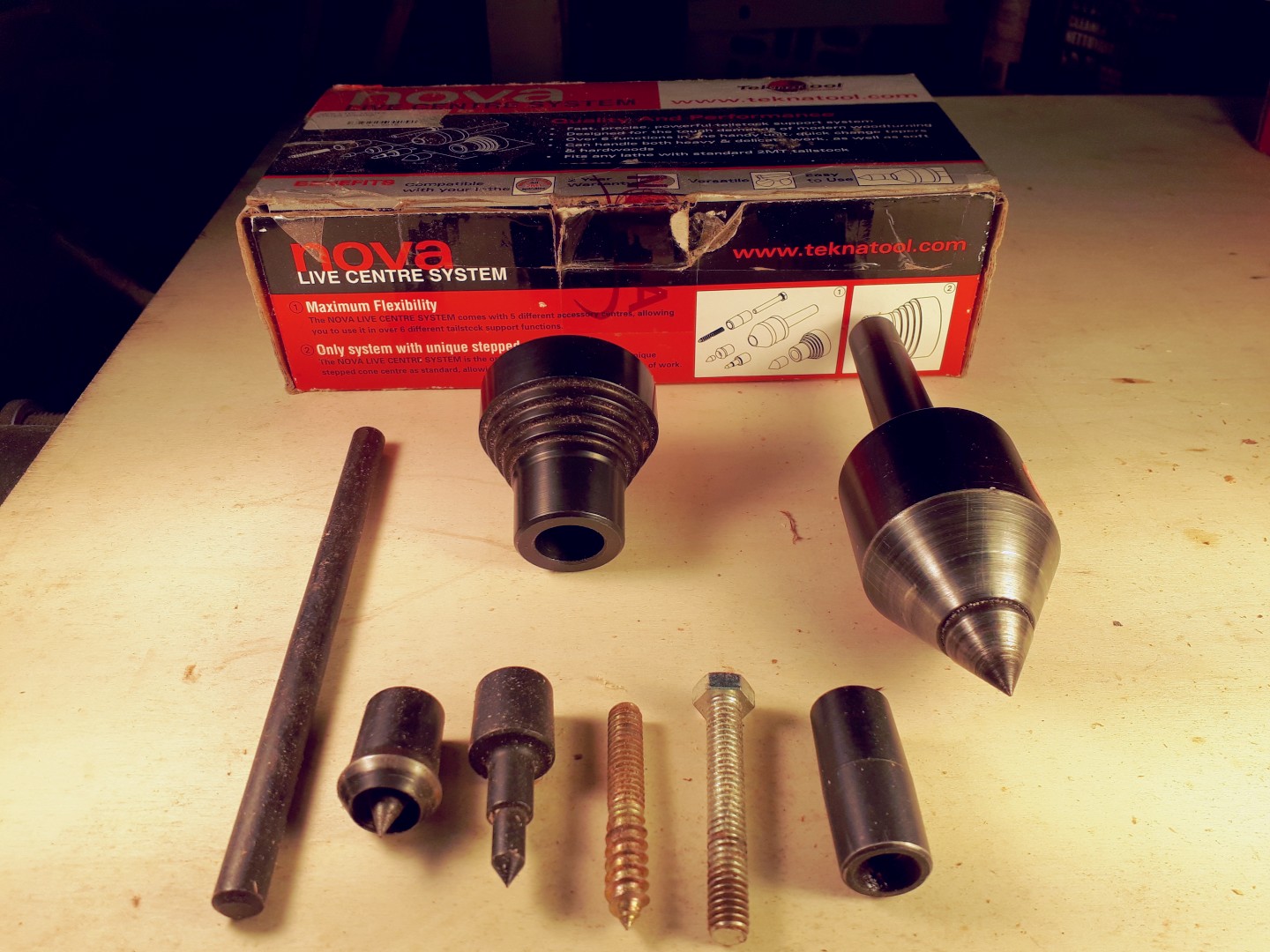

A better option is a live center, which has a bearing so that the point turns with the wood. (item C in the linked page)
http://www.shopsmith.com/ownersite/cata ... enters.htm
and better yet (but more expensive) is a live center with more that one bearing, and more options for points.
http://www.shopsmith.com/ownersite/cata ... center.htm

To expound on Ron's post, you would want a live center with a MT2 (#2 Morse Taper) shaft. The links Ron posted have the correct shafts, but you can also get live centers from nearly any wood turning tool seller.
