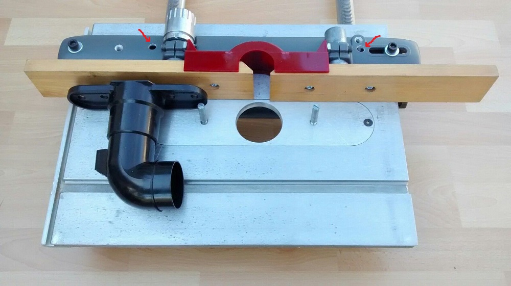

The Router/Shaper Fence for the Model 510/520/M7 tables mount with cap screws and nuts which go through the holes in the table next to the insert hole. The Router/Shaper Fence for the Model 500 is too short to clamp on to the wider 510 table like it does to the original 500 table. There are some who have adapted the 500 to fit the 510 as shown in the picture below.
555144 on 510 table adapted r.jpg (162.1 KiB) Viewed 5412 times

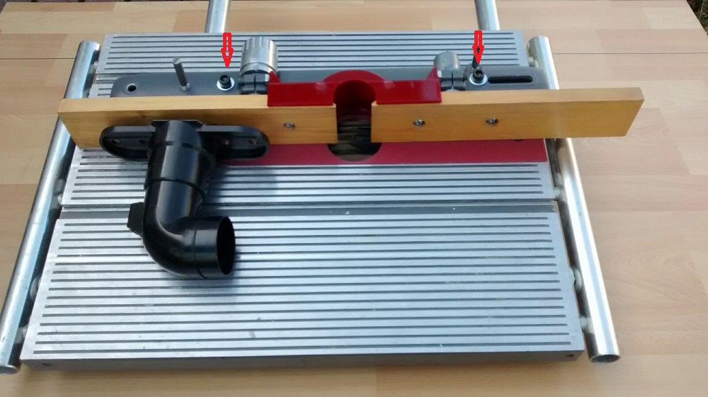

It requires drilling the matching holes to attach it with Cap Screws and nuts shown with the red arrows. Below is the fence shown on the 500 table and arrows pointing out the holes for mounting it to the 510 without any screws.
555144 on 500 table r.jpg (139.02 KiB) Viewed 5412 times
I have not done this myself since my first Shopsmith was my father-in-laws 520 and so I bought the fence made for it.
