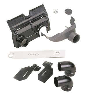

That being said some blade guard systems work better than others at containing dust and directing it to dust collectors. Most of the Mark V with the original 500 table system in the 1980's came with the blade guard set for dust collection shown below.
505627 Upper and 505628 Lower Saw Blade Guards r.jpg (175.28 KiB) Viewed 23291 times
It leaves a lot of open space below the table for dust to escape.
It was replaced by the one shown in the picture below
505875 - 500 Saw Blade Guard Assembly 1980s r.jpg (207.59 KiB) Viewed 23291 times
It has less open space under the table but has only an 1-1/4" hose attachment. This one was upgraded to two 2-1/2" hose attachments and provides better air flow. You can still buy either the upgrade parts or the complete upgraded guard system. Both are shown below.
555294 - 500 lower sawguard upgrade.jpg (14.68 KiB) Viewed 23291 times
505875 - 500 Saw Blade Guard Assembly Version 2.jpg (17.34 KiB) Viewed 23291 times
