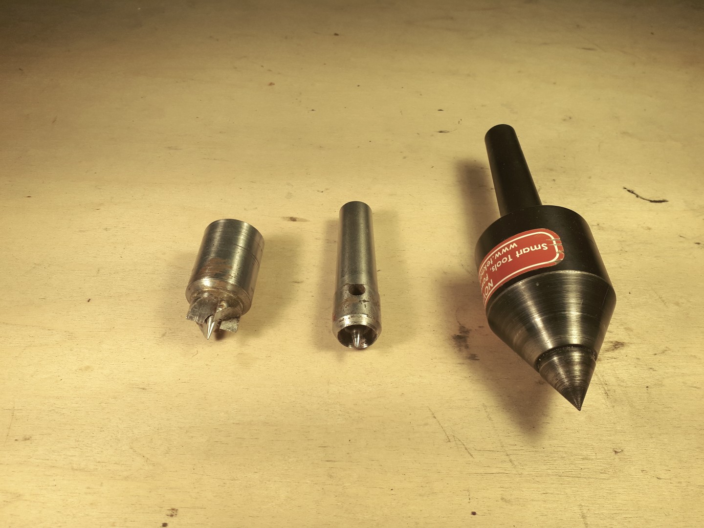

No chapter where I live but there are 2 in the city (Kansas City). I thought the one that goes into the head was the dead center and the one in the tail stock was the live. Am I thinking backwards? As for YouTube, I've been bringing those videos :)

The live center goes into the tail, but the one shipped with a Shopsmith is a dead center. If you want the live center, it is optional and available from Shopsmith.

Left to right there is a
- Drive Center- goes on the spindle - grips the work and makes it turn
- Dead Center - goes in the tailstock - supports the other end of the work but does not turn, requires lubrication to minimize friction.
- Live Center - goes in the tailstock - supports the other end of the work but has bearings so it turns with the work.
lathe centers.jpg (287.03 KiB) Viewed 15563 times
Re: Oh Dear God, what have I done.
The SS live center has the ring and pin like the dead center, but it does rotate with the work.
