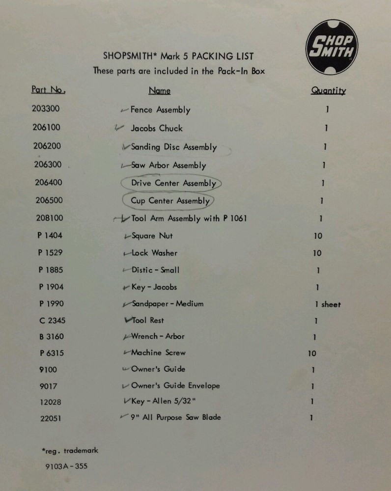

JPG's list looks pretty complete. Knowing what year and even month, your Shopsmith Mark 5 was made will help in identifying what came with it. The serial number can tell us that. There were a lot of changes made to the Mark 5, especially in the headstock, in the early years.
Below is a copy of a 1955 packing list. It fairly represents the Mark 5 from those early years.
Mark 5 Packing List from 55 machine cr.jpg (119.83 KiB) Viewed 5954 times
As stated on the list these parts are included in the "Pack-In Box" that came in the shipping crate. The Shopsmith was shipped partially assembled except the legs were not attached which is the reason for the 10 Machine Screws, Lock Washers and Square Nuts. Also note that these early Mark 5's used a 9" saw blade not 10". The Blade Guard was an optional item along with the Retractable Casters and Lathe Chisels. Out of the box it was able to provide it's 5 functions of Table Saw, Drill Press, Horizontal Boring Machine, Disk Sander and Lathe although it didn't include the chisels.
