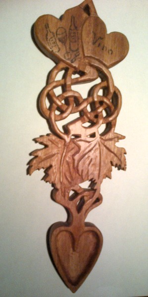

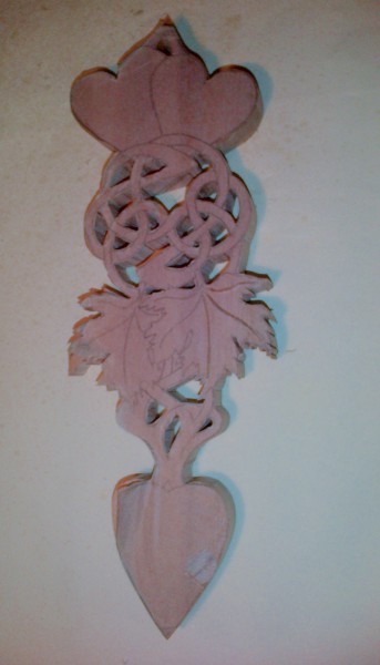

shoedo wrote:Wow! How many years did it take before you could produce artwork like that?
I have little to none artistic talent. :eek:
My wife, who was born in Wales, wanted to carve Welsh love spoons. She took a course at the local Lee Valley store. She would find designs in books and on line and then modify them to suit her taste.
The pattern was then printed out, I would glue it to a piece of wood, drill holes in all the internal spaces, and saw it out on the SS jig saw, mine is the earlier model for the 10ER. I had not used the jigsaw for much before that, but it is not that hard, you just go slow and follow the lines. :) You do get faster at blade changes doing all the small internal spaces.
The one in the picture above is just the sawed out blank. This is how it looked after she carved it and finish was applied.

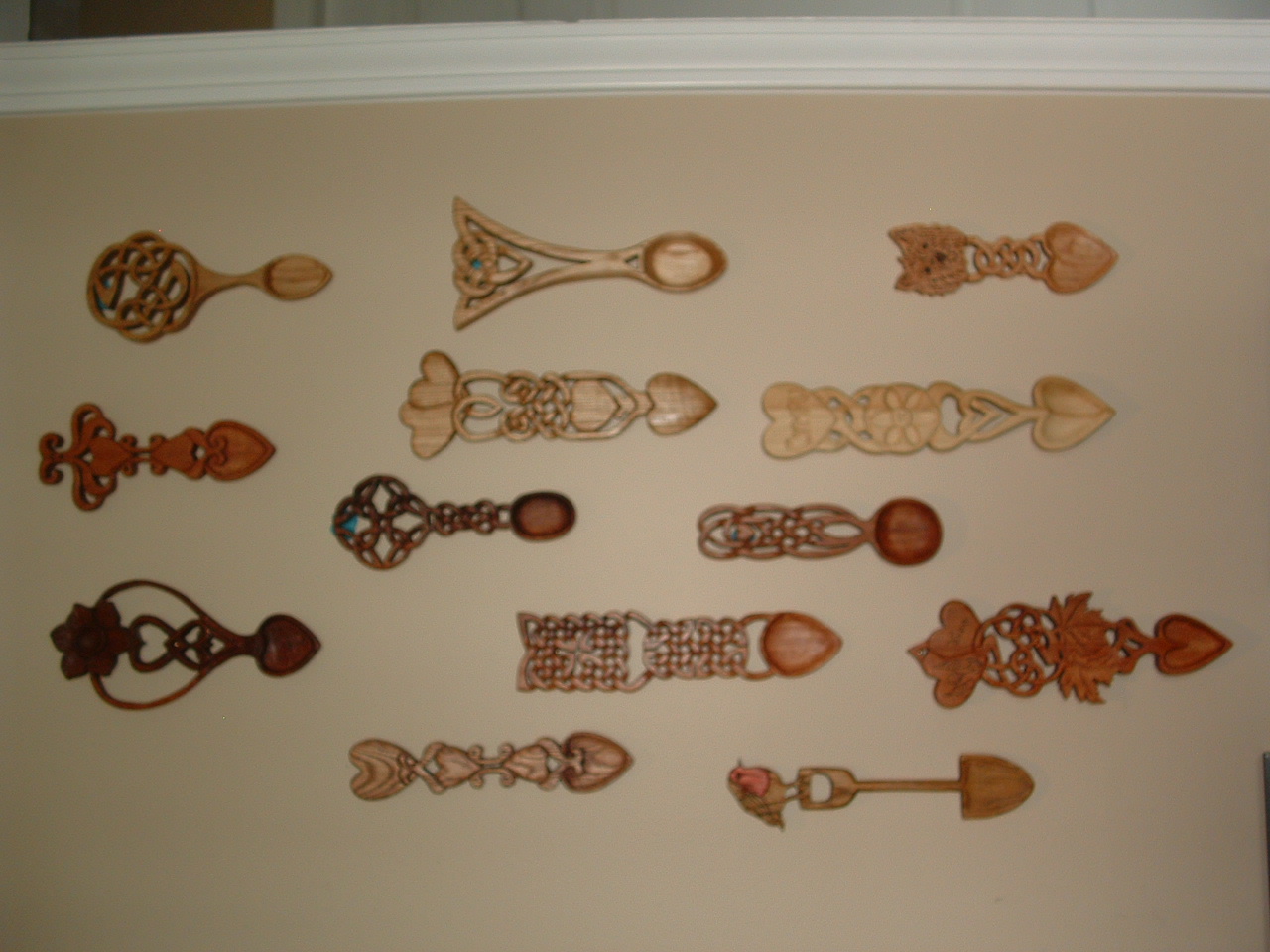

She did quite a few of them. these are just the ones we kept, many more were given a way.
