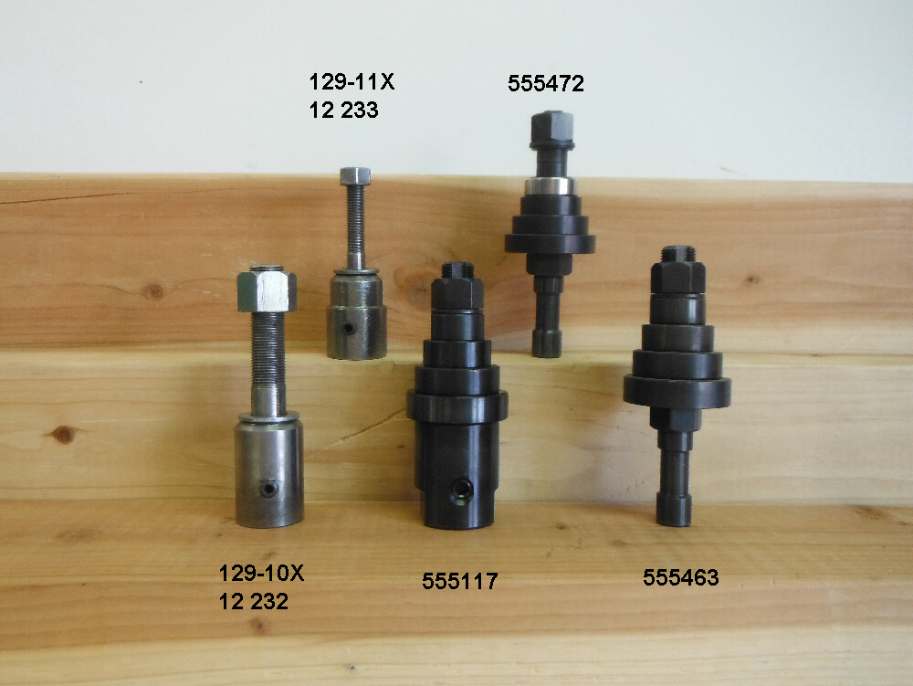

That was only Arbors and does not include the Shaper Spindles. Those are in the following picture.
Spindles Labeled.jpg (300.67 KiB) Viewed 13370 times

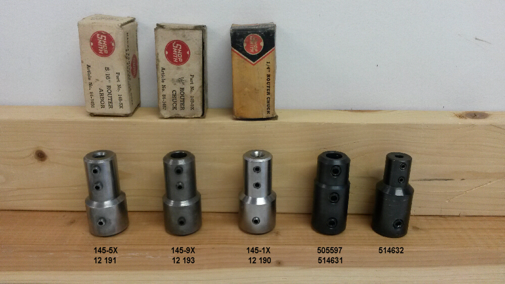

There were two versions of the early 1/2' Spindles with one having a wider shorter base (not shown) and the other (shown). These early Spindles also came first with a 1/8" set screw and after the introduction of the Mark 5 a 5/16" set screw. The Chucks, not Drill Chucks are generally the holder for the Router Bits and shown below.
Chucks Labeled.jpg (341.87 KiB) Viewed 13370 times
This picture does not show the straight sleeve 1/2" Chuck in either bare metal or black oxide coated. It also does not have the 1/2" Eliminator Chuck. I hope this information with the attached PDF's and pictures helps.
In your pictures you show some washers and spacers for arbors (king of clubs & 7 of hearts). These are used with the first Arbors both 1/2" and 5/8" through today with the 5/8" Molder/Dado Arbor (505506) to space and hold different blades or other items requiring an Arbor like the current Molder Head. Theses Spacers and Washers are all machined on one side next to the center hole and the machined side goes towards the blade or other item it is holding. The Shaper Spindles use Rub Collars and has 4 different diameters used for the depth of the cut. Not all of the items you have are made by the manufacturers of the Shopsmiths over the years. I do not recognize what the two items are with the 2 of hearts but they look like some kind of brackets or holder parts. Sorry my best description as I hurry to get this finished. Hopefully you can identify the Shopsmith items you have from this information. If not feel free to ask about specific items.
