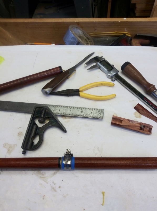

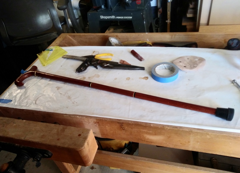

One of my coffee buddies asked me to repair and adjust the length of a broken cane for his wife to use.https://www.youtube.com/results?search_ ... ane+height He said it was a very expensive cane and made of rosewood. I don't think it was rosewood. It may be ibe or some other tropical hardwood with a tint in the finish.

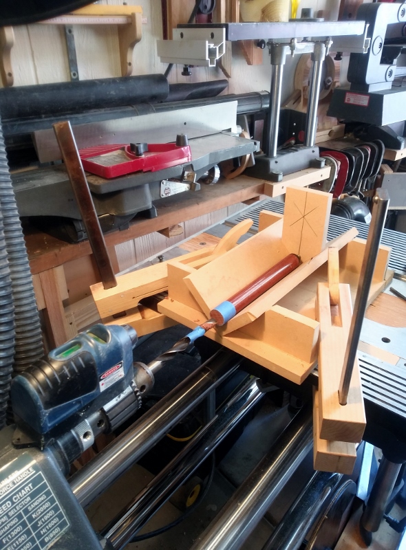

In order to align the hole for the ferrell socket as close as possible I used a drilling jig and a laser level on the drill chuck (left of picture) along with a movable target block (right side). The cane shaft was tapered so I wrapped tape around the small end to compensate for the taper. Another problem was the shaft wasn't exactly round so I guessed. Anyway to my surprise the socket hole was straight and centered. I placed a hose clamp around the cane shaft to prevent splitting while inserting the socket.

Great job Glenn! Inquiring minds want to know, what is that laser looking gadget on your Mk V and what is it used for?
Jack
Re: Walking Cane repair & length adjustment
claimdude wrote:Great job Glenn! Inquiring minds want to know, what is that laser looking gadget on your Mk V and what is it used for?
Jack
It is a laser 'level' used for aligning shop made fixtures. :cool: :D
Jack
I am not sure what the question is but it is an off the shelf lazier level. Just a tool to be used any way you can think of. https://www.amazon.com/s?k=laser+level& ... ss_sc_1_11
