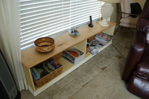

I have only used the router function on the mark 7 one time to put some slots in some cabinet shelves to prevent the shelves from shifting. The slots were 3/8 inch wide and about half the thickness of the shelves deep. some 1/4 inch dowels were installed in the uprights of the cabinet so the dowels are in the slots when the shelves are used. I had no problems with the operation and was pleasantly surprised at the smoothness of the cuts.
finished and in place.jpg (31.96 KiB) Viewed 15609 times
Here is a pic of the cabinet.
Bill V
