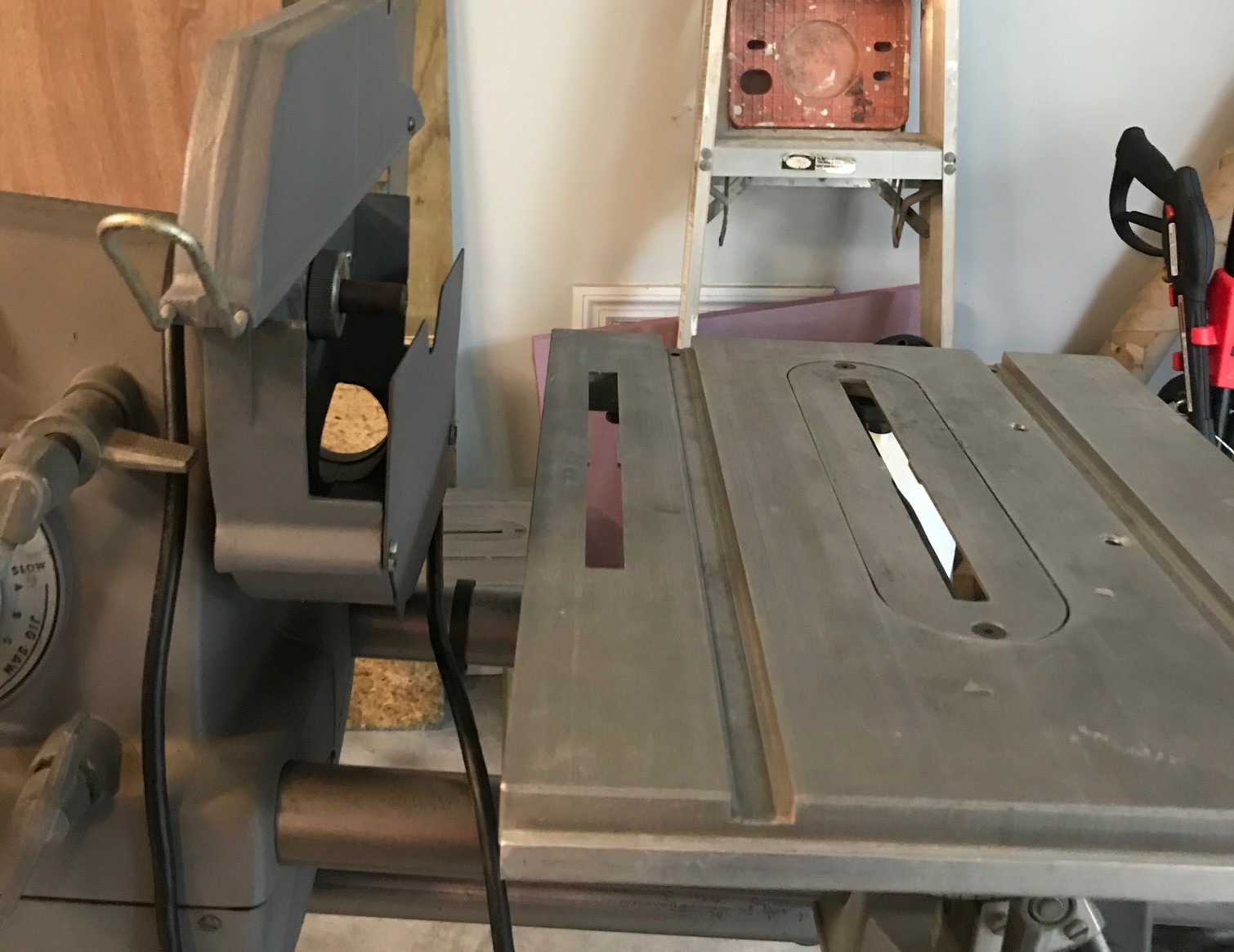

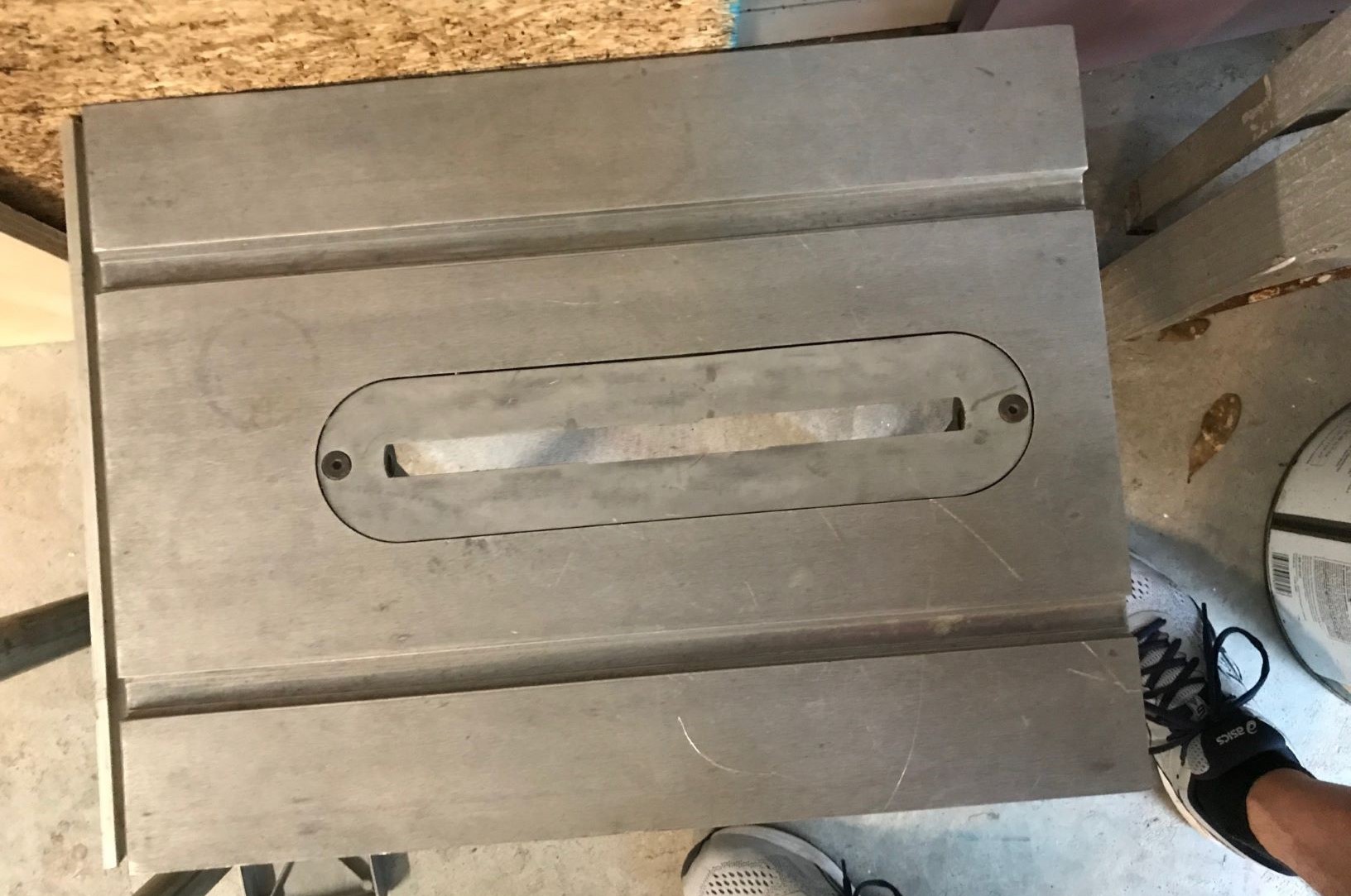

Table 1
Table 1
This is the first table, above.
Table 2 below
Table 2
Table 2

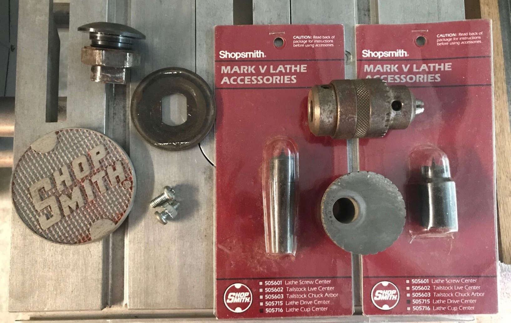

Accessories
What came with the  500

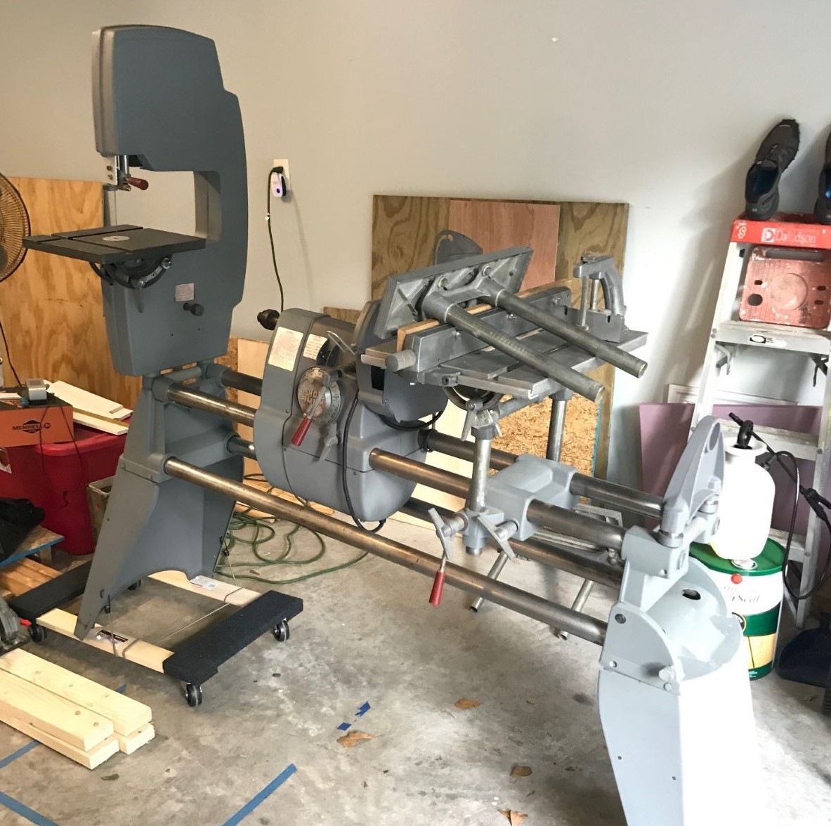

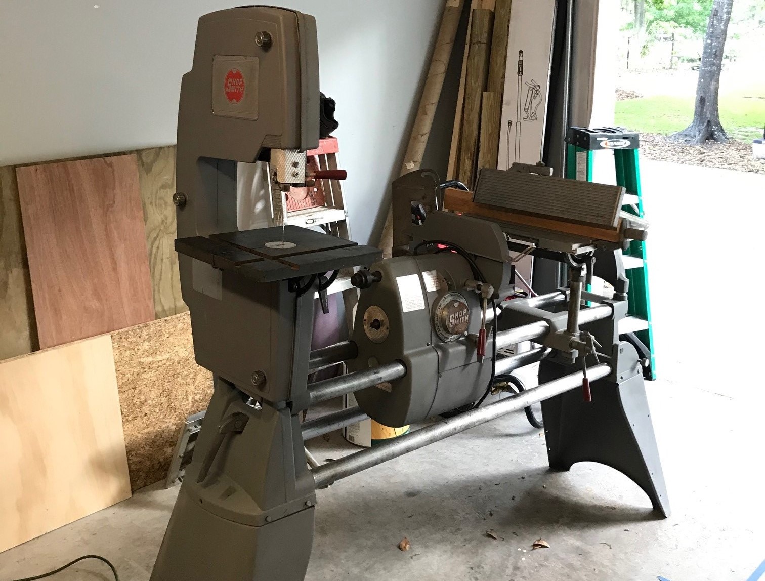

Below are other pics of the 500
Body1
Body1
Body2
Body2

First, I think yours is older than 1988. Looking at the Serial Number guide on this website, probably made between 1973 and 1978, and closer to 1973 end of the range. https://www.shopsmith.com/ownersite/serialnumber.htm Date codes didn't begin until 1988 and the date code is 6 digits (month, day, year)
The table with extra slot may be original with the main unit. The second slot, intended to make ripping wider boards possible while fence is still on table, was discontinued sometime before 1980. (My 1980 model came with a notice explaining that the 2nd slot had been recently discontinued).
Upgrading to a larger table system is certainly possible, but be aware that many other things would have to be upgraded too, such as fence, saw arbors, saw guards, sanding discs (which I don't see any by the way)
Some owners have added a second carriage and use two 500 tables for extra table saw surface area.

Left to right,
- Inspection hole cover plate, goes on back side of the headstock
- Shopsmith saw arbor, takes blades bored to 1-1/4", you can get an arbor that takes standard 5/8" bored blades 555321
https://www.shopsmith.com/ownersite/cat ... arbors.htm
- Dead center, goes in tailstock for lathe turning
- Drill chuck
- Eccentric, mounts in the tailstock
- Drive center, mounts on the spindle for lathe turning.
You could make brackets to mount your extra table to the back of the main table as an out feed table.
This video shows that done for the 10ER, I'm sure it wouldn't be that difficult to adapt the concept for your Mark V
[youtube]https://www.youtube.com/watch?v=9R6Czc47jXo[/youtube]

The last two posts have given you some good information and I would add to that. Your Shopsmith Mark 5 was made in 1975 by my best estimate by Shopsmith Inc. The main table with the extra slot was its original and the extra slot was discontinued by 1980. There have been many changes to the Mark 5 (pre 1980) and Mark V (1980 to present) over the years. The manuals referenced in the link above are for the early Mark 5 from the 1950's and show the Gilmer Drive not the later Poly V drive your Shopsmith has. Other changes occurred between then and when your Shopsmith was made. The good news though is the operation of the Shopsmith is the same. The Self Study Guide (10 lessons) and the book Power Tool Woodworking for Everyone are excellent references on using the Shopsmith. As was already said the current edition of PTWFE is available online on the Shopsmith website and the 1st edition is on Everett's google drive linked at the same place as the 1950 manuals. The 1st edition featured the Shopsmith Model 10ER not the Mark 5 so I recommend a later edition such as the 2nd, 3rd or revised edition. The 3rd edition would have come with your Mark 5.
Before you look at upgrading your Mark 5 try using it and getting to know it's capabilities first. As you have already seen it can be a bit costly to upgrade. You may want to consider keeping an eye out for used Mark V with the table system you want which could be less than buying the needed parts. Remember the difference in the models of the Mark V 500, 505, 510 and 520 is the table system including the carriage and related parts. The headstock and bench are the same.

Here is a page from a 1980's Owner Manual page that shows what would have come with a Mark V in 1980 ... yours likely was very similar.

br549 posted a copy of the standard attachments page from a 1980 manual. It is the same as the 1973 manual except the Saw Blade Guard was not included as standard items yet and the Sanding Disk was originally Aluminum. You already have the Blade Guards. If you have any specific questions that would be in the manual I have the 1973 and 1976 manuals. You can also copy the PDF version of the 3rd Owner's Manual from Everett's google page as a reference. Newer editions of the manuals were mostly a result of changes to parts on the machine. Most of the setup and operation information, including the pictures, remained the same through the first Shopsmith Inc. manual in 1973.
