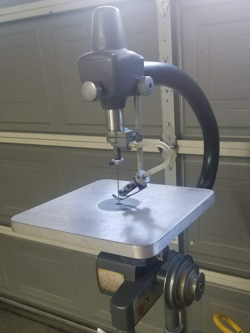

I ran across this jigsaw and was wondering if you would fit my MkV 500? The pulleys on it have me doubting it would, as i do not know how i would transition to the pulleys.
Also, i have the 11" bandsaw, is there any advantages to having both?
Here is a pic:
MARK V 18" JIGSAW MODEL #505644

Yes, it will, The pulley would have been used to run it on a power stand. Remove the pulley and use a hub and coupler.
You can download a manual from this link. http://vintagemachinery.org/pubs/detail.aspx?id=10571

That Jig Saw in the picture looks in great shape. IMPORTANT, before running it make sure the main housing has oil. See Manual! The Jig Saw is no longer made and many of it parts are no longer available new from Shopsmith. As for blades it uses common plain end blades found from many suppliers and the same as the Scroll Saw blades for double end use. A unique feature of the Jig Saw is it can use single end saber/jig saw blades with the upper arm not used or removed for more clearance.
