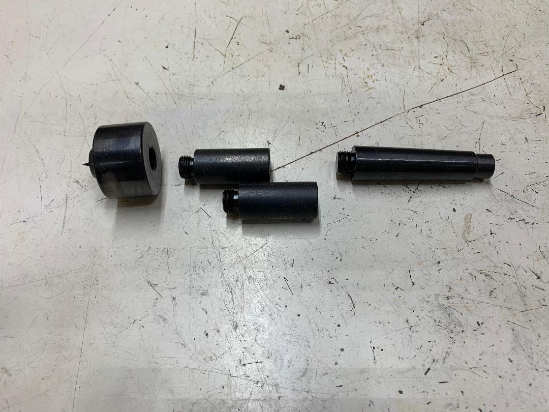

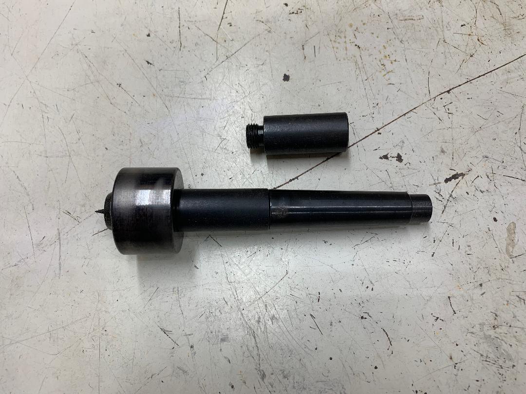

It is the same center. The head part unscrews from the tapered part and there are two extensions that can be added. I think they came with the duplicator.
Re: Lathe Duplicater
TWO?????
I might have added another?? Anyway I have two.
In pictures:
I think you gots an extra one! ;)

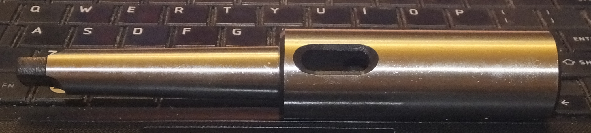

Another option would be an#2MT extension.
https://www.amazon.com/Morse-Taper-Exte ... B01BTBTDWO
YEP!
m2 - m2 adapter.jpg (589.57 KiB) Viewed 4670 times
Paid a lot less than 48+.
