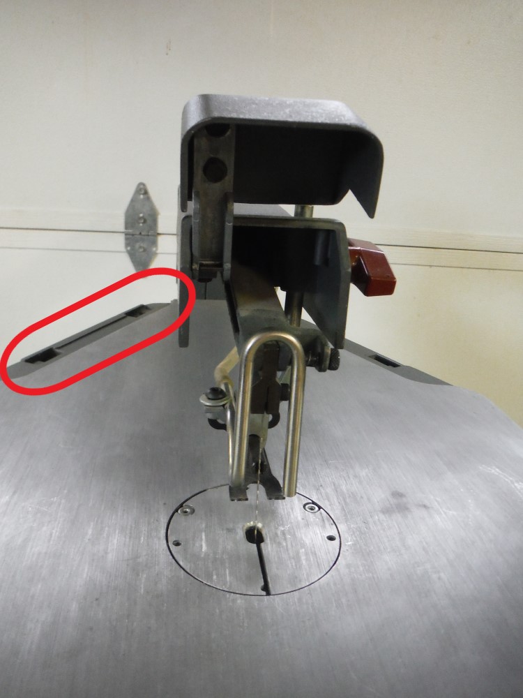

The Blade Mounting Fixture for the old/original Blade Blocks is on the edge of the table as shown in the picture below.
Scroll Saw Block Holder.jpg (108.77 KiB) Viewed 8320 times

There were several scroll saw tables even in the gray version. Mine did not have the table with the casting for this. The previous owner had mounted the seperate style version on top of the arm. When I got it only half was there and the other half lost somewhere.
I upgraded to the newer style so I never had to fight with the lack of the part.
