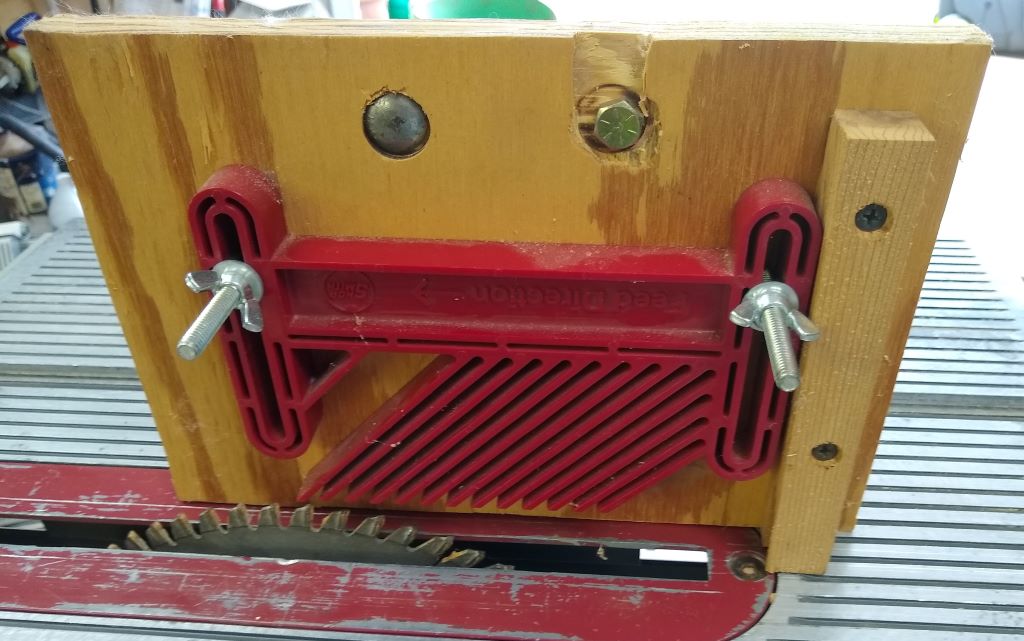

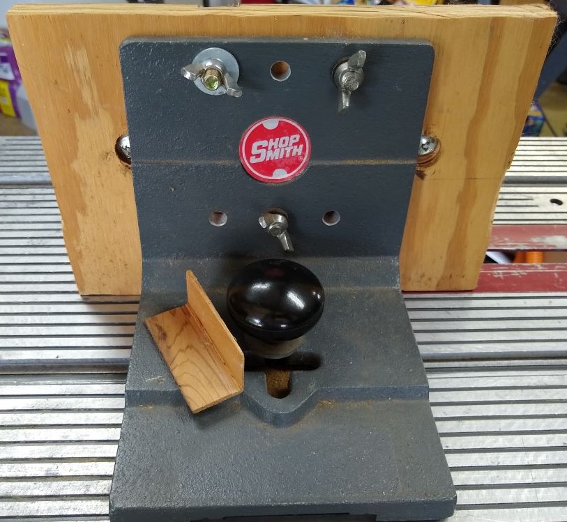

A small part sled example, which IIRC I modified from another jig by addition of the featherboard. I had made some corner pieces for a bird/squirrel feeder for my wife, more or less like outside corner molding. When I fit it I didn't like the look, wanted a somewhat deeper cut, but by now some of the pieces were small. You can see the cutoff (scrap) in the first pic for reference, the workpieces were around 1-1/2 X 1-1/2 X 2-1/2 long.
Sm part jig back
Sm part jig back
Sm part jig front
Sm part jig front
It uses a sacrificial guide to push the part. I used the featherboard in a non-traditional role to hold the part in place against the table and jig, its fingers instead of mine for safety. Despite the size of the pieces I was working with I felt perfectly safe and comfortable for this operation because I had no contact with the workpiece.
