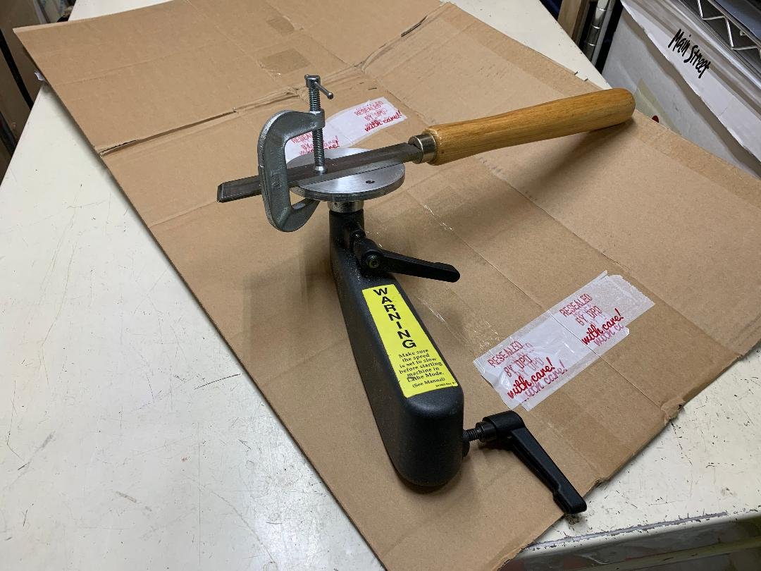

by reible
I have had good luck by using this setup:
tool rest.jpg (153.65 KiB) Viewed 4248 times
You could also just just the arm with a clamp and piece of flat stock below then the c-clamp, or any other options one can think of.
