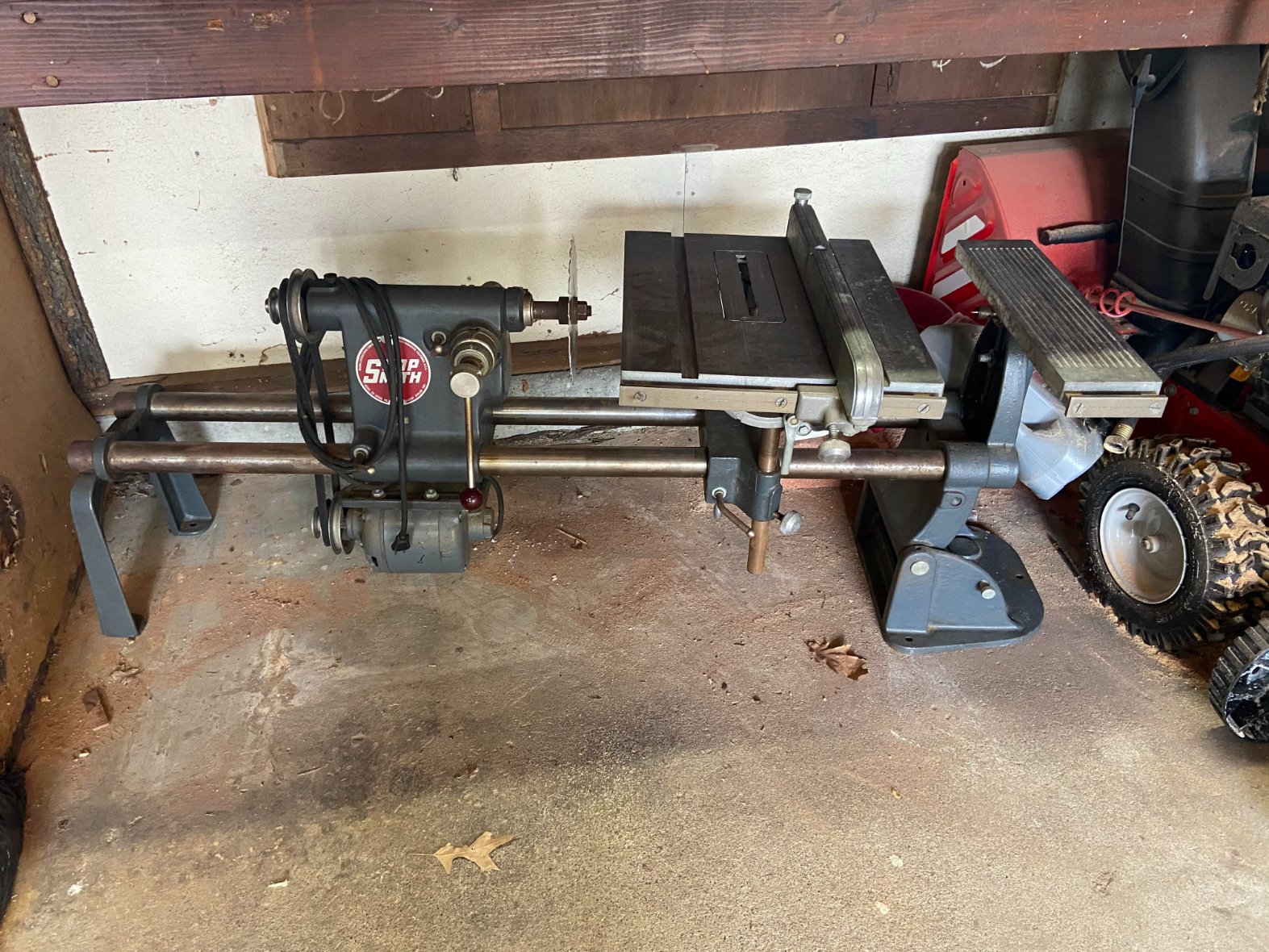

I picked up a Shopsmith 10ER (Serial ER51036) with various part/accessories, but far from a "complete set." I've tried reading through the forums and documentation and such and... wow! You guys are amazing in the breadth of knowledge and information. But for me, a complete rookie, it's entirely overwhelming :eek:
I'd primarily like to use this 10ER as a lathe and drill press. Is it possible for someone to just point me to the things I'd need to buy to make this dream a reality?
I plan to buy this Spur Drive Center Set (https://www.pennstateind.com/store/LCENTSET.html) and this Spindle Adapter (https://www.pennstateind.com/store/L5818.html) from Penn State for the lathe dream. Do I need a live center for the tailstock? Where do I get one?
For reference: 6 months ago, all I owned was a cordless Black and Decker drill I got for Christmas, and the socket set the bank gave me for free when I opened my first bank account 20 years ago... I only just recently figured out what a headstock and tail stock are. So... be gentle and feel free to assume I know nothing :)

I'm not (yet) a Model 10 guy, but isn't there some type of tailstock center in the OP's pic?
Suggestion for OP - Add a photo with all of the parts/accessories you have and let the smart Model 10 folks here tell you what you have.
- David

DLB wrote: Thu Jul 15, 2021 11:31 am I'm not (yet) a Model 10 guy, but isn't there some type of tailstock center in the OP's pic?
- David
Thanks - I'll do that!
