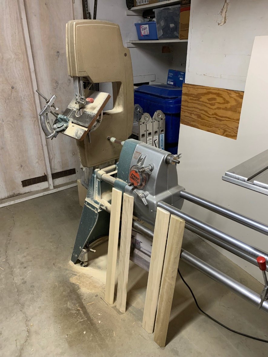

I used my ShopSmith bandsaw for the first time tonight to cut 45 degree edges on all the post and internal structure boards to make the square tubes. The bandsaw did a very nice job, as you can see in the photo below:
Used bandsaw to miter the edges of my freshly milled boards.
SS Bandsaw, first cuts-2.jpg (179.16 KiB) Viewed 18294 times
This is a fun little project. Hope to finish this weekend.

Nice start Marc. I am curious as to why you chose the Bandsaw to cut the miters instead of the Table Saw function. In this case either works, just wondering. It is nice to have options for doing the work.
Re: Preventing cat scratching new mission style recliners
Posted: Thu Oct 14, 2021 11:40 am
by Majones1
I just thought it would be a little easier to be more precise. When I purchased the plywood for the post I mistakenly got exactly the amount needed to make the four 6" sides, so I couldn't screw up the 45 degree cut or I would have to go buy more wood. Being a novice woodworker I felt I might have more control over those cuts.
Plus, I had never used my bandsaw since getting it from MickyD, and doing some clean up on it. It worked great. I had purchased some eccentric mounting posts and got it aligned perfectly with the headstock. The original posts had it misaligned about 1/4" so the power connection will have less stress on it.

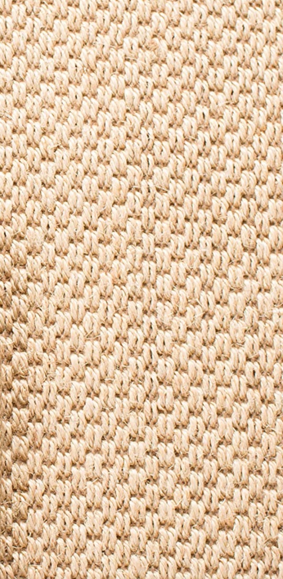

Anything is destructible by a cat. Which is why I’m making the post so I can replace the woven sisal rug, and making it much more sturdy than I probably need to. I’ll be able to replace any part they might destroy. I am completely fine with them destroying their post, as long as they stay away from my new chairs!
This is what the woven rug looks like.
Close-up of woven Sisal fiber runner (30” x 72” rug).

Majones1 wrote: Thu Oct 14, 2021 11:40 am Plus, I had never used my bandsaw since getting it from MickyD, and doing some clean up on it. It worked great. I had purchased some eccentric mounting posts and got it aligned perfectly with the headstock. The original posts had it misaligned about 1/4" so the power connection will have less stress on it.
I presume that means the original mounting posts were straight posts.(?) If I had 1/4" error with straight posts I would want to make sure I understood why. That's a pretty big error. To me it suggests a problem in the base alignment. That can be caused by the big set screw in the Headrest being out of adjustment (if you have one) or something wrong. Others would disagree with me on this, to some extent the eccentrics eliminate the need for accurate base alignment.
Side note: IIRC dust collection can be easily and inexpensively added to any bandsaw. It ain't perfect, but it's an improvement. You do have to cut a hole in the cover, so some purists may be opposed for that reason.
