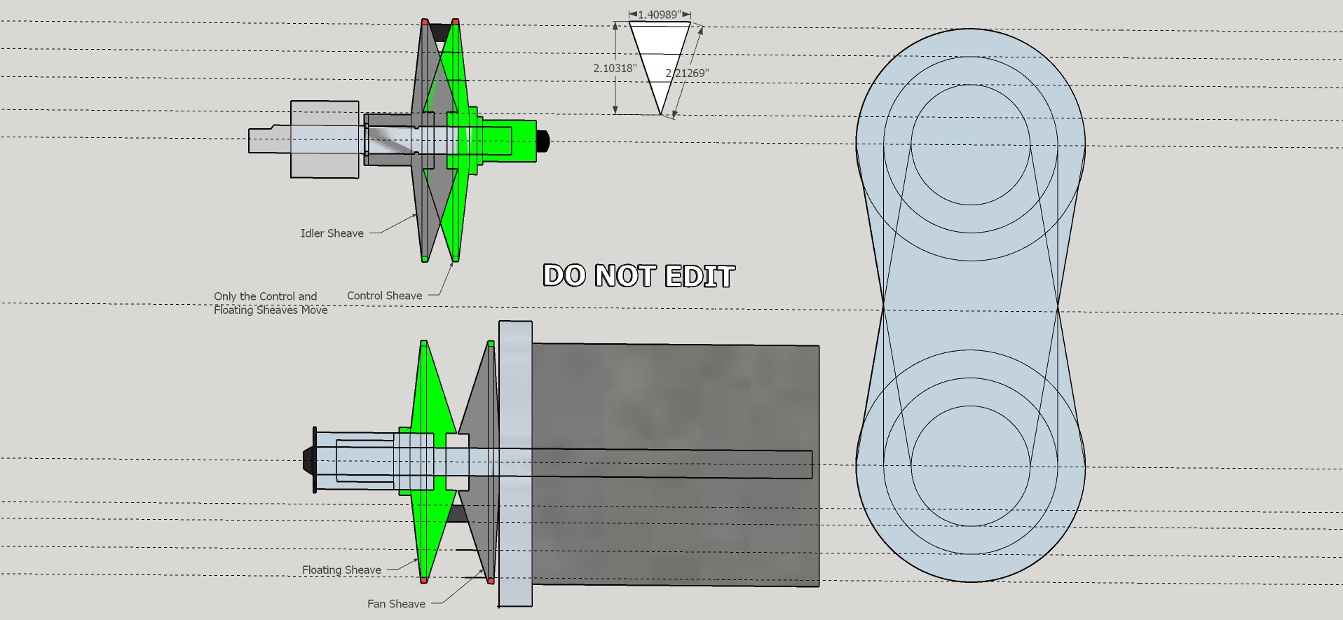

Just A Glance at Speed Control (The Sheaves)
Posted: Tue Feb 15, 2022 2:08 pm
by dusty
- The Speed Control System. .jpg (187.45 KiB) Viewed 2005 times
Shown at Low Speed

Re: Just A Glance at Speed Control (The Sheaves)
Posted: Thu Feb 17, 2022 4:40 pm
by JPG
Your drawing linked to above clearly illustrates that a previous statement by me re movable sheaves aligning with the opposing pulley fixed sheave at the extreme settings is WRONG!
Note the belt cross sections are not aligned (horizontally).
The three lines indicating the three belt positions in both idler shaft and motor shaft views should line up horizontally.

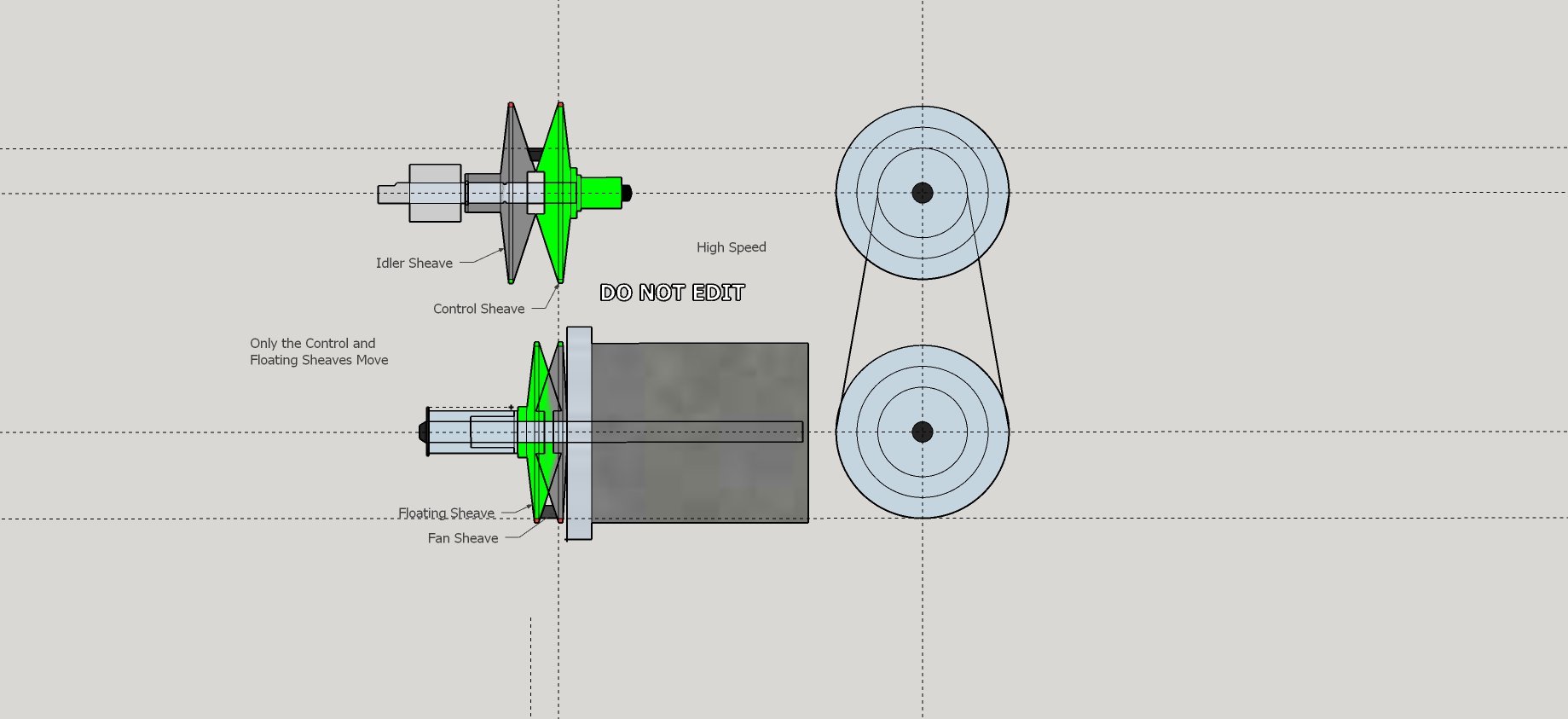

Posted: Thu Feb 17, 2022 5:14 pm
by dusty
Maybe I cluttered the sketches with too much information (too many conditions depicted on one drawing).
The following is the same basic sketch but with the sheaves and belt cross sections moved to High Speed.
- The Speed Control System. .. High Speed for Forum Post.jpg (105.02 KiB) Viewed 1802 times
