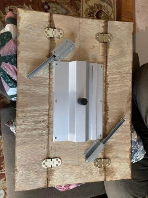

Hi,
I made a homemade small dropleaf table for my small RV. Because of the small size, I'm having trouble finding supports that I can use to hold the leafs up. Any suggestions?

tks..that may work but due to the location of the hardware, I was looking for something that might fit in between the hinges and table support. I've been looking at possibly using door bolt latches...but the bolt part seems a bit shortto provide support under the leaf.

edma194 wrote: Sun Mar 20, 2022 11:20 pm There is a lot of drop leaf table hardware available like these metal supports: https://www.amazon.com/POWERTEC-71426-M ... C123&sr=8-
Thank you for everyone's input. I actually bought the above supports, but are too long as is and was looking for other options. Have looked for awhile for shorter versions. I think I will mount them a bit diagonally on the center piece, but will have to cut the inner sliding part a bit shorter. I realize the top is not the best looking, but I quickly made as we are leaving on a long trip in a week or so. I plan to stain and poly the top. I think it will look ok for our use.

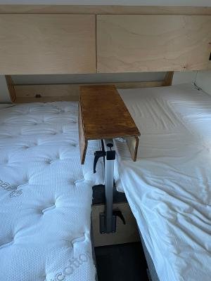

Hi, Here my final product. I ended up cutting the sliding leaf supports and positioning them at an angle. The leafs drop on both sides as it's in the middle of the sleeping area. The table is in a small RV that acts as a place to eat if the weather outside is poor. (Beds slide back to provide more room)
Tks for the help...
