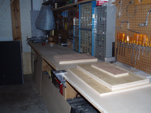

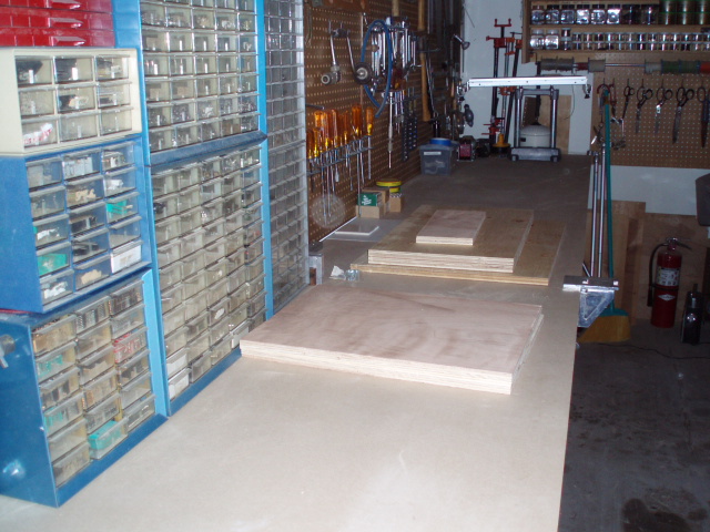

I am in the process of putting a new hardboard top on my workbench. I am seeking advice on what I should use as an edge molding?
This bench gets tortured by hard use,

The bench top was made originally using three solid core doors (very heavy) that are about 1 1/2" thick. This is the work bench in my shop, Tim. It gets used for everything that happens in my shop.

I'm tough on the bench top because I use it a lot and for everything even some occasional automotive or RV repair but I don't think I need an angle iron edge. I haven't made up my mind yet but it'll probably be a hardwood molding.
It has to be soon because the top has already been replaced and the edges are vulnerable.
