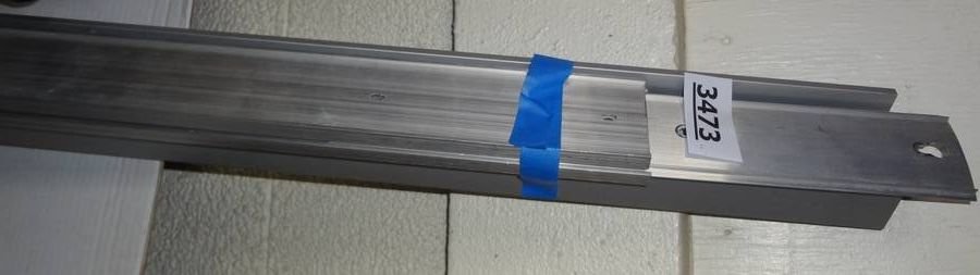

by JPG
A picture would help.
Look like this?
hirsch guide.jpg (31.25 KiB) Viewed 12079 times
Or this thread? viewtopic.php?t=9855

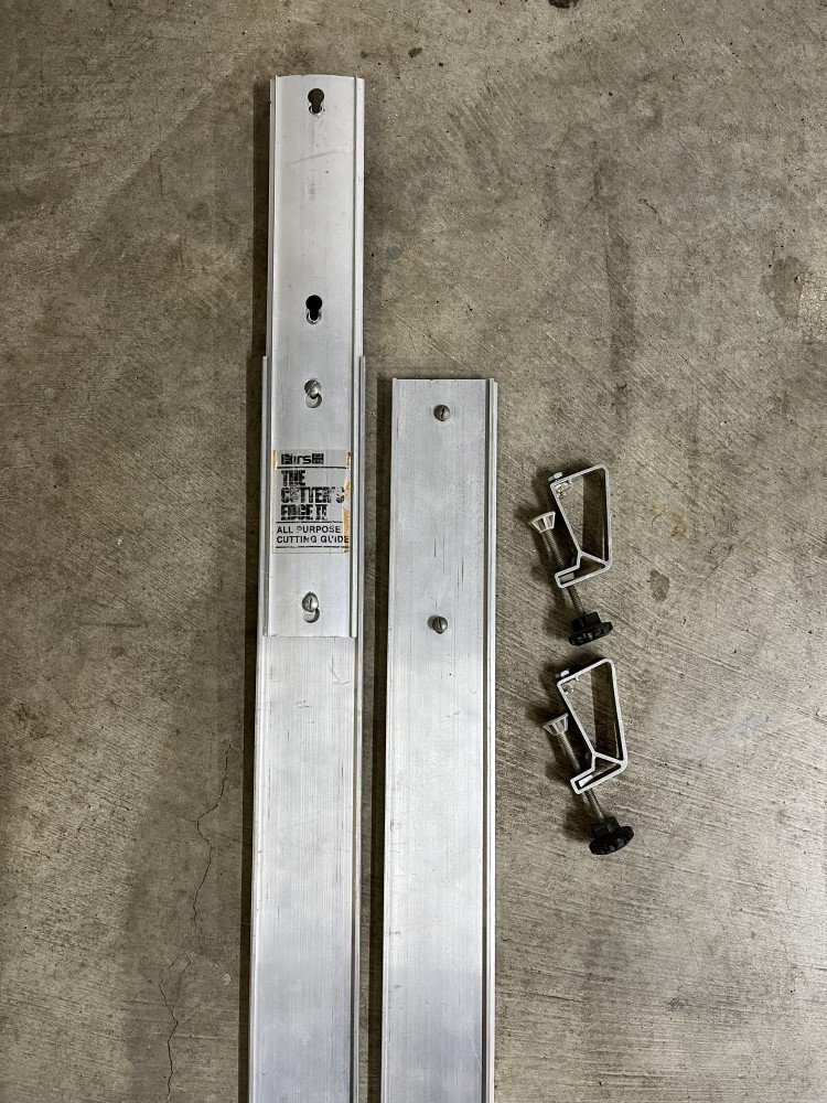

Re: Hirsh - The Cutter's Edge, Will this help me cut straight?
Posted: Fri Feb 17, 2023 11:40 am
by chapmanruss
VideoCat,
If the Cutter's Edge you have looks like the one pictured below it will work fine for cutting straight edges. I have the Hirsh one in the picture and have used it from time to time over the years for cutting sheet goods down to size. The guide sections are 51" long and the coupler piece is 16" long. I don't know where the instructions are for mine but it is rather easy to use. Hopefully you have the clamps (shown in the picture) that come with it. Their bolt heads go into the "T" track on the bottom side. Use one section for up to a 4' cut and both sections for over 4' up to an 8' cut. The circular saw goes against the edge that is flat not the stepped edge. You will need to determine how much you need to add for the distance between the blade and edge of the circular saw base for the correct cutting width for your project. When I have used mine, I clamp the guide to the part I am cutting to width just in case I go astray. It is important that the blade be parallel to the edge of the circular saw base edge that goes against the guide. I had a cheap circular saw that was not aligned between the blade and edge of the base that would cause it to go a little astray. The reason for the warning and that saw is long gone.
Posted: Fri Feb 17, 2023 12:58 pm
by MikeG
Here is the manual that I have for mine. I have used it with great success for breaking down sheet goods.

Russ,
My version looks almost exactly the same as your photo. The handles on the clamps are slightly different so I am not sure of the difference between my version and the II version. I read over the instructions that were uploaded by another member, and they seem very clear. Since I do not need to use the guide now, I will plan on making a test cut in the next few weeks, and review the spacing to the blade. I have an older Craftsman circular saw, and will be looking to buy a new saw in the near future. Thanks for the pointer on keeping the blade parallel.
