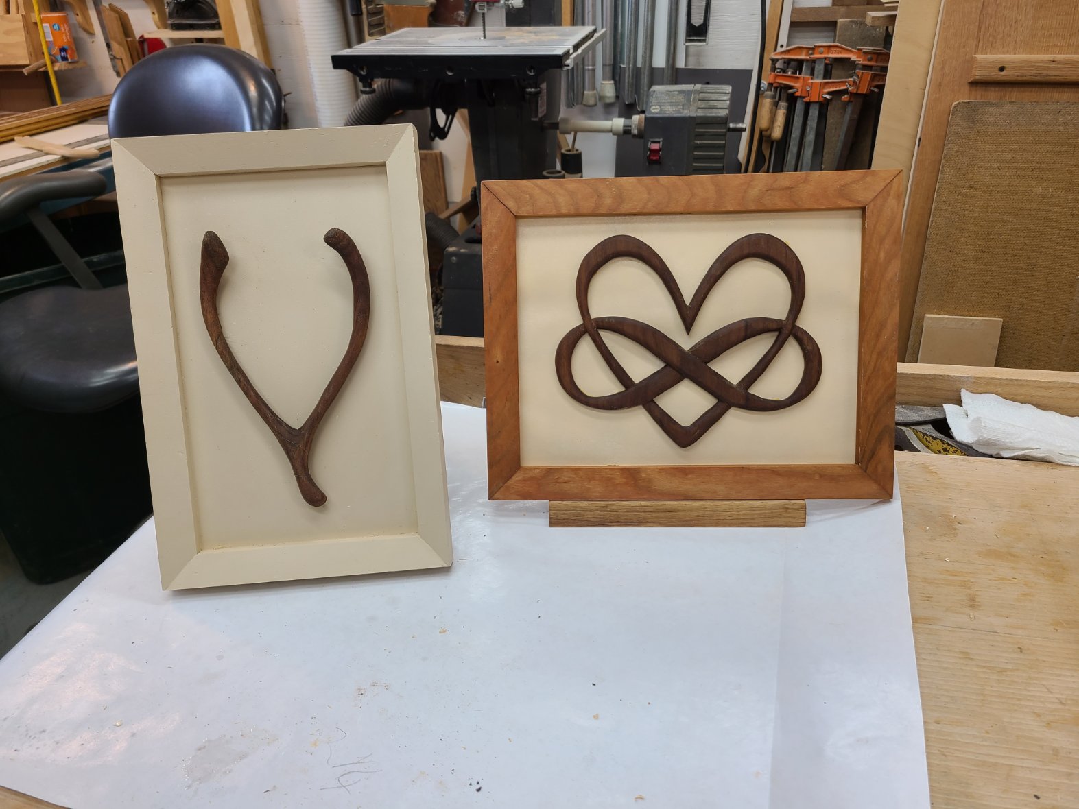

Just for fun of makeing sawdust. (AKA Man Glitter)

The wishbone shape is definitely unique, and very cool. What was your process for making it? I'm guessing that it involved a lot of hand-sculpting & sanding.

I'd like to know more about how you made the one on the right. Did you spot the final form of that wishbone in a tree branch? I'm very impressed by woodworkers who have an eye for that sort of thing.
[/quote]

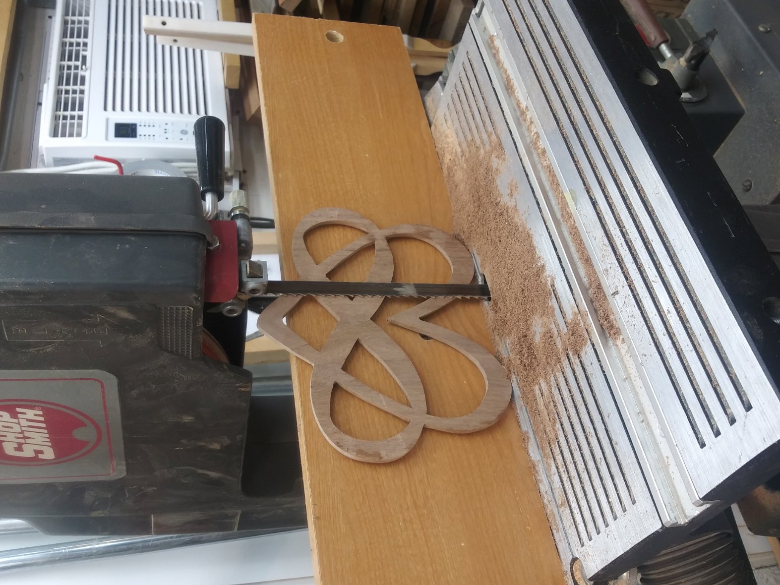

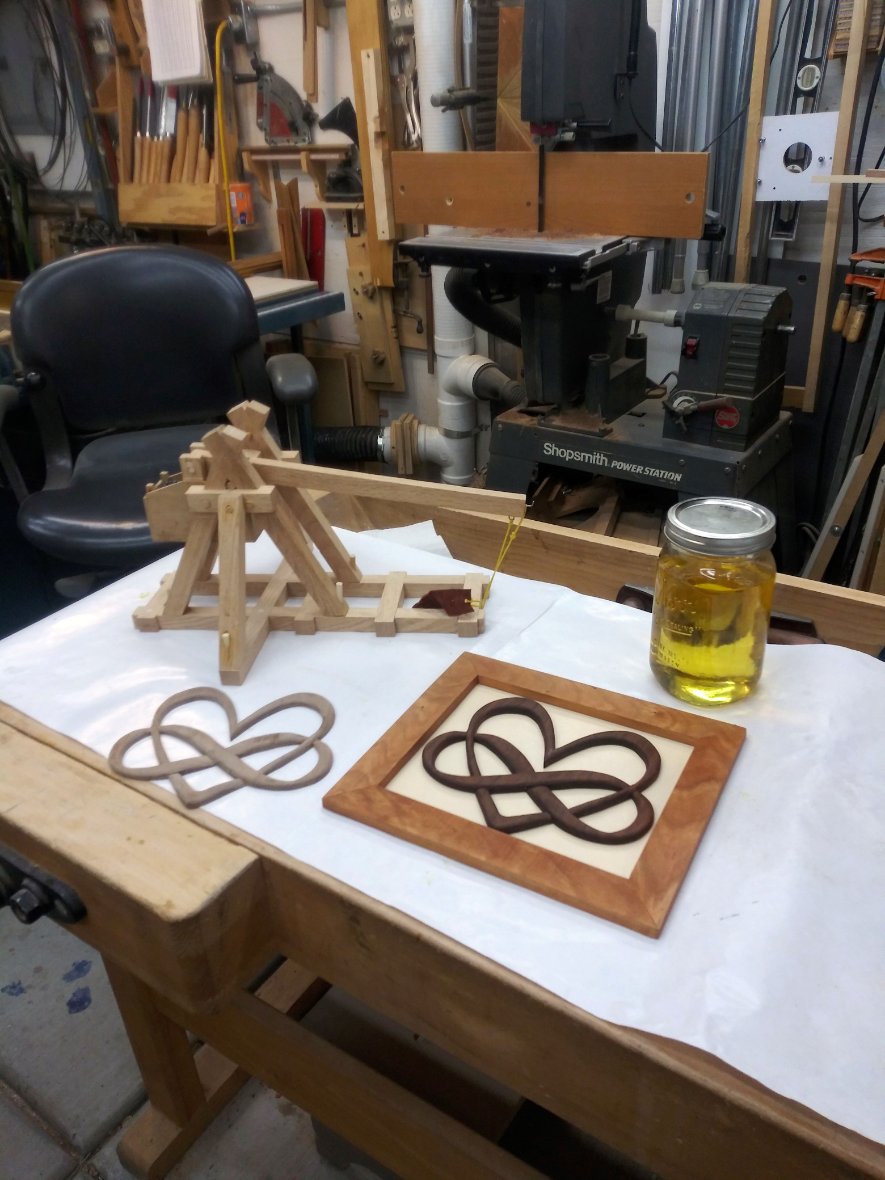

For the infinity heart I started with a 3/4 black walnut after drawing the image the design was cut out on the SS scroll saw and cleaned up with a rasp, utility knife and sandpaper on both sides (to keep clumsy hands from breaking it) then split in two and finished with Swedish linseed oil. I wrapped it up in Valintine wrapping paper and give it to my wife for Valintine day. She asked me why I put a figure eight in the heart.
As for the wishbone there was no artistic flash or incite. A friend was just diagnosed with cancer and her daughter asked me to make her a wishbone. I think I messed up by mounting it I think she wanted her mother to use it like a comfort Angle.
After drawing the pattern on a 3/4 black walnut board the image was cut on the band saw and freehand scrupled using the SS belt sander, spindle sander and cleaned up with a rap.
PS I was asked to make a trebuchet for a 8-year-old birthday.
