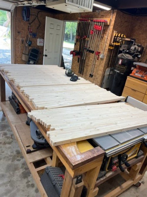

I have an idea about storage for my ShopSmith related items. (Which are currently neatly but disorganizedly strewn about the shop.)
I'm not sure if this is an excellent idea or sheer madness.
I have started on a giant lazy susan cabinet. It would be about waist level in height, and no more than 44" wide. The top and bottom wheels will be made of construction grade lumber (I believe it is fir, but not sure. Ace Hardware calls it "white wood") in a butcher block style glue-up.
I suppose when it is finished, it will resemble a large spool for heavy duty cable.
So far I have milled 90 pieces of lumber 46"x 1 1/4" x 1".
The top wheel will house my bandsaw and jointer, as well as often reached for items like the rip fence, etc. It should have room to grow. The bottom wheel will have pull out trays, roughly shaped like slices of pizza. This will hold lesser reached for items. The slide out trays will probably be 3/4 ply or another butcher block glue-up.
I have not sourced the hardware for the lazy susan part but this should not be hard.
This will be a HUGE project for me, and will likely take a few months. I used my conical sanding disc for the first time on this project.

Posted: Wed Jun 21, 2023 12:39 pm
by chapmanruss
tfrayne,
Interesting idea. I look forward to seeing how it turns out.
Your picture rotated for clarity.
_
Lazy Susan 01 tfrayne.jpg (78.71 KiB) Viewed 61703 times

Thankyou. I need to remember to take horizontal photos...
This will be a slow project but I will update as I go. RIght now I am fighting time with my initial glue-up. I want to get 18 sections of 5 pieces each before the wood starts to bow.
Just found the SS biscuit joiner in a box, complete with original packing, instructions and a small supply of biscuits. I was going to dowel the sections together but I think I will try this thing out.

I ordered the hardware; an aluminum piece 36" in diameter and rated for 850 lb. I have some ideas on how to mount it but I guess I'll have to wait until it arrives so I can really see how it works.
In the meantime, I glued up all my sections (90 of them) into groups of 5 and now have 18 sections of 5 pieces each. I milled those down to a common size and am now using my ShopSmith biscuit joiner for the first time. Literally had to take it out the box its been in for twenty years and read the instructions.
The pieces are big enough to feed into the cutter without ever getting my fingers too close to anything that moves. I used my outfeed fixture (Thanks Scott M!) just to provide more support. Since it attaches to the rip fence, I needed the rip fence to hold the fixture. Otherwise I don't think the rip fence would have been necessary for this operation.
I'll do the glue up in sections as it is very hot in TX, I don't have air conditioning in the shop, I need to take frequent hydration brakes and the glue sets up fast.
Hopefully I will have two (roughly) square pieces by the end of the weekend.
