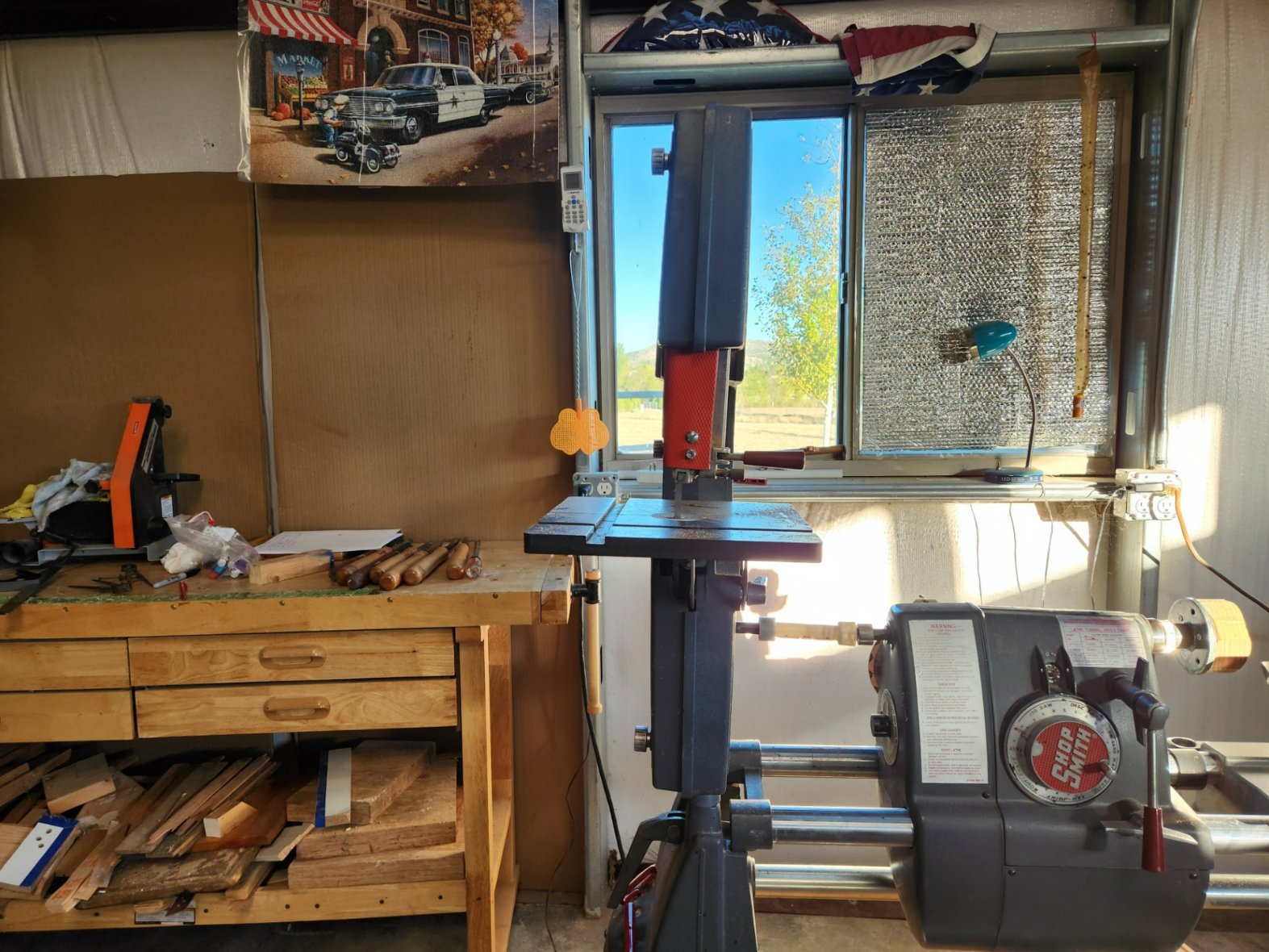

I mounted the bandsaw and it tilts to the right. I don't see and adjustment for tilting it. You guys are very helpful, thanks in advance.

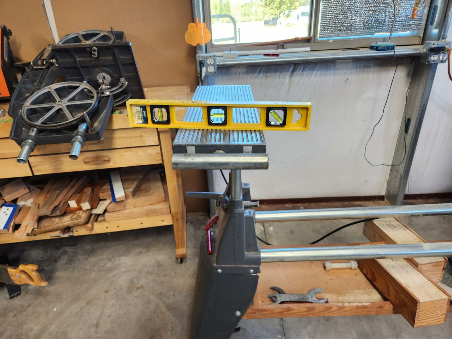

You might test that the Headrest is properly installed on the bench (lower) tubes. You can install the extension table in the Headrest mounts and see if the extension table tubes are square to the bench tubes. An angle block or cube (Wixey or similar) or a short square with a plumb vial would be helpful, but this is probably far enough off to eyeball it. My thinking here is to isolate between the bandsaw and everything else by taking the BS out of the equation.

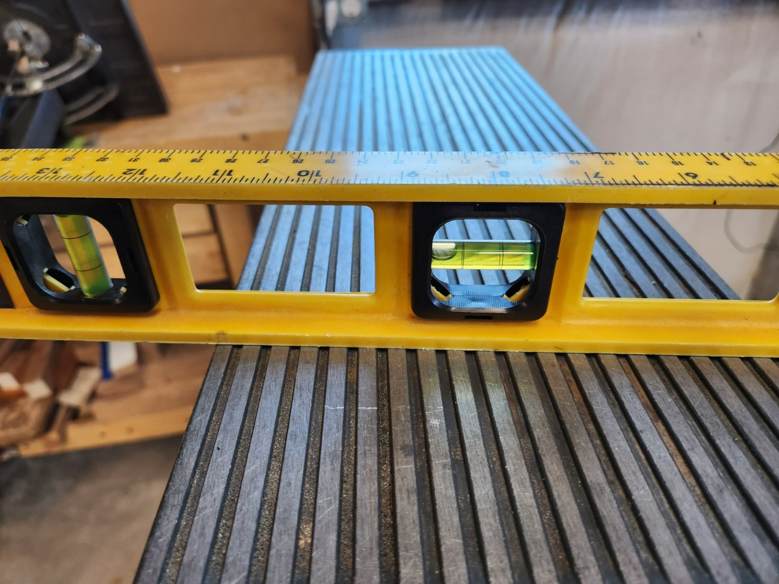

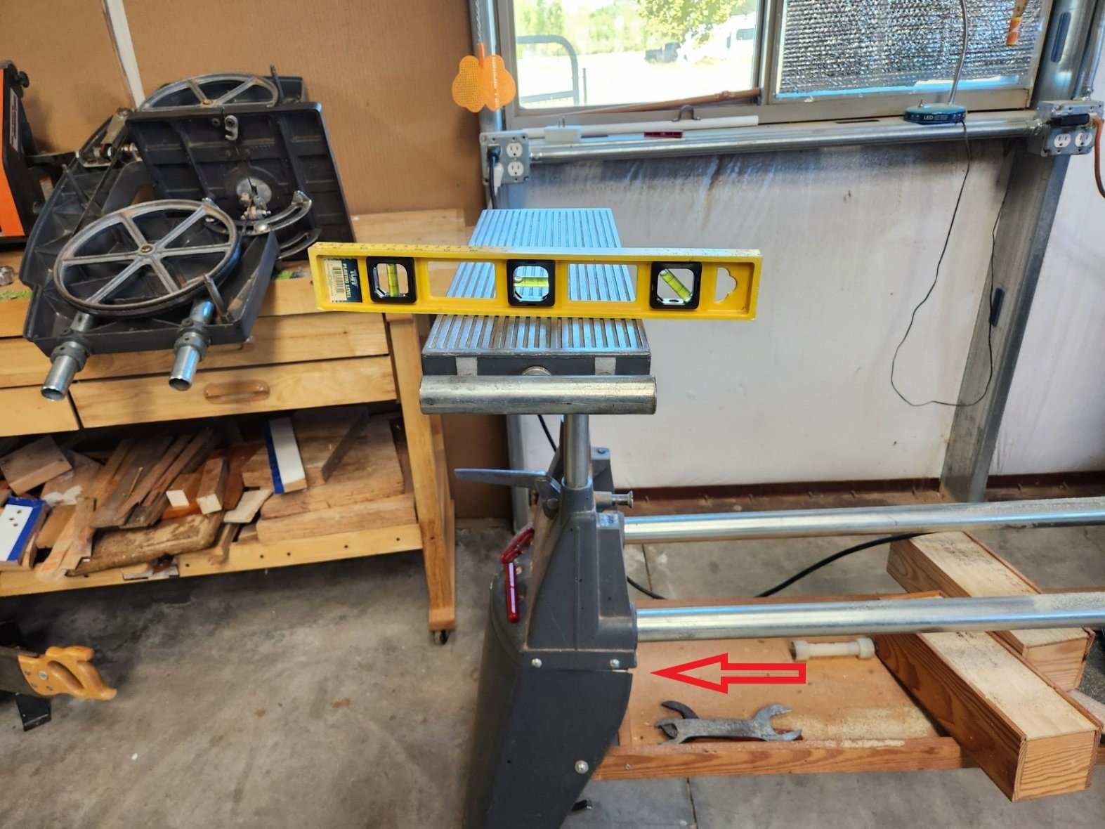

OIK, great idea, I did just what you said with an extension table. I put a level on it and on the garage floor. The floor is level but the extension table is way off. I also checked the extension table with the upper bars in the lathe position and drill press position. It wasn't level in either position. I read that there is supposed to be set screws holding the lower bars on, mine doesn't have set screws, it has two bolds and a bar. What do I do now?
Re: bandsaw tilts to the right.
Re bandsaw tubes: they must be tight at both the bottom where the tubes enter the BS AND at the upper end where they go into a hole.
Re bench tubes: They must lay flat against the casting. There may be a ridge that serves as a stop that the tubes may be resting on top of.

Posts: 4538

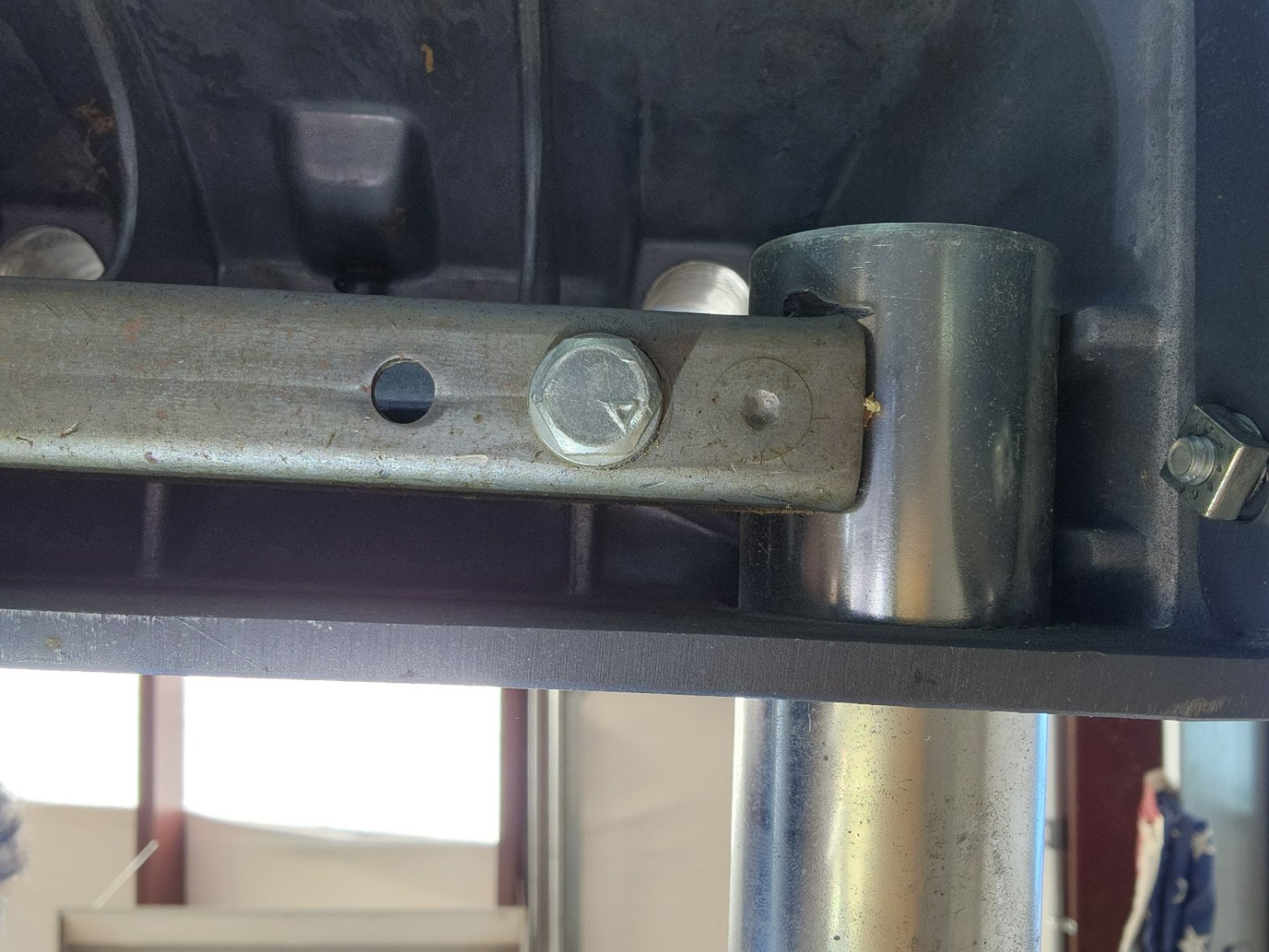

Set screws hold the Way Tubes in place. Your picture of the bolts and bar to hold the Bench Tubes is correct and has been that way for all Mark 5/V's since their introduction.
In your picture above and shown below I noticed the legs are not completely aligned to the Headrest with a gap as indicated by the arrow.
PAULSCOOTER Mark V 510 - arrow.jpg (279.37 KiB) Viewed 9220 times
It may require removing the storage shelf to correct this.

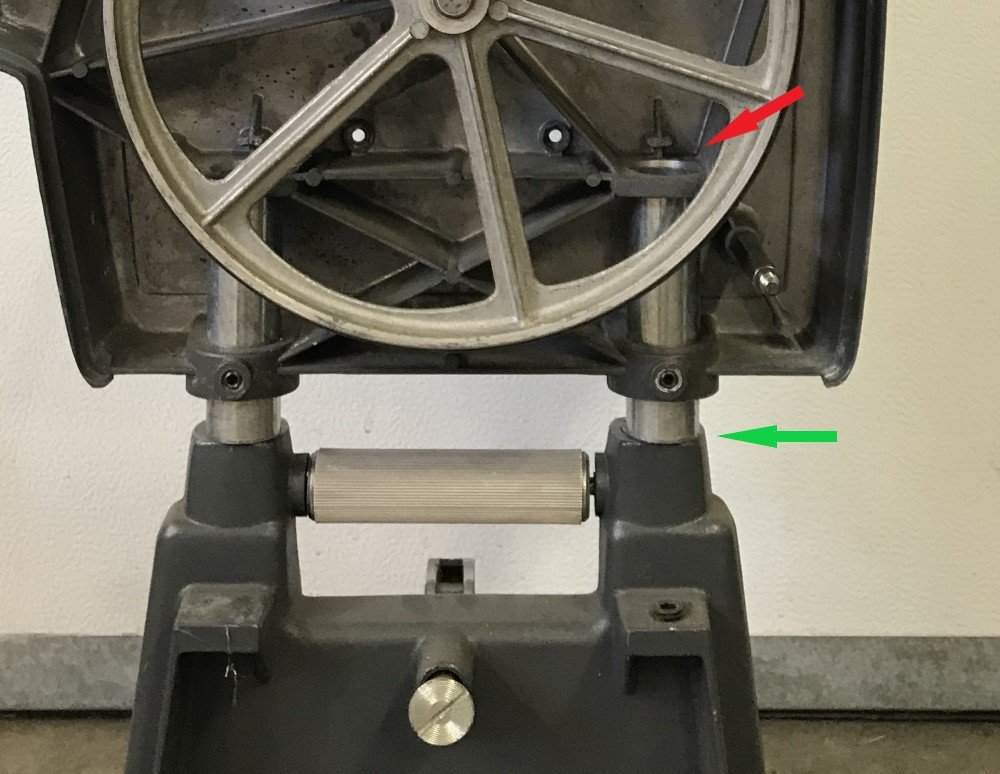

There has been a lot of discussion about the Eccentric Mounting Posts used for the Bandsaw and how they are a bit short going into the Bandsaw Main Frame. The picture below shows a properly aligned, to my Mark V 520, Bandsaw mounted on a Headrest. For those of you who have noticed it the lock is not tightened and therefore not centered. The green arrow shows the Eccentric Mounting Post offset resting on the Headrest. The red arrow shows where the top of the Mounting Post doesn't quite go all the way through the top hole in the Bandsaw Main Frame casting. It is short of touching the stop above the upper hole. I mention this for those reading this thread looking for similar help.

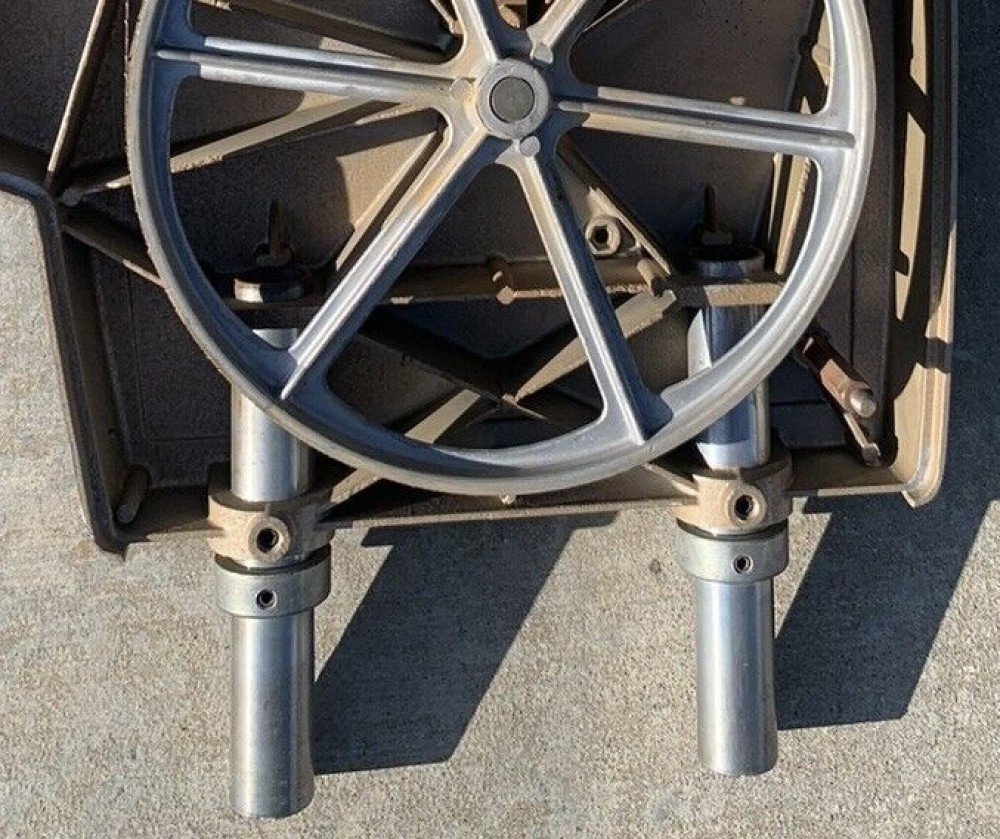

If you read the information in the link Ed provided than you know the Bandsaw originally had straight Mounting Posts with adjustable Collars like yours. The picture below shows a Goldie Bandsaw with straight Mounting Posts. In this picture the Posts are not set all the way up to the stop. That stop was for the straight Mounting Posts to go up to in the Bandsaw Main Frame. The Collars were used to "set" the resting position of the Bandsaw in the Headrest Mounting Holes when the shafts (Bandsaw and Headstock Drive Shafts) are aligned. The Bandsaw Main Frame casting itself is the same today as it was when the Bandsaw was introduced in the 1950's. I have a Greenie Bandsaw with its original straight Mounting Posts and had no trouble aligning it to my Mark 7. Straight Mounting Posts have less adjustment available to align the hub to the Headstock than the Eccentric Mounting Posts. For some reason on yours the Bandsaw drive shaft does not seem to be in straight alignment with the Headstocks Drive Sleeve. It is possible your Headrest is not set evenly on the Bench Tubes.
_
Straight Mounting Posts.jpg (221.91 KiB) Viewed 9214 times
Although not as likely as other alignment issues the Main Frame casting could be bent slightly at the Mounting Post holes causing some tilt. If this is part of the problem the solution would be getting a replacement Main Frame. If needed, you would want an early Main Frame Assembly from a Bandsaw with the Cast Iron Table. There is a difference between the Main Frame Assembly for the Cast Iron Table having pressed in bushings for the table mount and the Aluminum Table which has slip in bushings for the table mount.
