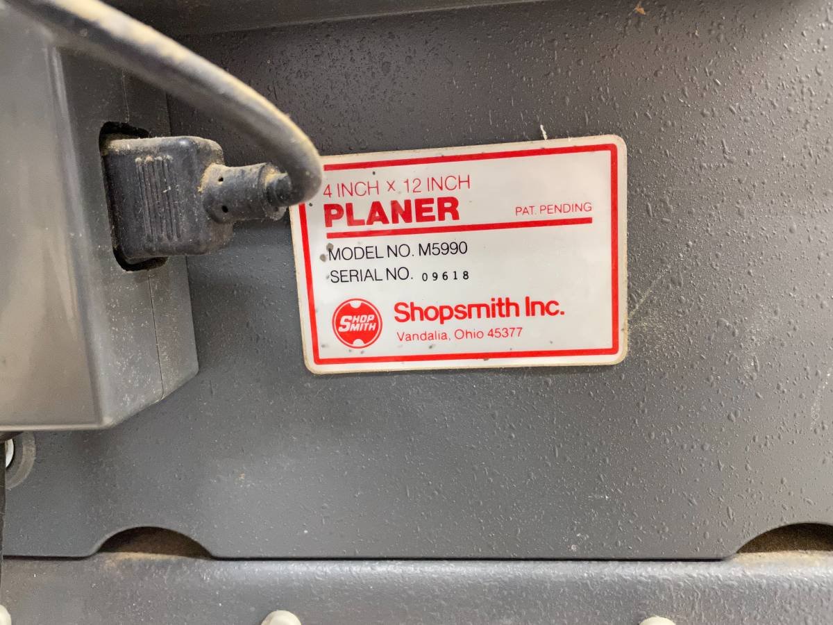

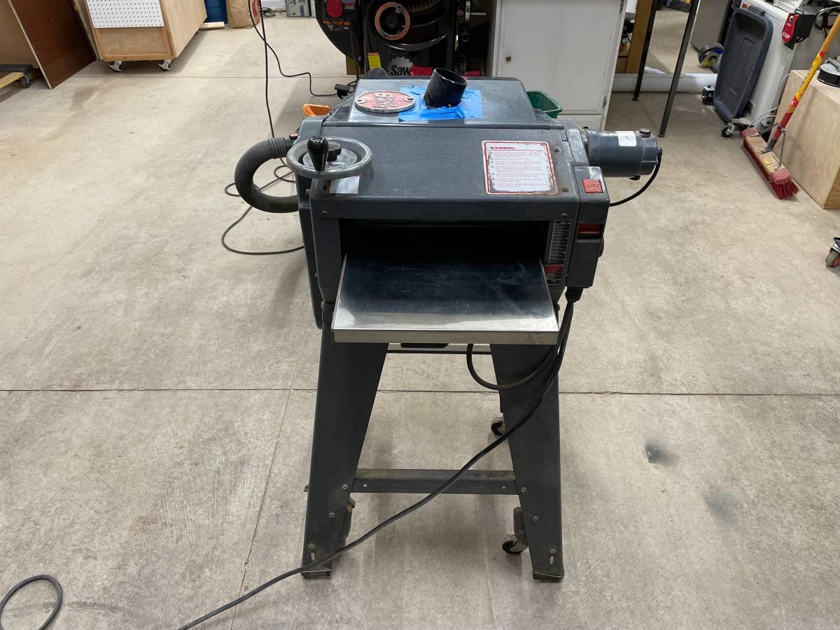

I believe you are correct. The reason I covered the differences is changes can be made to them. Your Model M5990 is a good example originally having a feed motor but converted to a manual feed due to the missing feed motor. Below is a M5990 Planer.
_
M5990 ser 09618 unit.jpg (163.95 KiB) Viewed 10291 times
Below is the Model/Serial Number sticker on it.
_
M5990 ser 09618.jpg (163.47 KiB) Viewed 10291 times
It is an earlier Planer having the round table height adjustment handle but looks like a Pro Planer since it is mounted on its own stand. Based on the Model and Serial Number I believe it started out as a Mark Mount Planer from September 1983 and was converted. Pro Planer serial numbers didn't go that high prior to the change to date codes. I'm not sure when the table height adjustment handle changed. Changes are a good reason to know the differences between the Mark Mount and the Pro Planer. This, like other reasons given, can affect the value of a tool for sale.

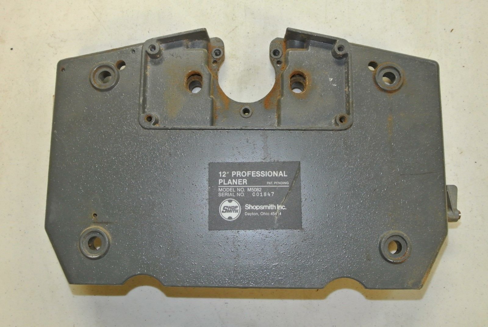

As for the Pro Planer model numbers below is an early end panel from December 1985, the first year of the Pro Planer showing Model M5082.
_
M5082 ser 001847 Dec 85 End Frame - right - ProPlaner.jpg (302.23 KiB) Viewed 10291 times
Carp,
If you would like to post pictures of you dad's Mark V and Planer including any accessories, we would be happy to help identify what you have. Sorry I neglected to mention the Mark V value. It can be more complicated than the Planer is with many more variables than the Planer has. Pictures will help narrow down those variables a lot.
